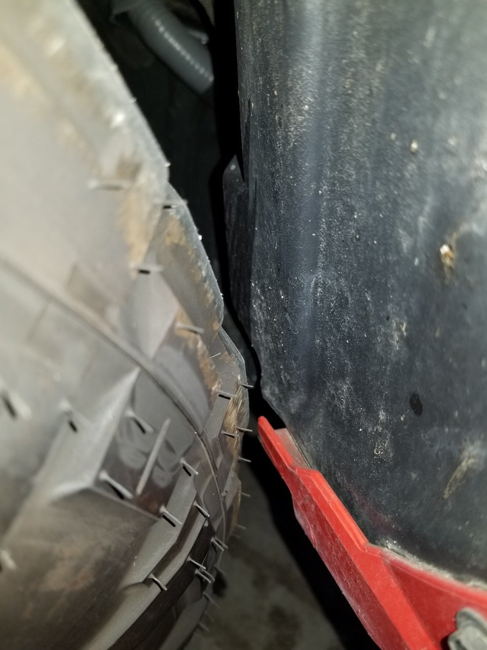

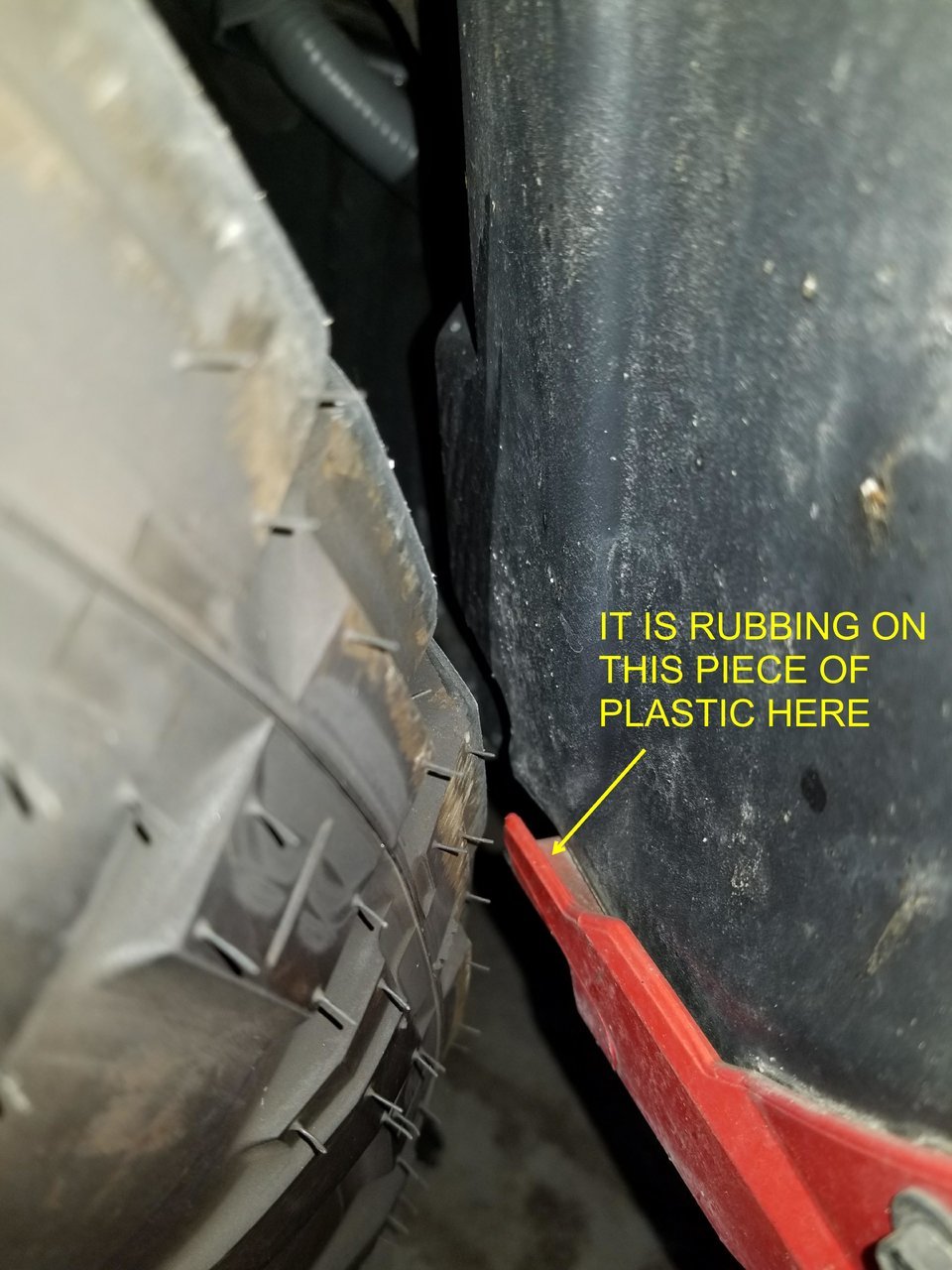

    Thanks! Minor minor rub at half to full turn on drivers side mud flap. Removed but still rubs here:
    But 30 seconds with a metal hack saw blade and you could eliminate it. This plastic serves no purpose. If you wheel however the rub might be more annoying even without it. My truck's too new to wheel still so not an issue for me.

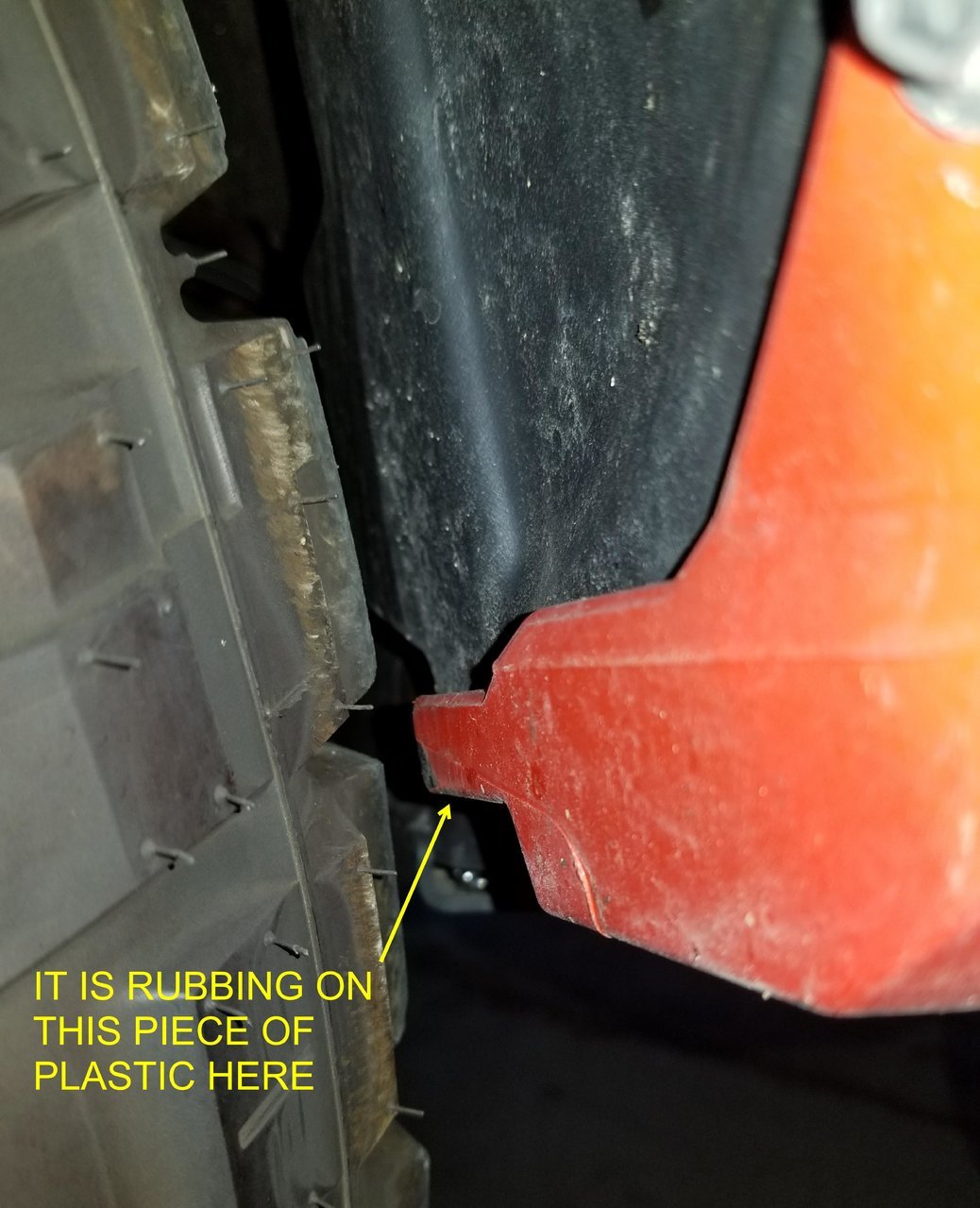

    Here's another pic of the offending piece.

    You're welcome, just wanted to point out how little rub there actually is. Here are the same photos with some text so this it is crystal clear (I didn't have access to these photos last night). You can see how the tire has added some black marks in the second photo but again, not enough to lose any sleep over. Oh, and those marks on the tire are not from this rubbing. That is from a curb I got too close to.

    You check your wheel alignment, hows your caster. I have a similar setup and with caster around 2 it doesn't rub anymore.

    No, neither, and other than this little rub when i turn and go over a bump, the tires are wearing perfectly and I get no vibrations at any speed. Except for now that it's gotten colder there is a little thumpity thump for the first 2 or 3 miles. I wonder what shop would charge for those changes......and by wheel alignment I assume you mean the standard front end alignment?

    I went in to Toyota and told them I wanted 2 or as close to 2 for caster and the tech did it. Took close to an hour, normally they just look to see if your with the acceptable range, that alignment is quicker.
    It will move your wheel ahead just a bit.
