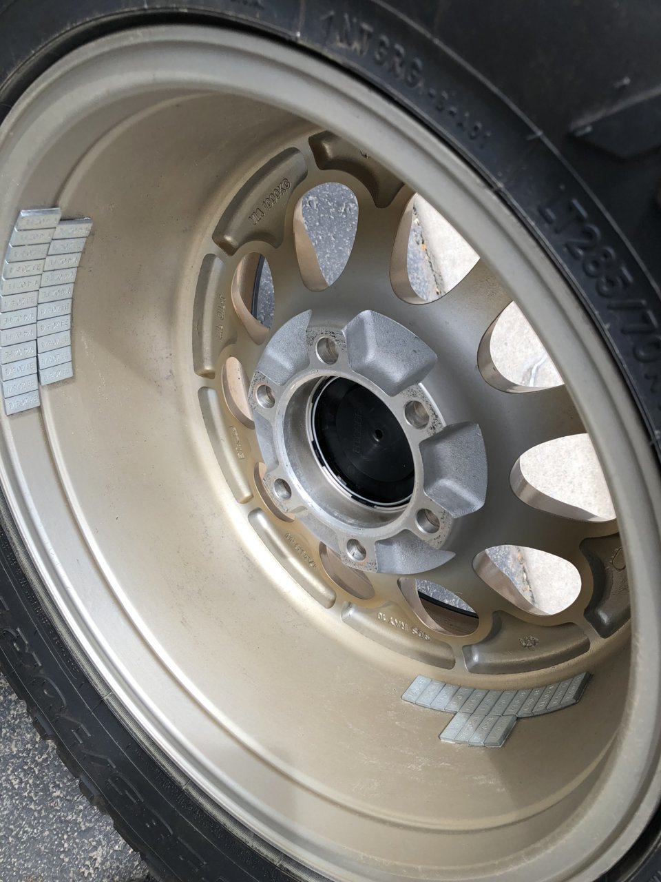

    Does this look normal? I think there’s too many weights

    I have a fuck ton on mine. More so on one than the others. And still a vibe, that I haven't had a chance to go back and see if they can iron out.. I believe its the tires tho.

    That is pretty excessive

    Seems excessive for SCS. Likely the tires.

    You guys with all those weights it is probably because the heaviest part of the tire isn’t mounted in the correct spot. Should be close to the valve stem. Most tires come woth a yellow or red dot on the sidewall to help guide the installer.

    I think you've got a bad tire.

    Idk.. Probly. Discount tire didnt say anything about it. But I purchased them on eBay. Centennial dirt commanders. Have heard that others have had balancing issues with these as well. Oh well. Not too bad. Ill live with it for the money i saved. Theyre freaking awesome tires otherwise!

    98% of the time, when there's a ton of weight needed to balance the wheel and tire, it's usually the tire that causes the issue. This can happen with brand new tires. Sometimes, the way they are stored or shipped can cause the tire to slightly get out of shape/deform which makes it tougher to balance. Generally, if a tire tech sees this, they should dismount and rotate the tires 180* to better match the balance with the wheel.
    If a wheel is ever suspected of being out of round, have the tire tech spin balance just the wheel alone. If it's bad, you can tell right away. Whenever possible, try to get them road force balance. It costs a little more, but it will help to get the best possible balancing job.

    I carried in a set of ko2s and they were very quick to let me know one was out of round. They just so happened to have one in stock to be able to get me out the door LOL. I got the other one exchanged and have a full size spare!

    Yeah I still need to get me a matching spare to slap on my spare scs i got. So I'll just swap the tires out and hope that the new one is better, and the current one will be my spare.. Because I highly doubt the seller i bought my tires from will do anything about it. Probly too late now even if so.

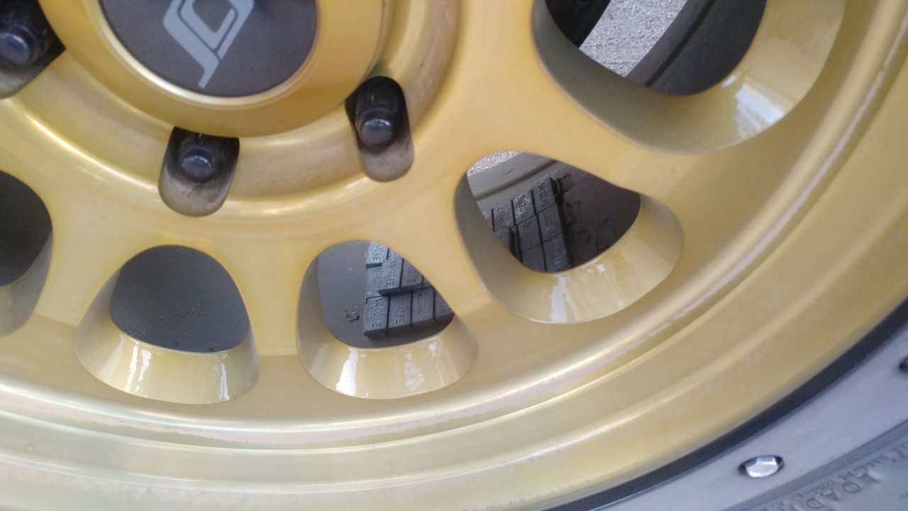

    Current Mods: - Locking Lug Nuts - Weather Tech floor Liners - N-Fab light bar - 32” Led Light bar - TRD skid plate - Leer Cap (Pyrite Mica) - Rigid TSM-22 Tow Strap Shackle Mount - Rigid Orange Shackle - @ACEkraut License plate bracket - Flashwolves LED reverse bulbs - TRD Stainless Cat Back - AFE Pro Dry S drop in filter - Glove box organizer - Center Console organizer - Bed Stiffeners - Color match grille - Custom Car Grills Perf SS Mesh flat black - Thule Cap roof rails - TRD PRO Suspension - Wheelers 2" Add a Leaf - HS 1/4 inch strut spacers - SCS Ray 10's in Brushed Copper - Cooper Maxx St's 275's - Under hood Led Light Kit Future Mods (as of right now): - 20inch LED Bar (Caliraised,Rigid, Baja) - 32inch LED Bar (Caliraised,Rigid,Baja) - LED Pods Side Projecting (Caliraised, Rigid) - Toyota Bed Matt - Quick fist Axe and Shovel mounts in Truck Bed - Cap mounted Awning - 100% No Drill Bolt on sliders - Wet Oak Seat covers (All black with TRD in them) - VooDoo Bed Bars/Basket that works under a cap
    New Wheels on !!!! Really happy how it turned out first Pyrite Mica I could find with Brushed Cooper Ray 10's
