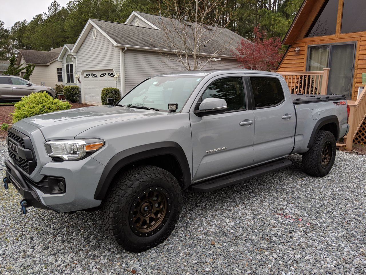

    Love my wheels,might need to get an extra one as a spare soon.

    What size tire?

    265/70/17 ko2 stock height

    You have to do anything for rubbing?

    Just take off the mud flaps and you're fine.

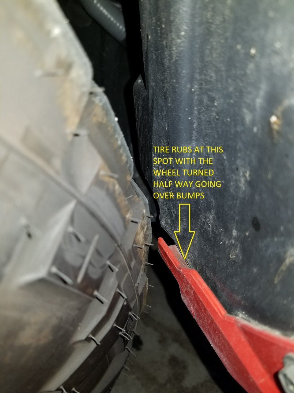

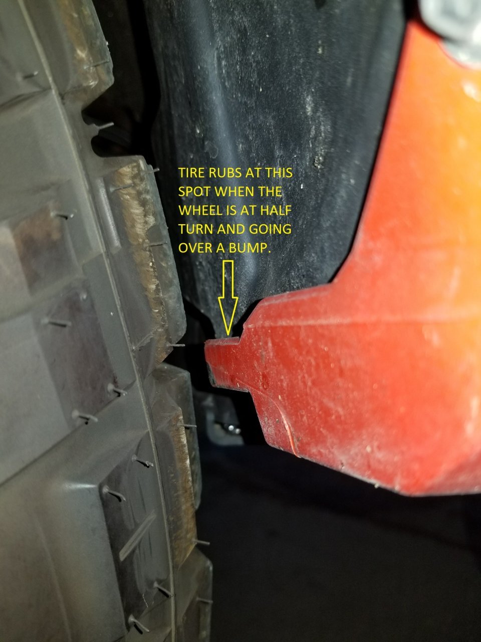

    I removed my mud flaps but still have some rub on one side. The "plastic" we are talking about is shown here:
    Here's an excellent video by our very own @Rob Daman where he eliminates the plastic. I just haven't done it yet.
    https://www.youtube.com/watch?v=p1zDYOGCwnk
    And if this doesn't do it for you, his Part 2 video is a must see.
    https://youtu.be/HPgfjqOe6y8

    Thanks big time! That clears up a LOT, I'll have to go pop out to my truck and see this plastic. Thanks for the video links explaining the process! I feel better now about possibly just buying them and dealing with any rub as it comes.
