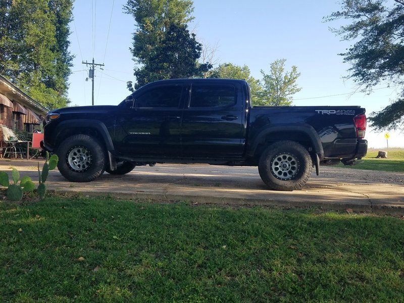

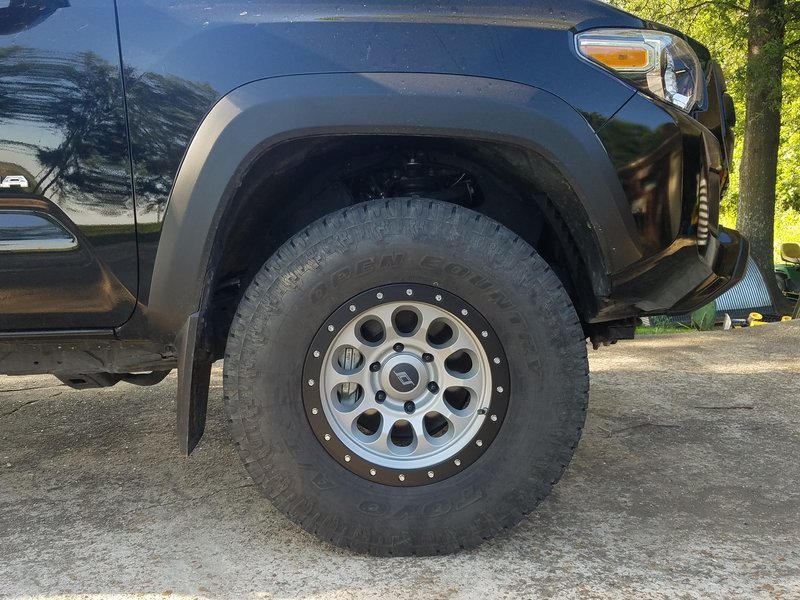

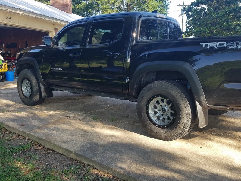

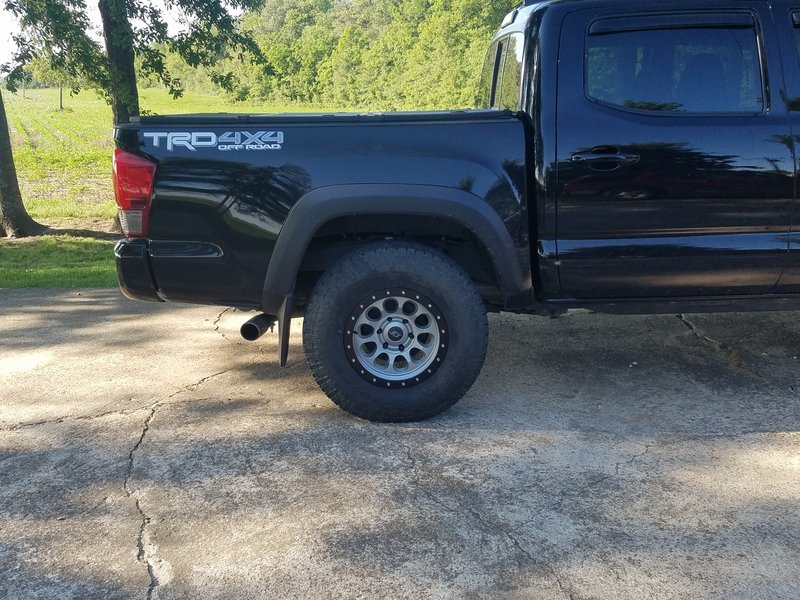

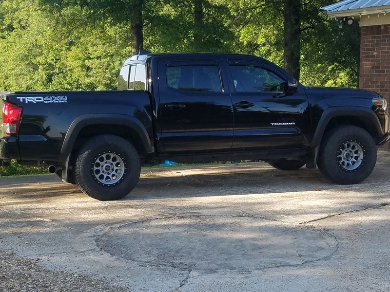

    16in matte gray on 265/75/16 toyo open country AT2's. Stock suspension. Had to lose the front mudflaps for street driving. Took it Off road a bit, and a corner of the fender flare will have to be massaged a little for full stuff, but not bad at all. I like them alot. The offset is perfect for the turd gen.
