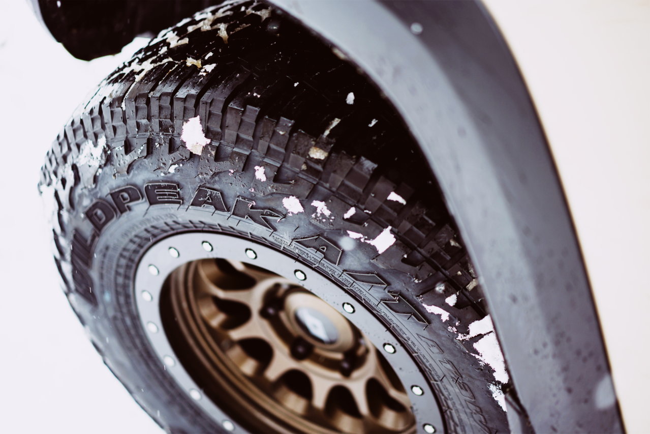

    You will barely rub at 3/4 turn over a curb. More people in the car, more easily it will rub at turn. If you remove the front mud flaps this should resolve it all unless your super flexed and 3/4+ turned.
    I was in the trails today, nothing crazy but just to test out the rubbing on something other than pavement...did fine. Ray 10's/Wildpeak 265-75-16 OR DCSB 2018.
