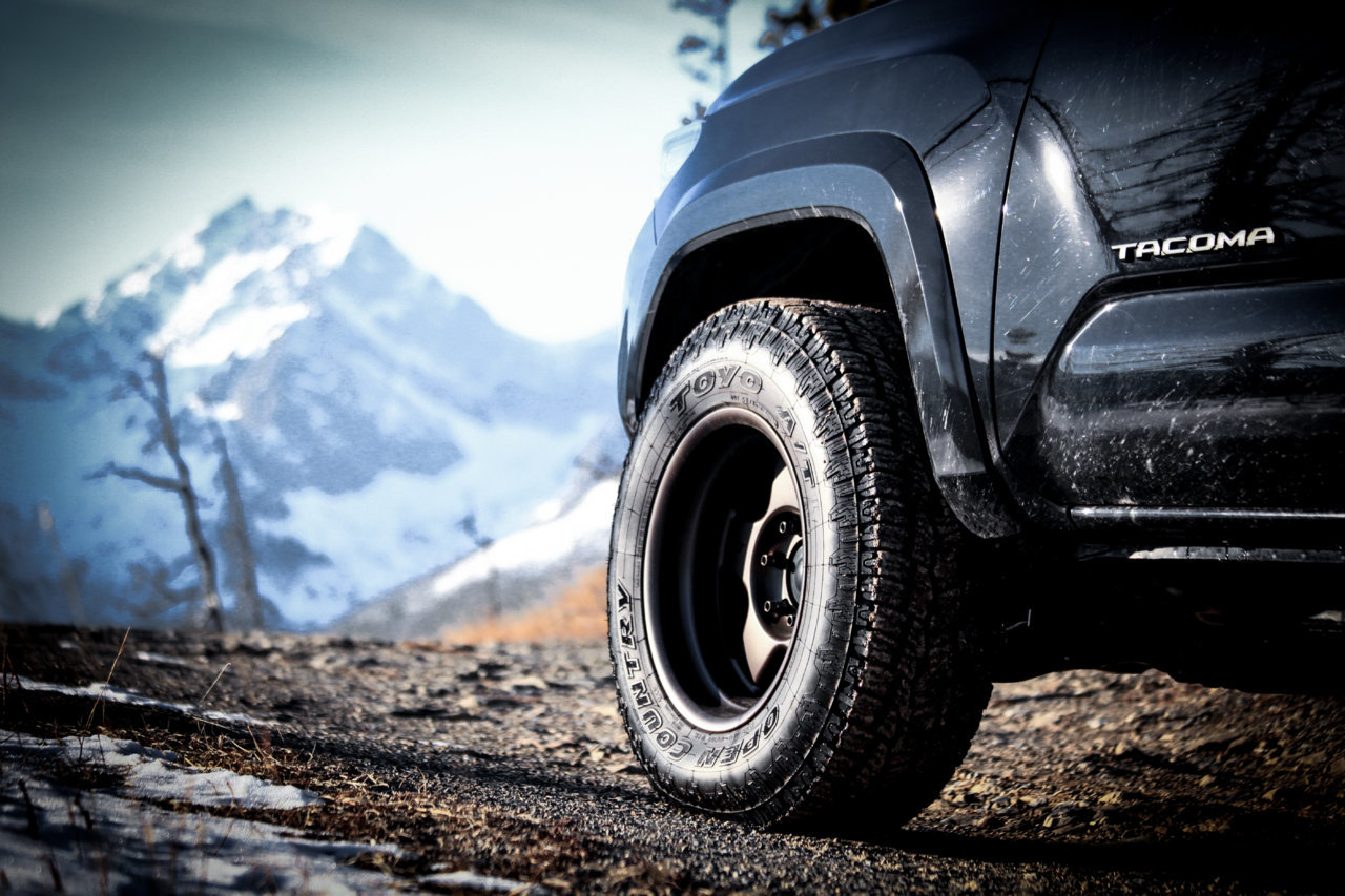

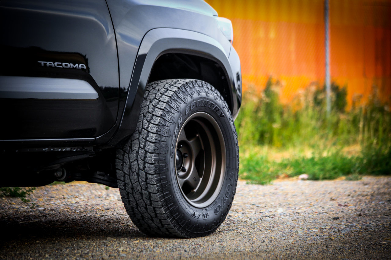

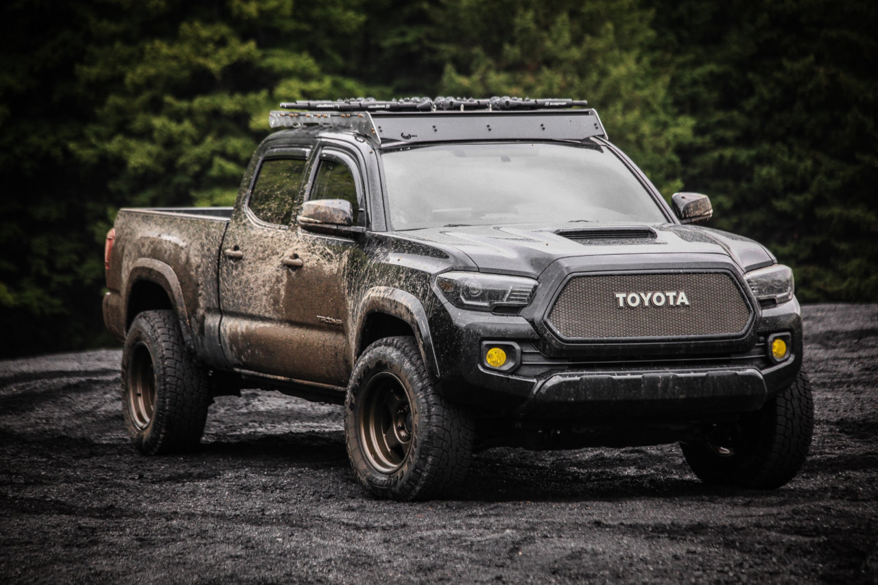

  6. Jun 11, 2018 at 11:35 AM
    LEXICON
    LEXICON born where the prairies meet the rockies
    Dec 8, 2015
    #171728
    2,197
    Courtney
    Canada
    2016DCLBBLACKTACOMATRDSPORT4X4PREMIUM
    Nothing worthy
    No rub after much :sawzall:
