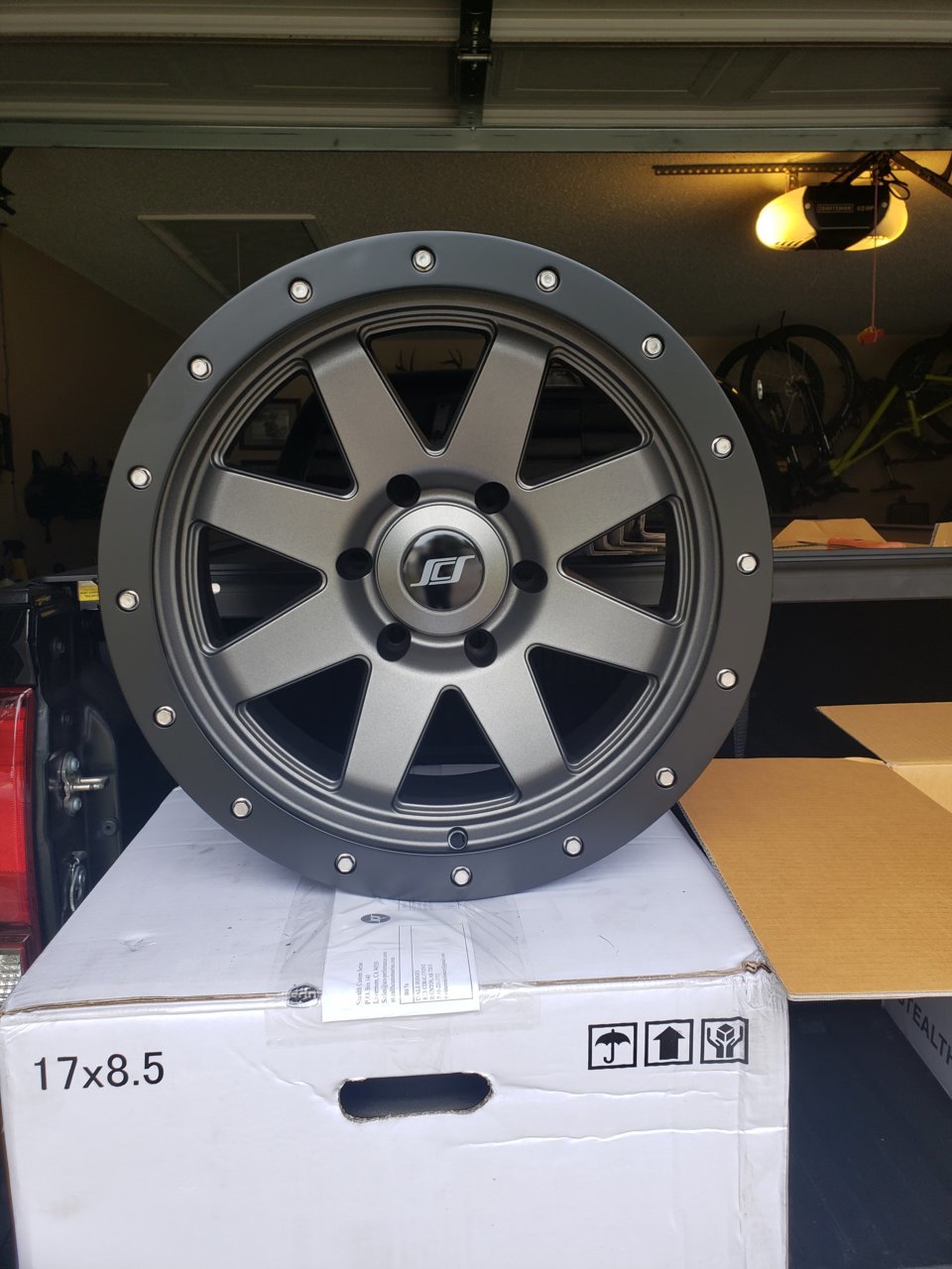

    I'm about to fianally post some pics on this page soon, thank you all for the inspiration and guidance. These just came in today, it's an early Christmas for me and tires should go on tomorrow.20190806_172929.jpg

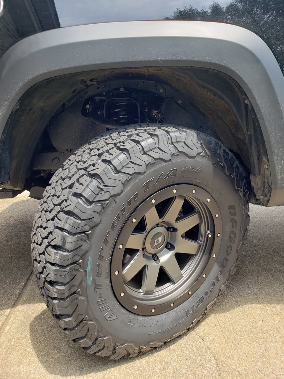

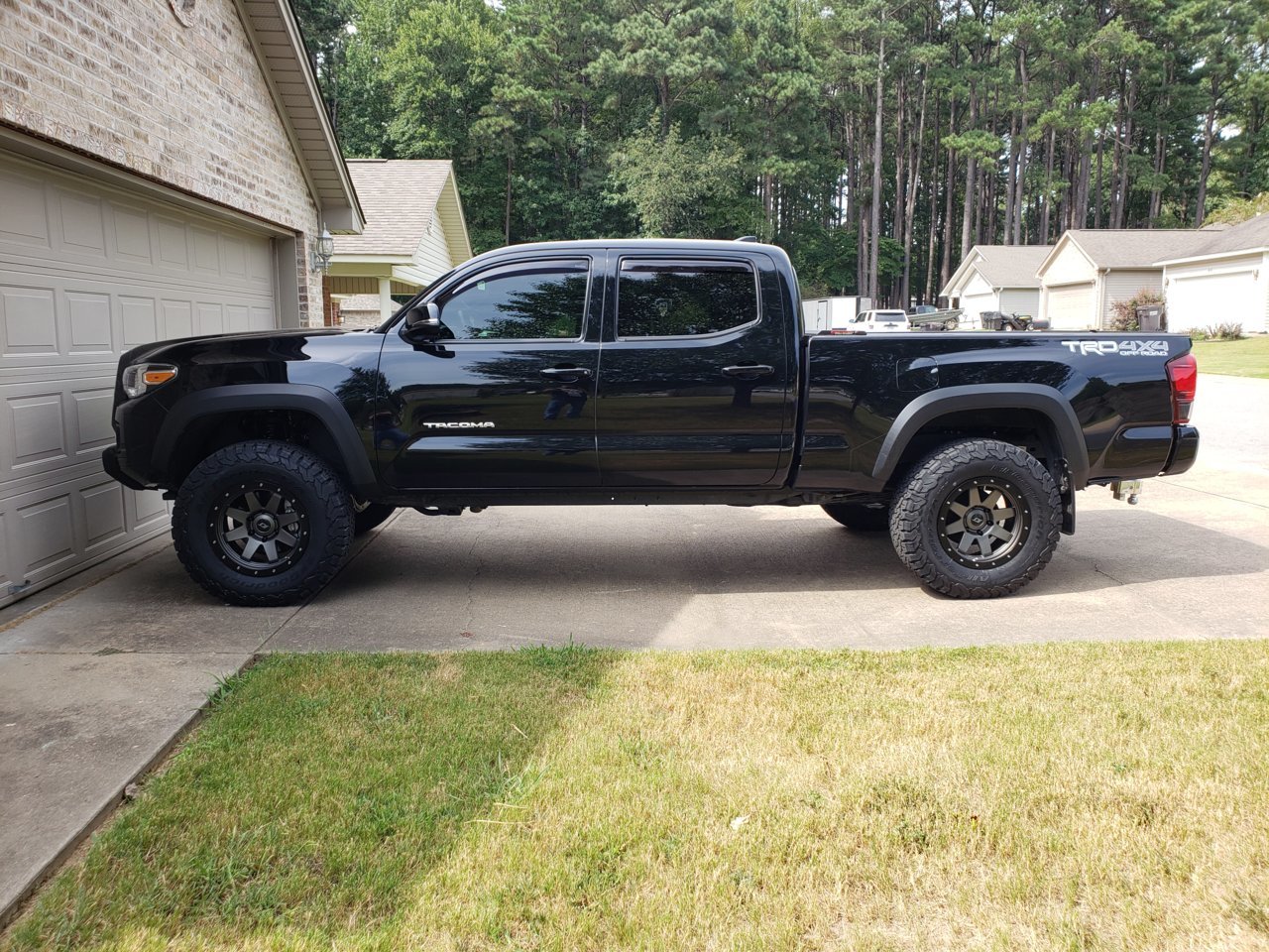

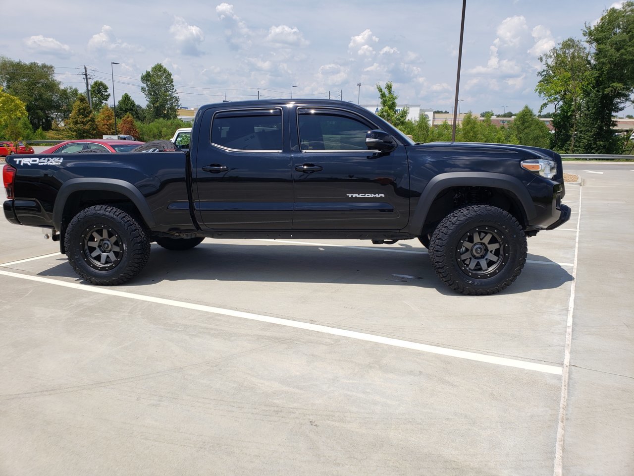

    Here are a few pics of my 2018 dclb with bilstein 5100 on ome 888 coils up front and 1.5 inch block with 5100 shocks in the back. Tires are BFG at2 285/70-17 load rang C, allegedly 51lb from discount tire. I did remove the front mud flaps before hand after reading most had to. I really like my early Christmas present and thanks to Marie at HS offroad and Vin with SCS. 20190807_134755.jpg 20190807_154626.jpg 20190807_134740.jpg

    Nice looking truck. Any rubbing?

    Thanks Joe671. Only slight rub was on the very bottom plastic at the rear of the passenger side front wheel well. Trimmed it with a utility knife....maybe an inch. I haven't used a heat gun or anything yet. I should know more after going to our farm in north AR this weekend.
    I know some people don't want to cut or mod much on a new truck...and that's everyone's own choice.....however, I've always like to measure none and cut once if it keeps things from rubbing under full flex offroad. I'm not opposed to doing my own cmc and pinch weld, and may have to. I'll post back later with any rubbing updates.

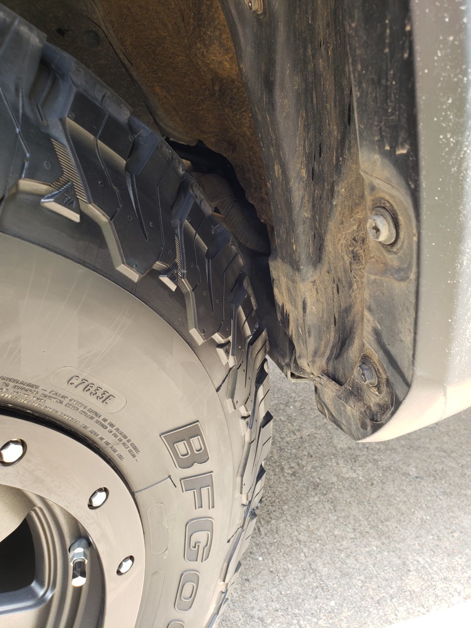

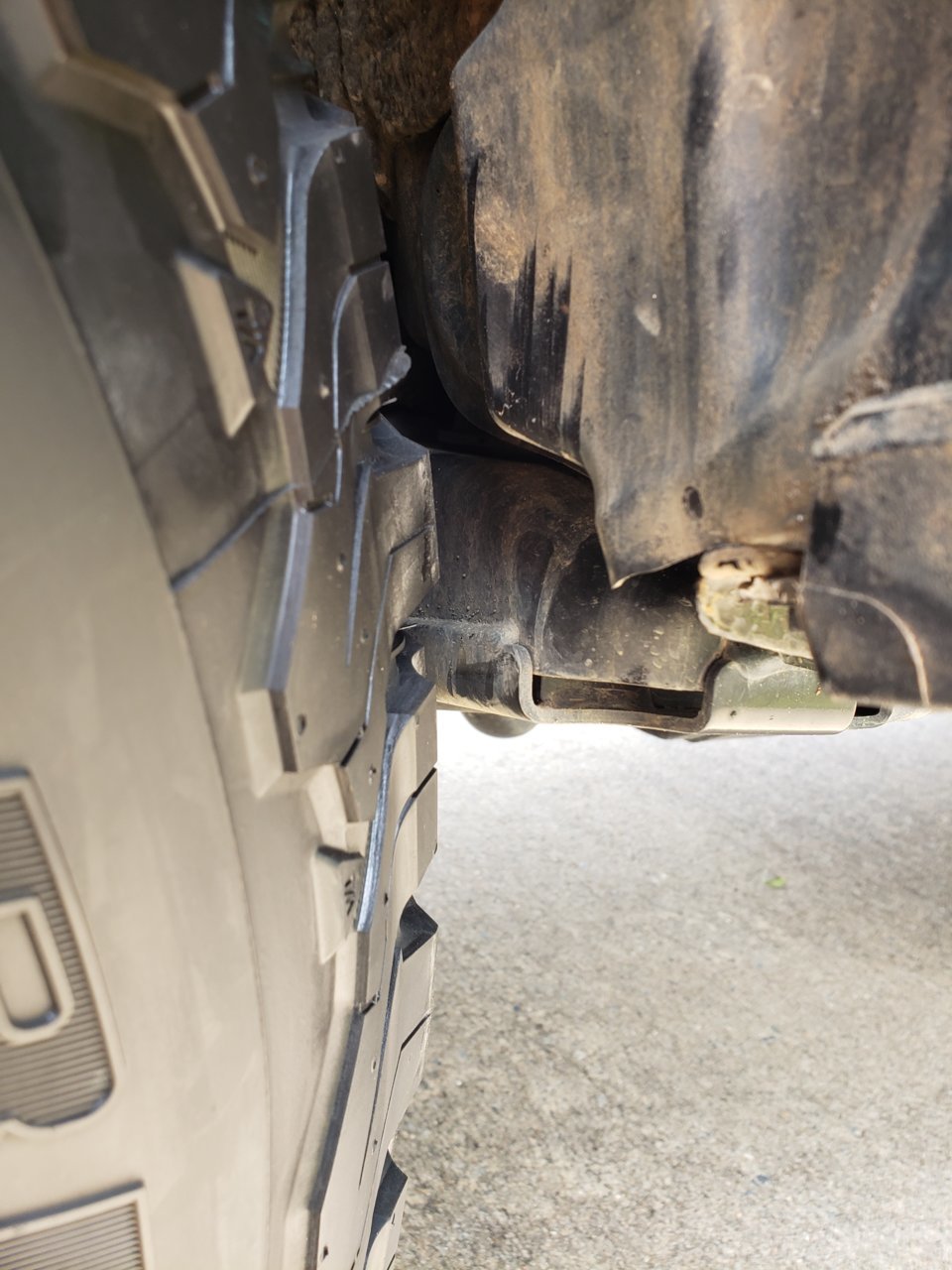

    Here's a quick update on my clearance....its not looking good for me to not have to do a cmc. Also I haven't been able to locate my heat gun so I'm sure it'll turn up after I buy another one. These photos are drivers side with the wheel turned full lock left and you can see the rub on the plastic and the cab mount. Oh, and my uca are stock. Hope this helps as I know all trucks are different though.

    Looks good to me :sawzall::welder:
    Says the guy still running 265s :pout:
