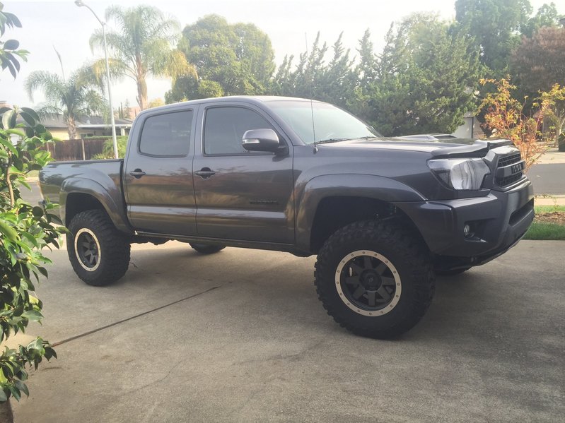

  5. Oct 24, 2015 at 10:16 AM
    #565
    PMfeelsnopain
    PMfeelsnopain Well-Known Member
    Sep 13, 2015
    #164182
    87
    Stefan
    NOR✯CAL - SF East Bay - Concord
    2015 TRD Sport DCSB 4.0 V6 4x4
    Sweet ass bug deflector
    She badd
    Quakes15, justin21 and iK0NiK like this.

    17s?
  7. Oct 24, 2015 at 7:43 PM
    #567
    PMfeelsnopain
    Sep 13, 2015
    #164182
    87
    Stefan
    Yup
    With 285/70/17s
    drknsurfur[QUOTED] likes this.
