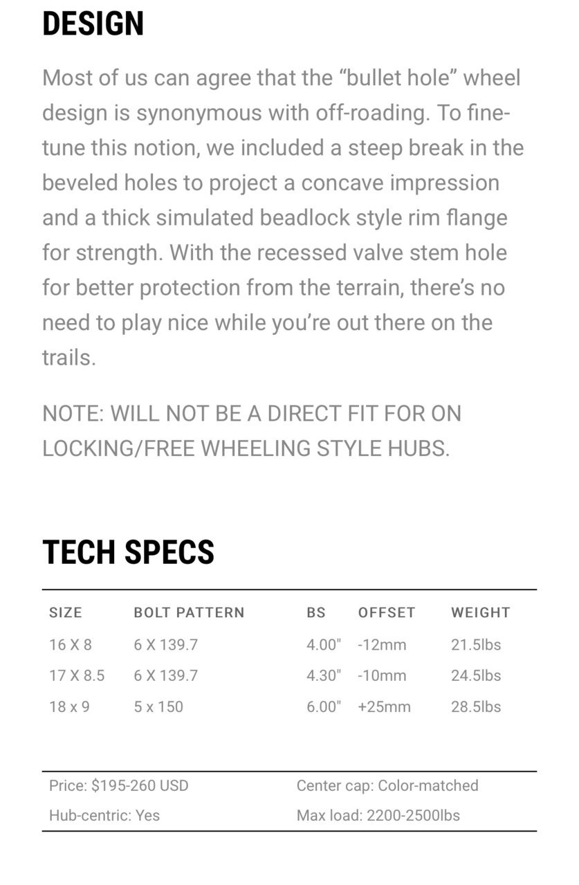

    will my scs ray 10’s fit the 1st gen with the front locking hubs? I was told it doesn’t because the bore wasnt wide enough. I plan on buying a 1st gen and throwing the 33’s from my trd pro onto them. Thanks!

    Just as a confirmation. Ray 10s will not fit manual hubs directly. My assumption with “directly” is that spacers will be needed 92115FEE-70BC-4CB8-8C01-F88161664B05.jpg

    Just my 2 cents as I don't even have SCS but see them everywhere, the F5's probably fit locking hubs because they don't have a center cap.
    Because of that, there is no machined lip inside the hub area for the cap to clip into. That's my assumption anyways...
