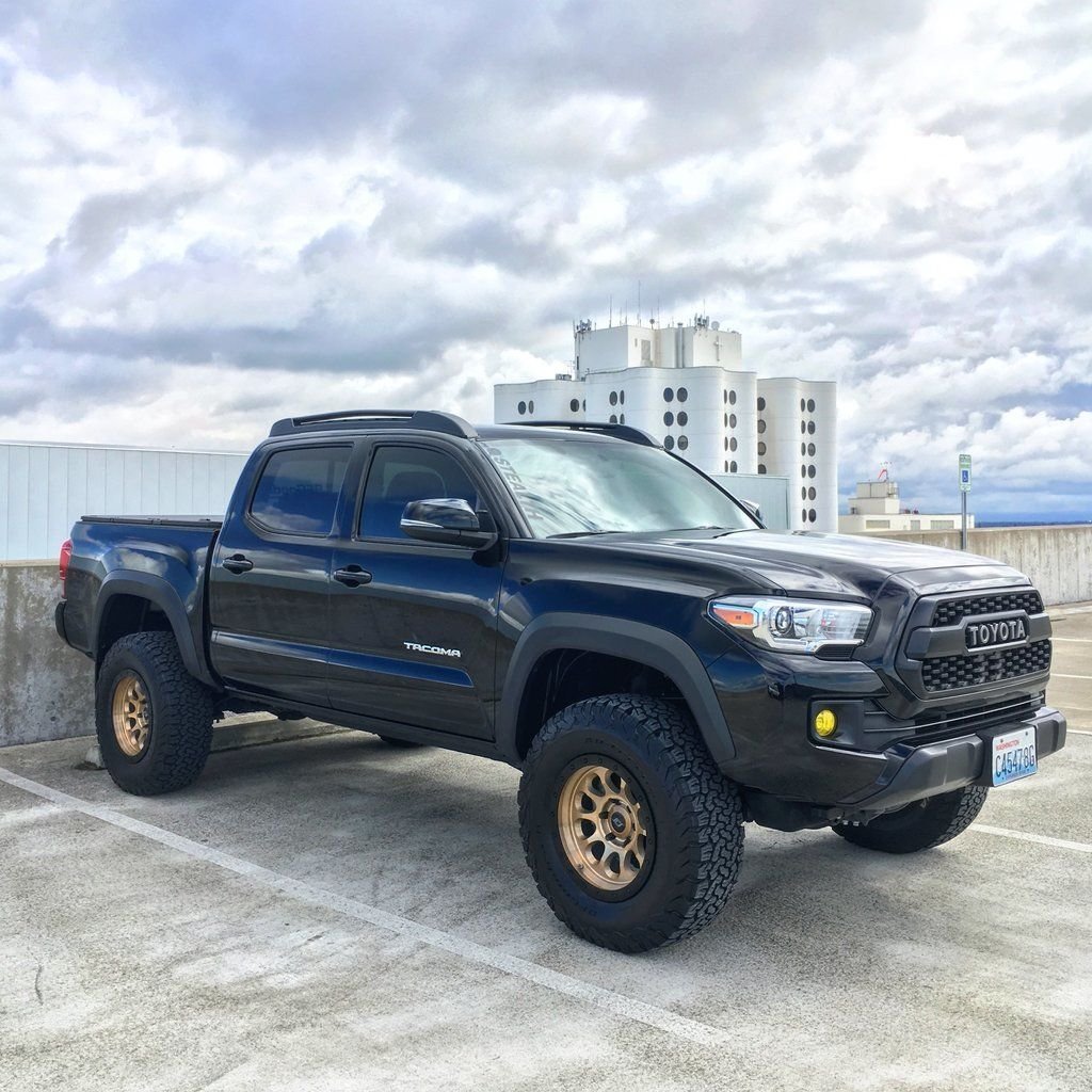

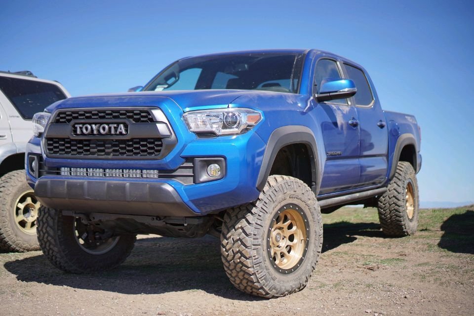

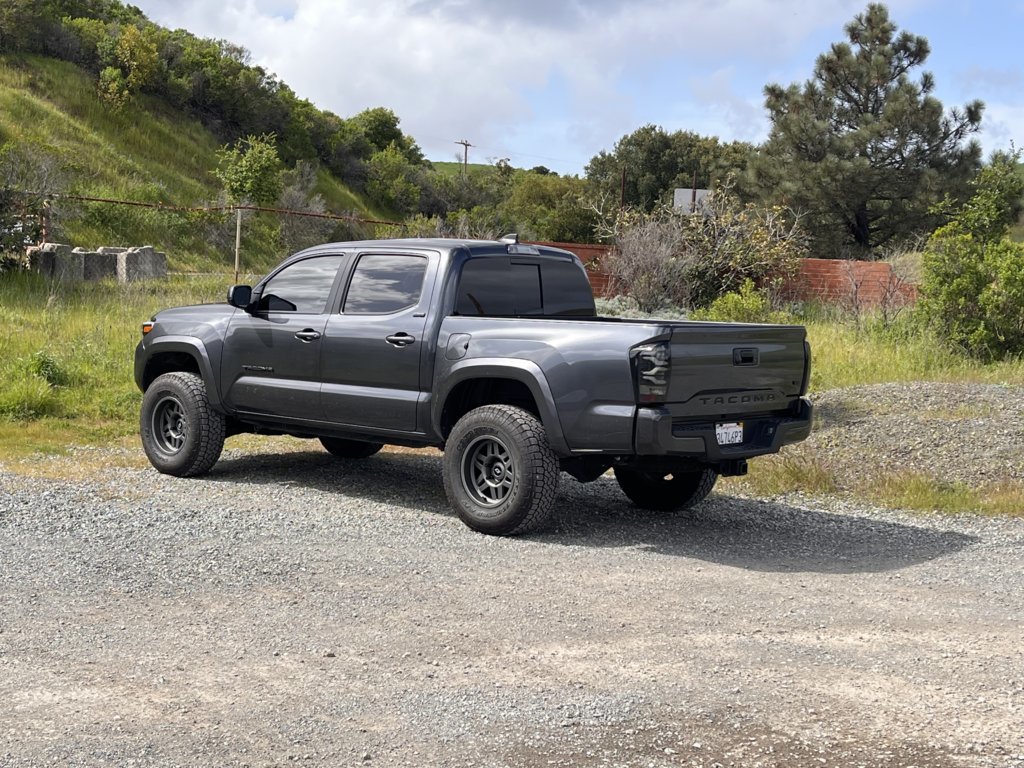

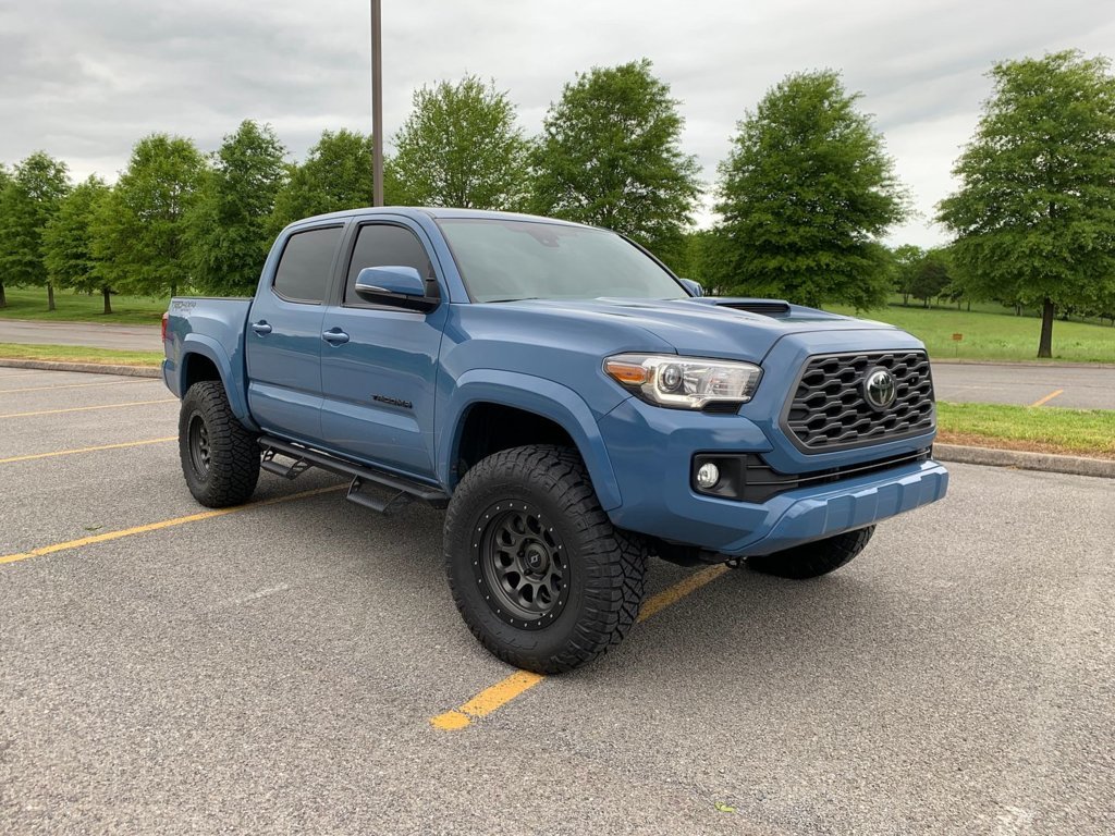

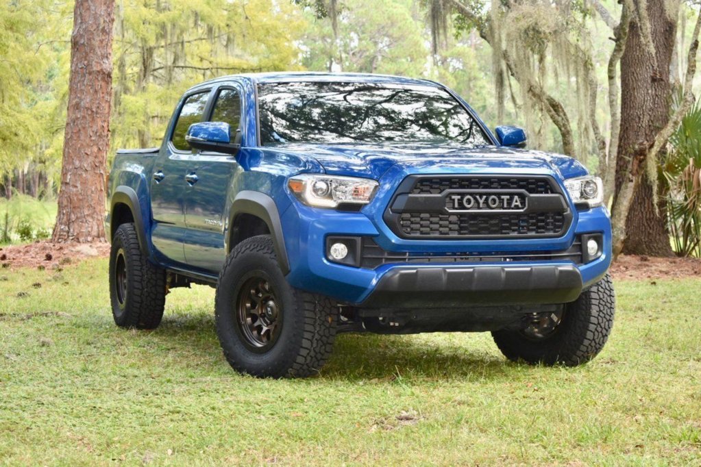

    Maybe this will help.
    -10mm
    -38mm
    5cae4f1a-2ce1-49cf-be2b-1ef589aa83bb_b2ebc270310d42396dd2fc5481eff4a1a052e9fe.jpgc1040009-ed8c-4528-ac0a-7d286cc826fc_95ac113ca483ae6c47de6797cd7d73c3b71c4fbc.jpg

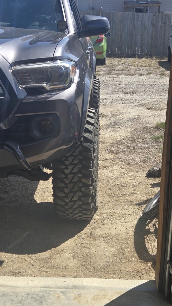

  6. May 7, 2025 at 4:51 PM
    Veet-88
    Veet-88 Well-Known Member
    May 21, 2015
    #155792
    1,567
    18 Tacoma DCLB sport
    Real question is how many rocks do you want coming up the side of your truck and how much mud do you want to clean off the roof. If the answer is lots -38 is what you seek. They look good but in practicality I have only been soso on keeping it long term. I still think -10 with a 285/75r17 is the look and performance sweet spot
    And go 8.5 unless your running a 12.5 wide
    liftedtaco3.5[OP] likes this.

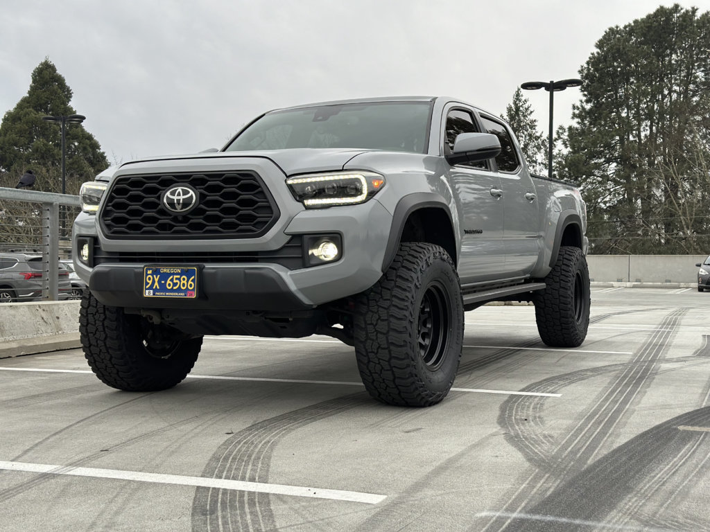

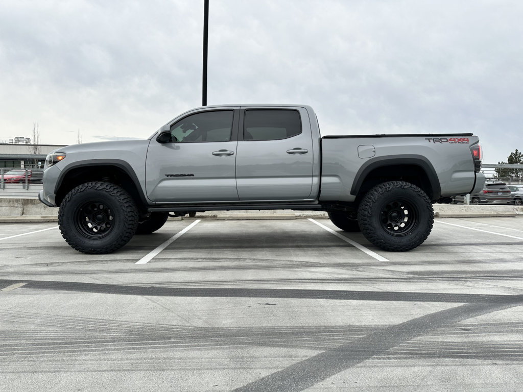

    17x9
    -38 offset
    35x12.5 Mickey Thompson Baja Boss AT
    C4 fender trim with DRT body mount relocate.

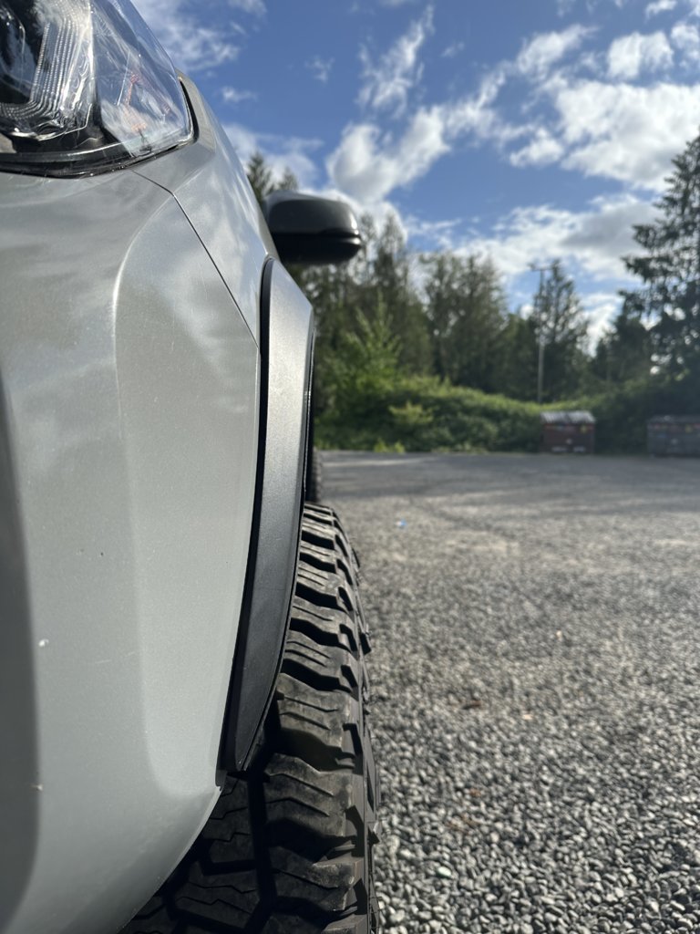

    How far does it stick out pass your fenders?

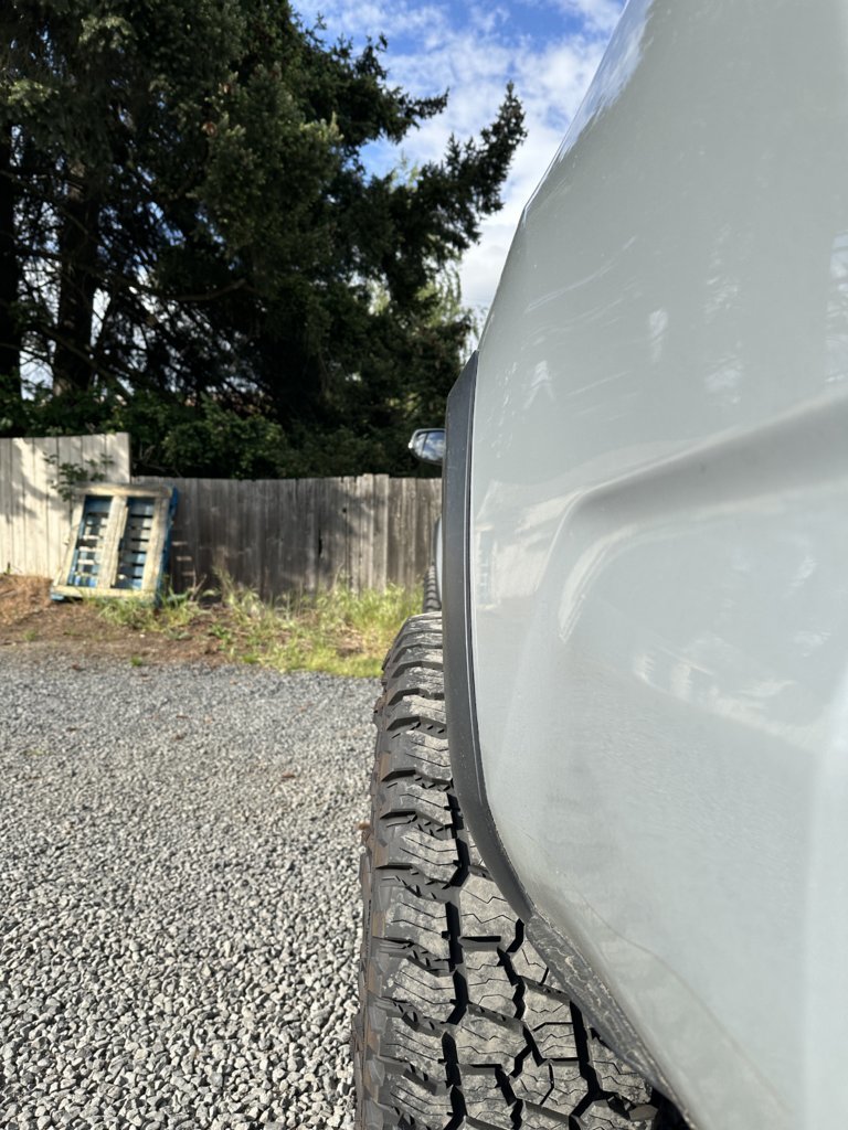

  11. May 7, 2025 at 6:06 PM
    Veet-88
    May 21, 2015
    #155792
    1,567
    Crazy how that looks like it's far less than mine maybe it's just the picture angle.
    I would be far from calling that a downgrade as more rubber works and looks better than all wheel.
    But on a lift that high you may regret narrowing your trac width even to a -10 on a lift that high. It'll look squished and may feel less stable side to side i did find mine felt a little more planted after going to a high negetive offset without the front sway bar
  12. May 7, 2025 at 6:10 PM
    Cement_Bane
    Cement_Bane IG: @cement_tacoma_trd
    Mar 2, 2020
    #320863
    71
    Luis
    Portland, OR
    2019 Cement Tacoma TRD Off Road 4x4 DCLB
    could be combination of angle and tire. at vs MT
  13. May 7, 2025 at 6:15 PM
    Veet-88
    May 21, 2015
    #155792
    1,567
    It's a bit smaller tires aswell. Only a 295 in comparison
