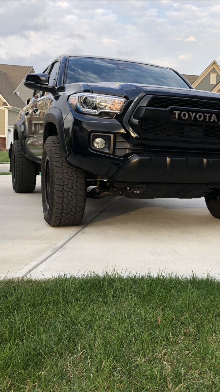

    About to do the exact same setup. Did you have to remove the mud flaps? Wondering if it will rub. Also, do the wheels look "stretched" in person since they're sitting on a 8.5" width? Thanks!

    I have never had mud flaps, but I’m pretty sure you will rub if you run OEM flaps w/ these wheels and a 265 tire. Just going off everything I have read here.
    Tires do not looked stretched at all, perfect fit IMO. I had these same tires on my OEM TRD 4Runner Pro wheels that are 7” wide and they looked odd being on a narrow rim. Look and ride better on these 8.5s.
