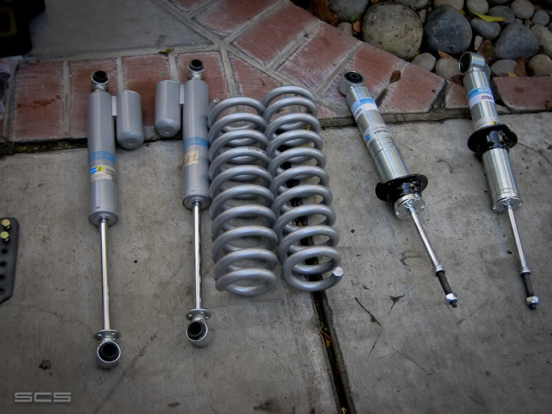

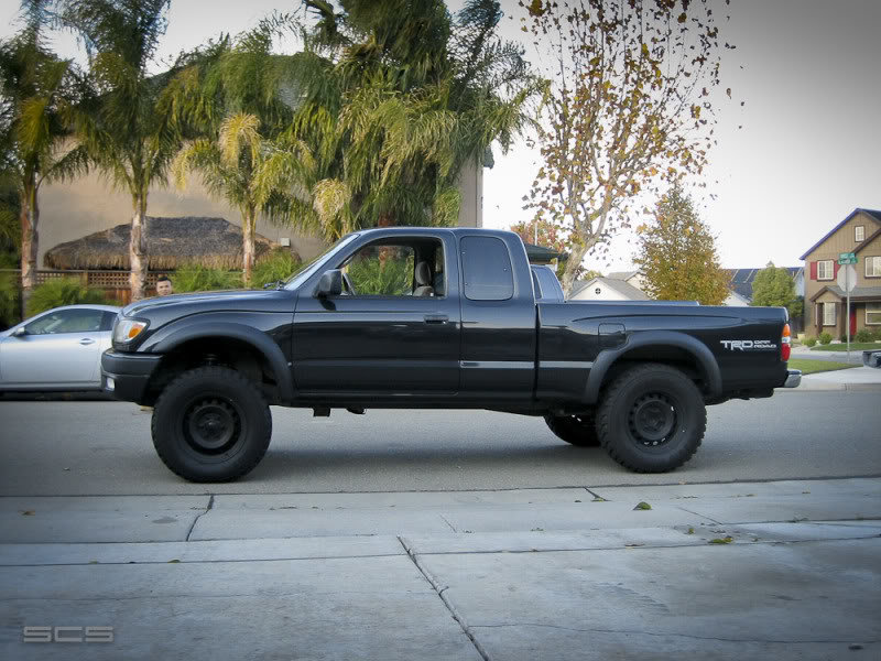

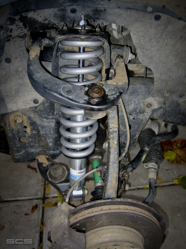

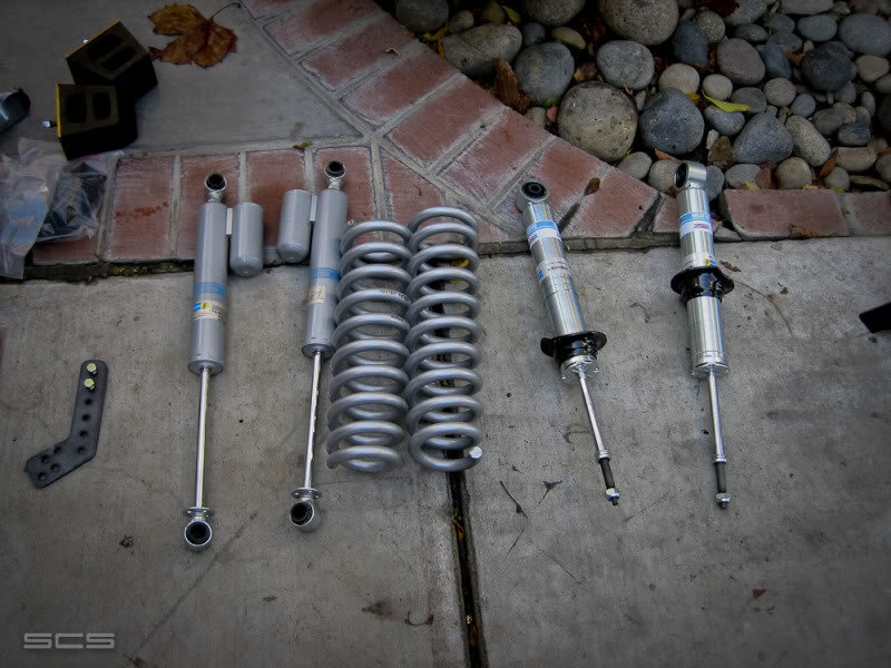

    I finally did it!!! After accumulating a bunch of parts over the last couple of months, I finally got down and dirty over the weekend to install the lift. Special thanks to my brother for helping with everything.
    Unfortunately, I did not have my digital slr at the time so I had to use the good ole point and shoot camera.

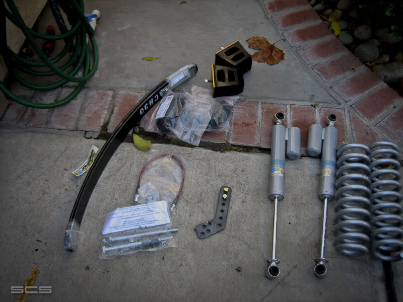

    Lift setup:
    - Eibach lift springs
    - Bilstein 5100 front struts
    - Bilstein 5150 8.5" rear shocks
    - 2" Wheeler aal
    - Wheeler rear extended brake line
    - Toytec differential drop
    - BAMF BPV bracket
    - Energy Suspension 4.5" bump stop

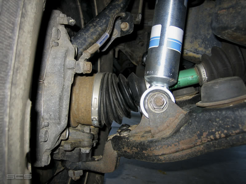

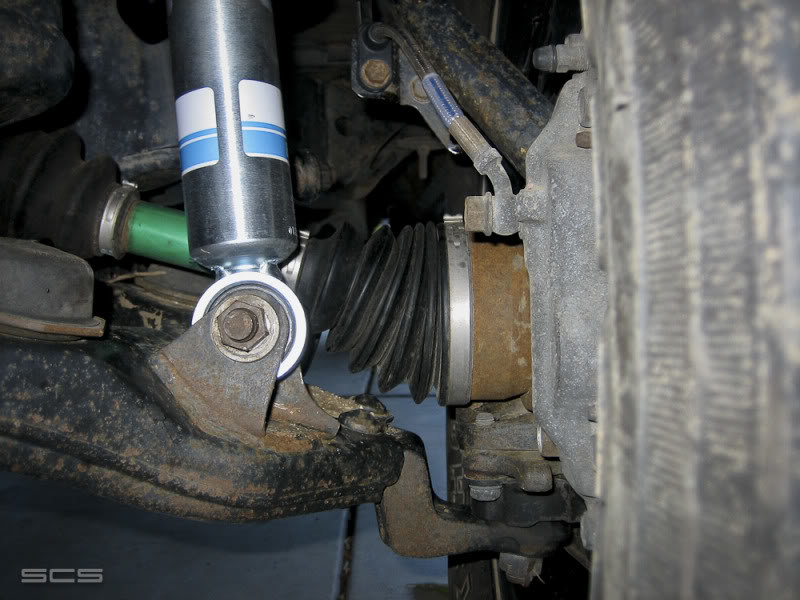

    The front setup went in pretty quick since we had power tools. We did the driver side first with the Billys set at 0. Once the truck was lowered, I took a quick measurement and it seemed like I only got 2.5" of lift so I was a little stumped.
    I then decided to see how it would look on the passenger side if we set the Billys on the middle setting. I know, I know:spy:.
    The angle is pretty steep, but damn did it look good. Now my measurements shows that it's close to 4" up front:eek:. So we took out the driver side and matched it up. I couldn't resist the extra lift. We tackled the rear and installed the 2" aal, rear bump stops, rear brake line, but I forgot to snaps some pics along the way. It was getting dark by then anyways.
    More pics to come soon to show you guys how it looks with the 2" aal. It does ride a little stiff, but better than my stock setup. I'm sure if the Billys were set at 0 it would soften up the front end a little. I'm going to drive it like this for a week and then decided to either leave it in the middle setting or drop it back down to 0.
    Now I wished I would have gotten 285/70/17 instead of 265/70/17.

    You take those shocks off right now and install them correctly! You will KILL your CVs in days with that much lift. They are made to only be on the 0'' setting man. It even looks like you got over 3'' of lift with it on 0 so..idk why you didn't like it that high..
    Trust me man..your just setting up your truck for some MAJOR pain.
    Do it right..or don't do it at all...
    The tires will help tho once you get them.
    Other then that. Can't wait to see more pics as i pretty much provided 1/4 of this lift lol
    but please!!!! Put the Eibachs on right..

    And dude you have too. There is not option to or not. You'll just hurt the truck if you don't.

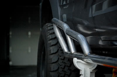

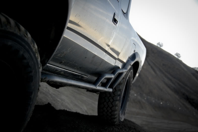

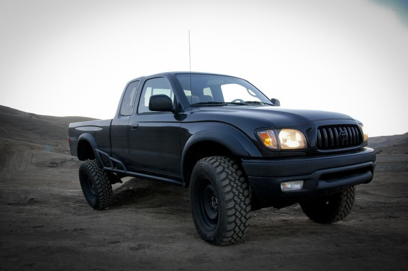

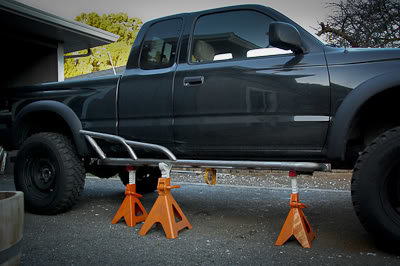

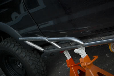

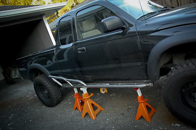

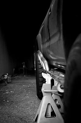

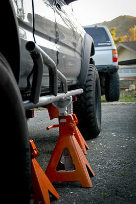

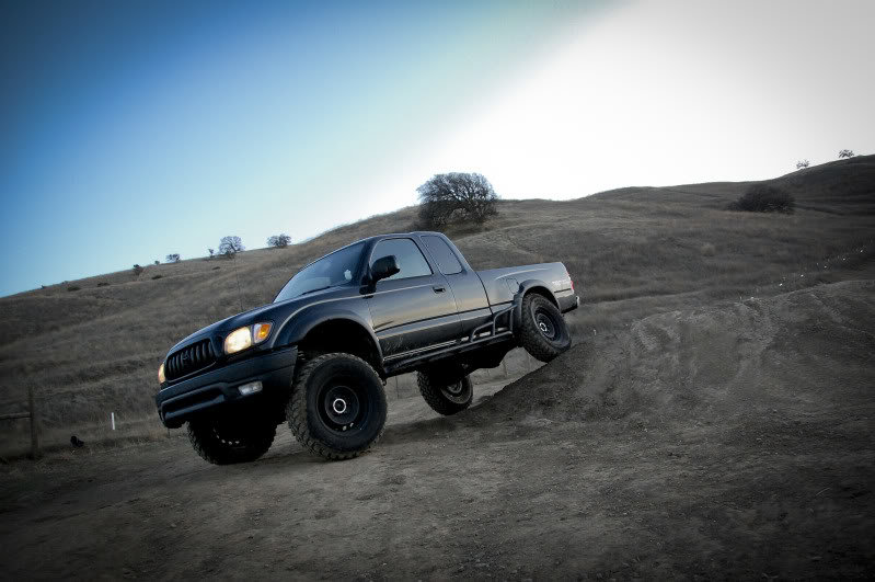

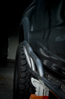

    I've been slacking in the photo department. I don't have any nice shots yet post lift, but here's a few shots that I took while testing fitting some BAMF sliders.

    YOU STILL HAVEN'T FIXED THE FRONT COILS!!!! $#%@#%@$%@#$!@$!@#%!#!#@$@$#$*()&)@#$%*@#$%@)(&@#$*%@$*(&^@)#$(*&.........
    But bad ass sliders m8 :D

    Monte, I though you had better eyes than that man[​IMG]. They are set at 0 buddy. I think my 265/70s are too small, selling your 33s anytime soon??? HAHAHA.

    hmm..there is one pic that looks like its not..maybe I'm just used to the rake look lol

    i got the brackets and gussets welded on. next week, i plan to paint them and get them welded onto the frame. pics coming next week.

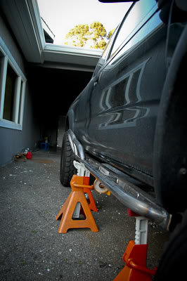

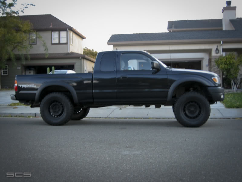

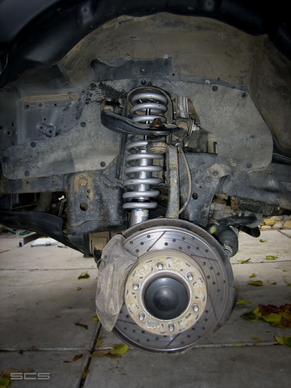

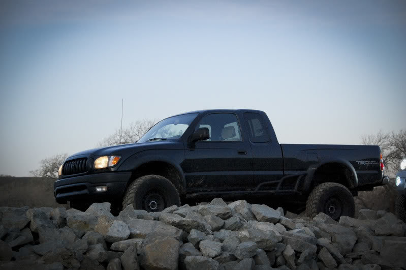

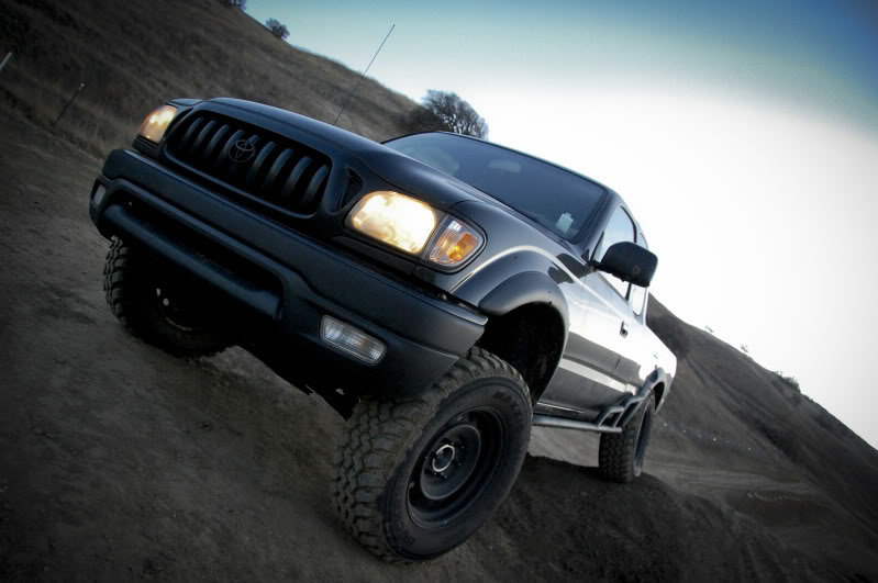

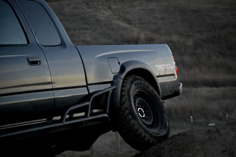

    More updated pics

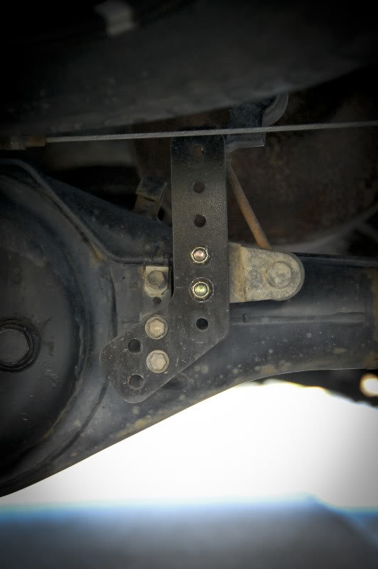

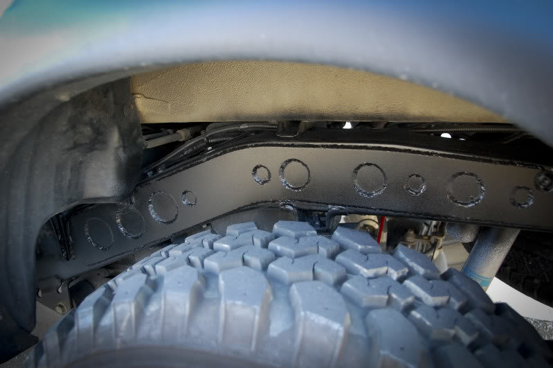

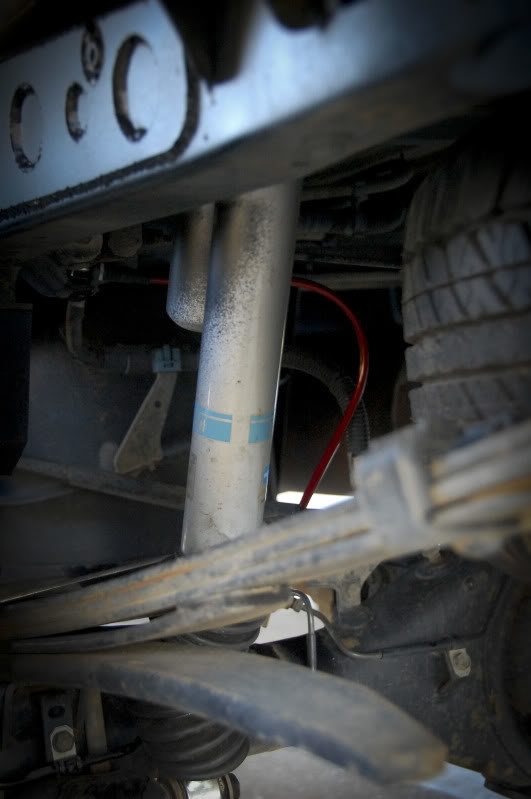

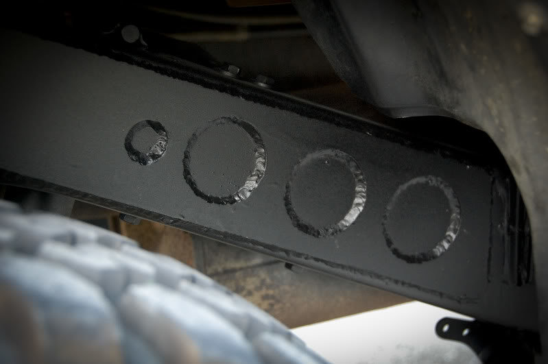

    Wheeler extended brake line
    BAMF BPV
    Mercer frame reinforcement plate
    BAMF slider w/kickup

    Damn those look great man!
    nice photos!
