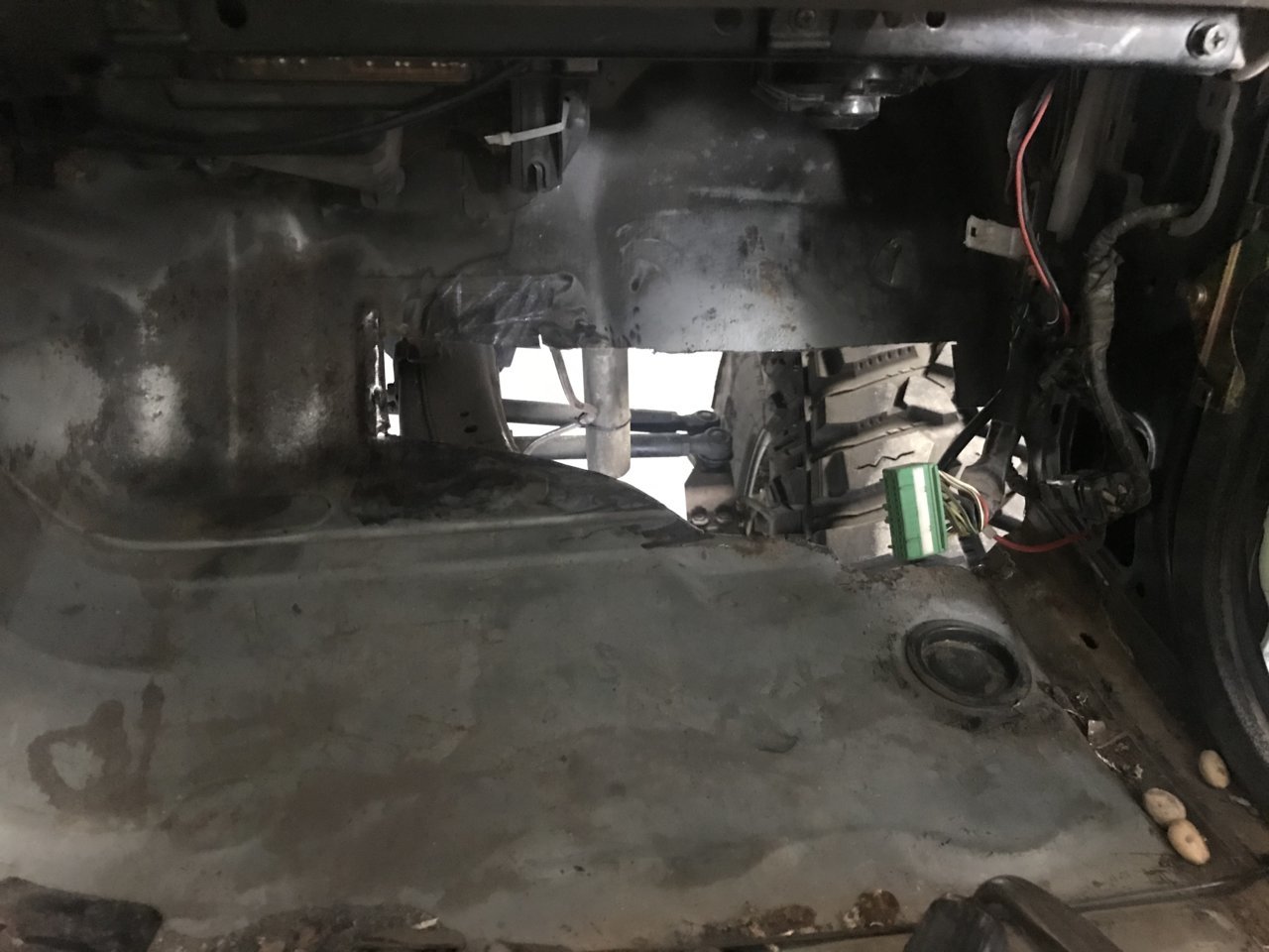

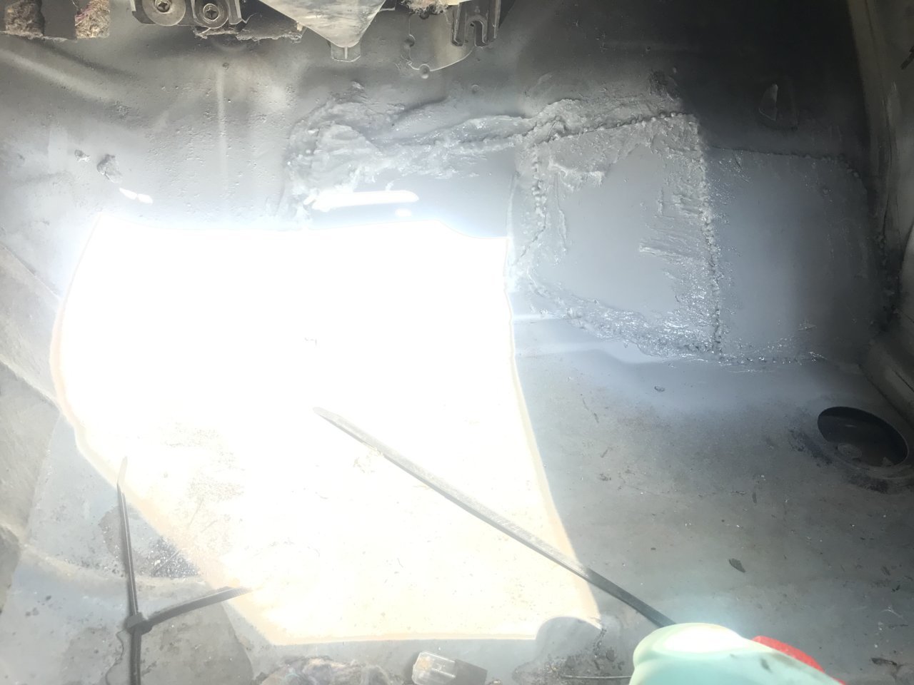

    So yesterday I decided to tackle a little bit of rust I saw in the firewall near the pinch weld.. the area we normally cut out when we tub the fender wells to clear larger tires. The rust hole was about the size of a quarter so I cut out a 3x3” square. It ended up looking like a 6x3 and when I started to patch that I started melting metal that I didn’t think was rusty. Well.. here’s where I’m at.

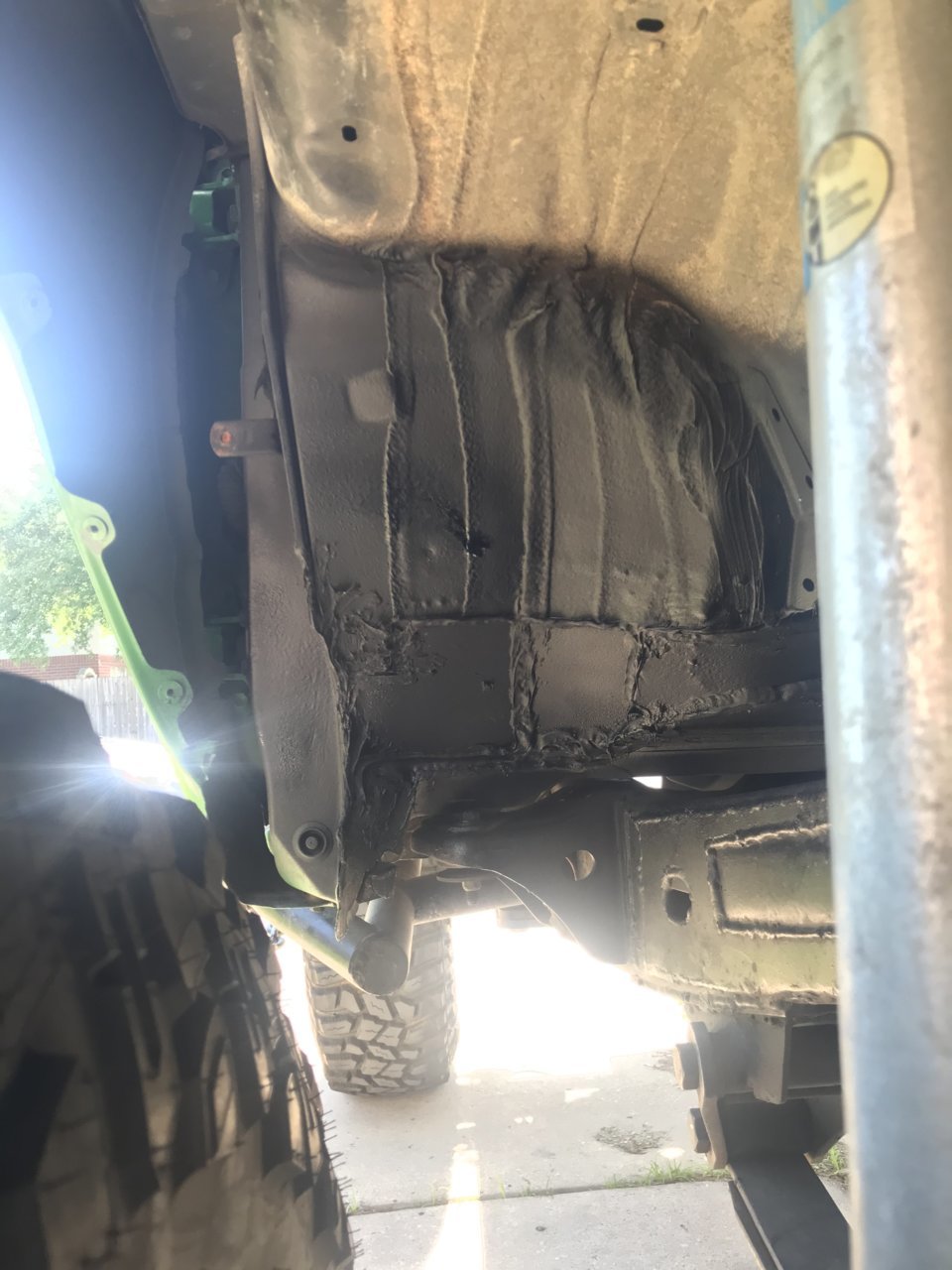

    Finished the rust repair. Similar to tubbing the firewall. This time I welded the patch panels back on from the inside instead of the outside. Just made more sense considering I would have had to work around the frame if I was patching on the outside.
    It’s not perfect but the silicone and undercoating should keep it sealed up.

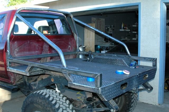

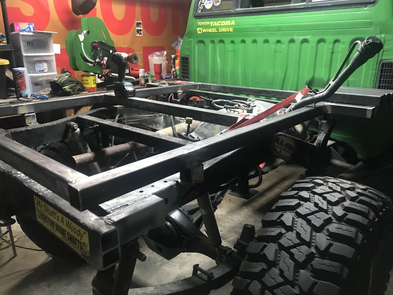

    Started on the flat bed today. The picture of the maroon truck is one I found online that I’m using as inspiration.

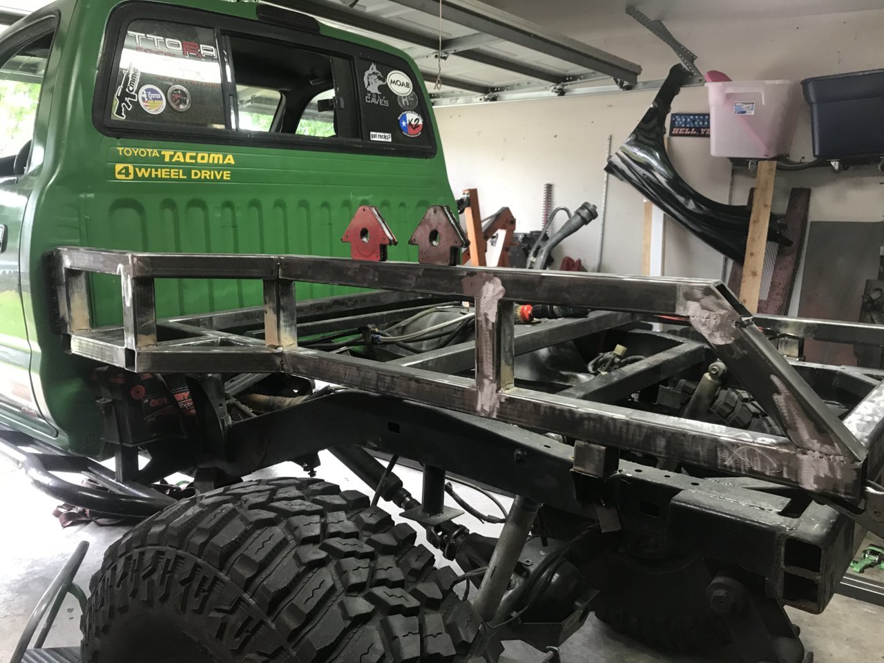

  15. Apr 2, 2020 at 1:06 PM
    #215
    TherealScuba
    TherealScuba [OP] Sober Member
    Mar 28, 2012
    #75781
    1,152
    Stephen
    Austin, Texas
    99 Single Cab 4x4

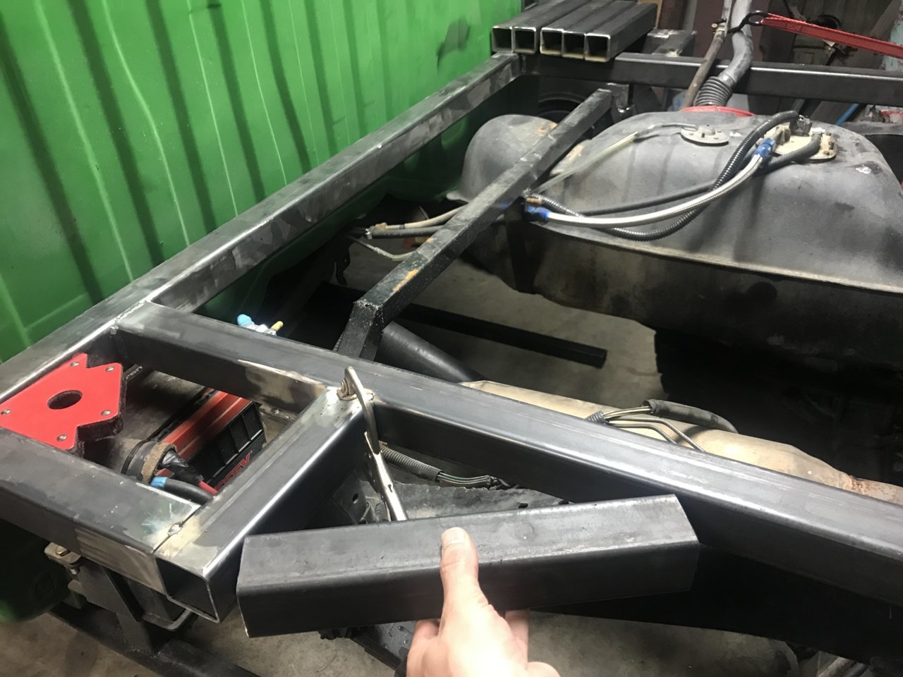

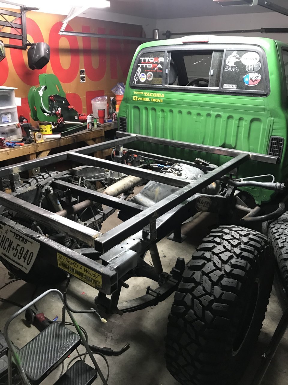

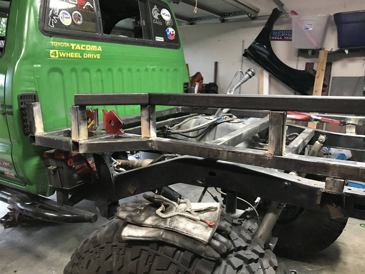

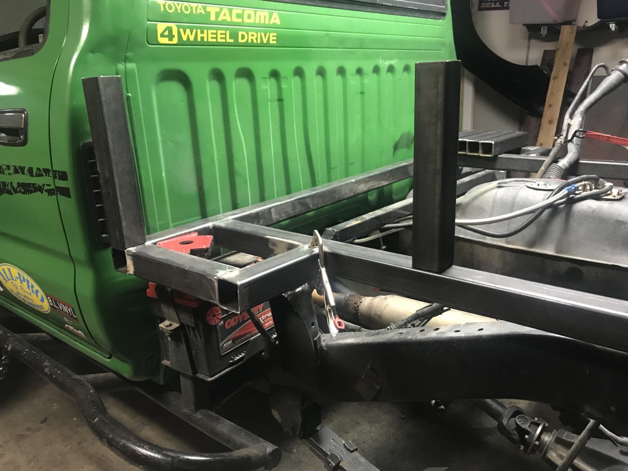

    Today I “modified” the gas tank with a BFH so I could I drop the frame 2”, got the frame fully welded, tacked in the side extensions on the front right behind the cab. I cut all the upright supports and finished my chop saw blade doing so. Then I decided A. the upright supports were too tall and B. I can ditch one and use it as a 45* to extend the extensions.
  16. Apr 3, 2020 at 2:30 PM
    #216
    TherealScuba
    Mar 28, 2012
    #75781
    1,152
    Stephen
    Austin, Texas
    99 Single Cab 4x4

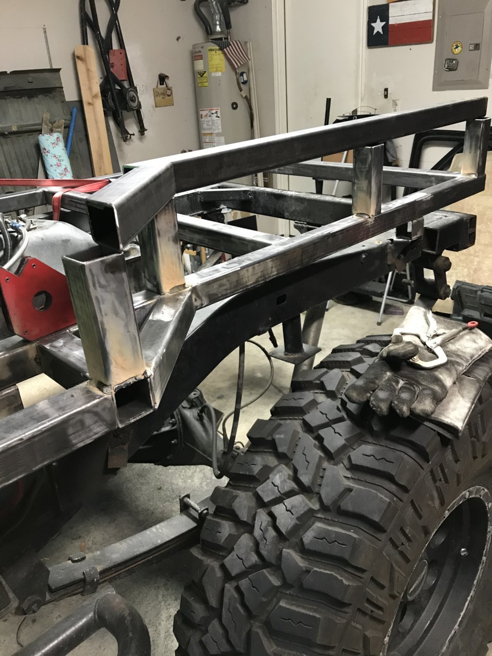

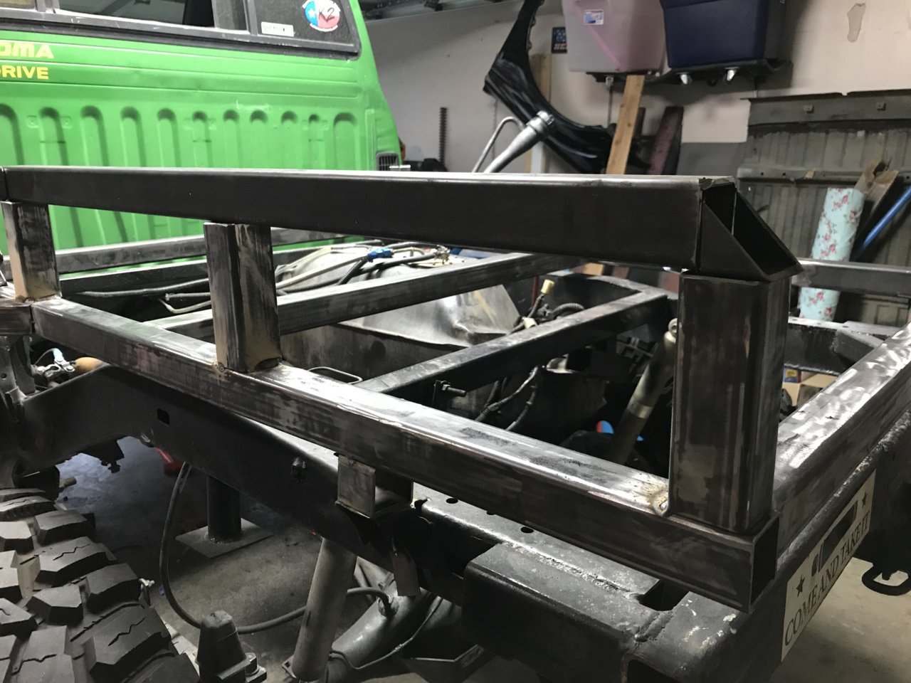

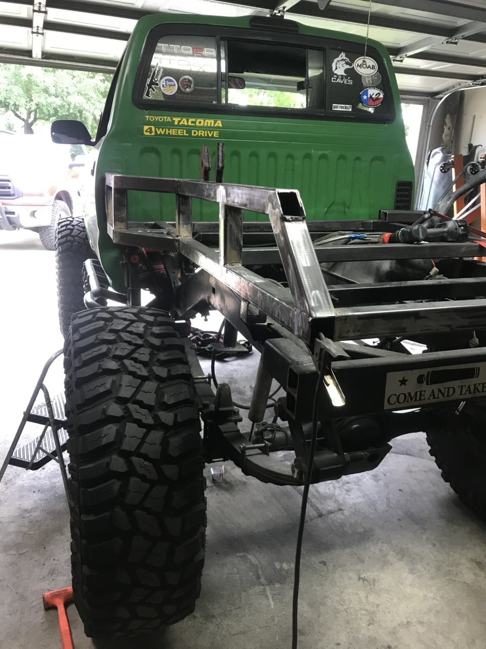

    Alright made a little progress. Decided that 14" tall bed rails would look goofy AF on such a small truck.
    Cut the 12" vertical posts in half. Got the angled extensions welded in and the posts tacked in. Got the upper bed rails mostly cut.
    Trying to figure out what to do with the hard angle at the very back. I may take that vertical post out and make an angled post.
    la0d0g and Snowy like this.
  17. Apr 3, 2020 at 5:15 PM
    #217
    sparkystaco
    sparkystaco Well-Known Member
    Jan 26, 2010
    #30122
    5,833
    Sparky
    SE Wi
    06 4x4 dc trd ofrd
    3" lift? A.R.E cap 285/70/17 moto metal 955 17x9

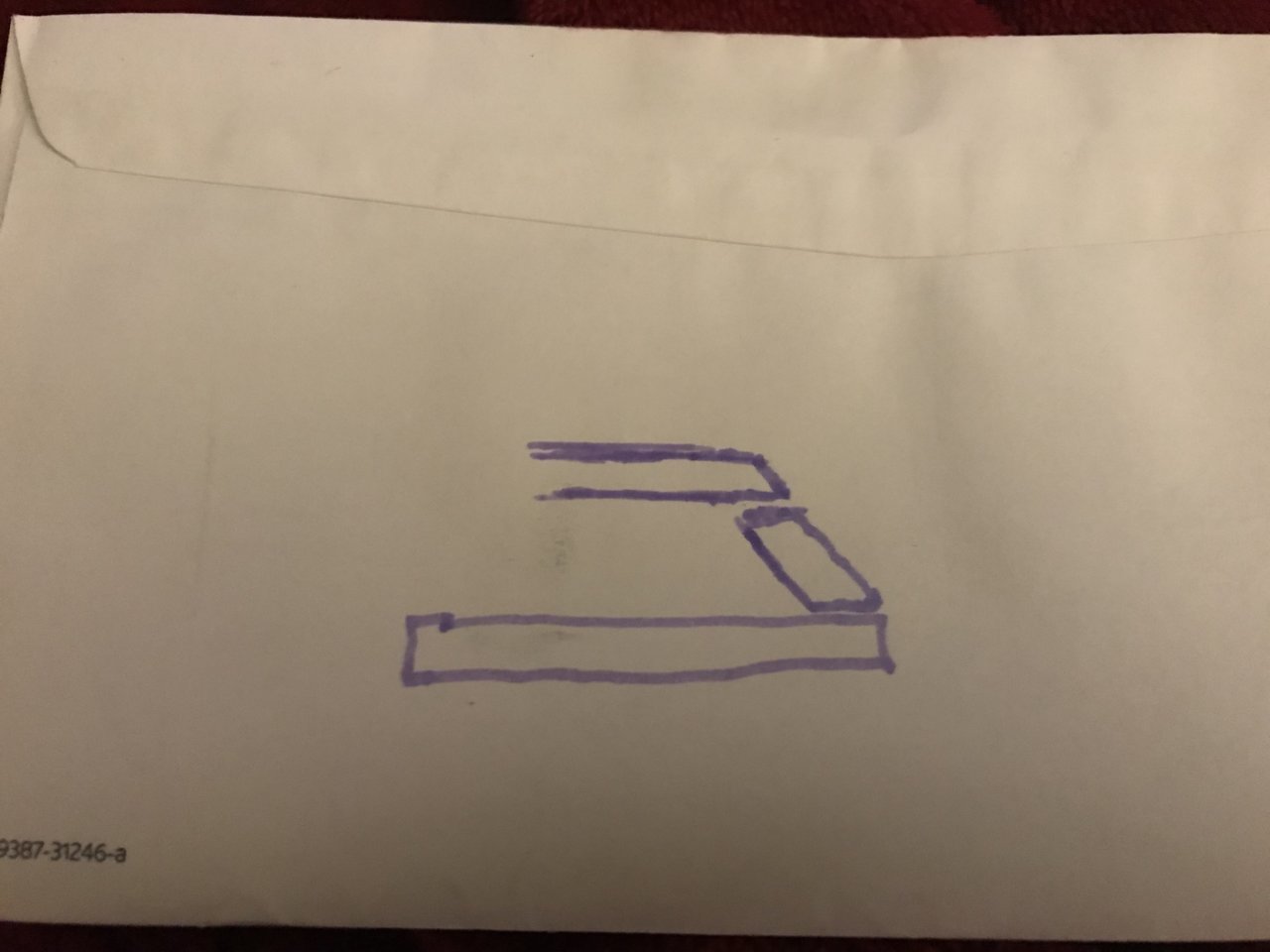

    Just a thought, but think about cutting the last post in half and angling the top tube into it.
    BTW love your build been following for a while.
  18. Apr 3, 2020 at 6:17 PM
    #218
    TherealScuba
    Mar 28, 2012
    #75781
    1,152
    Stephen
    Austin, Texas
    99 Single Cab 4x4
    Thanks! I really appreciate the input. To be honest I’ve been second guessing the look of this whole thing after today. But, regarding your idea, that’s about what I’m thinking. I would throw out that rear most post and cut a new one that would angle towards the front. Then cut the top rail at an angle so they go down and to the back at the same angle.
    It would look like this.. (very crude drawing but y’all get the idea).
    sparkystaco[QUOTED] likes this.

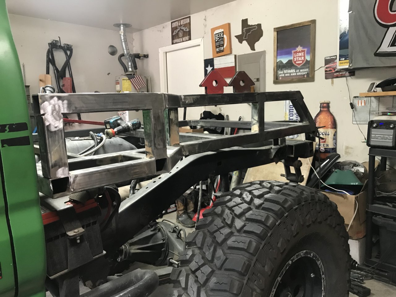

  20. Apr 6, 2020 at 1:54 PM
    #220
    TherealScuba
    Mar 28, 2012
    #75781
    1,152
    Stephen
    Austin, Texas
    99 Single Cab 4x4

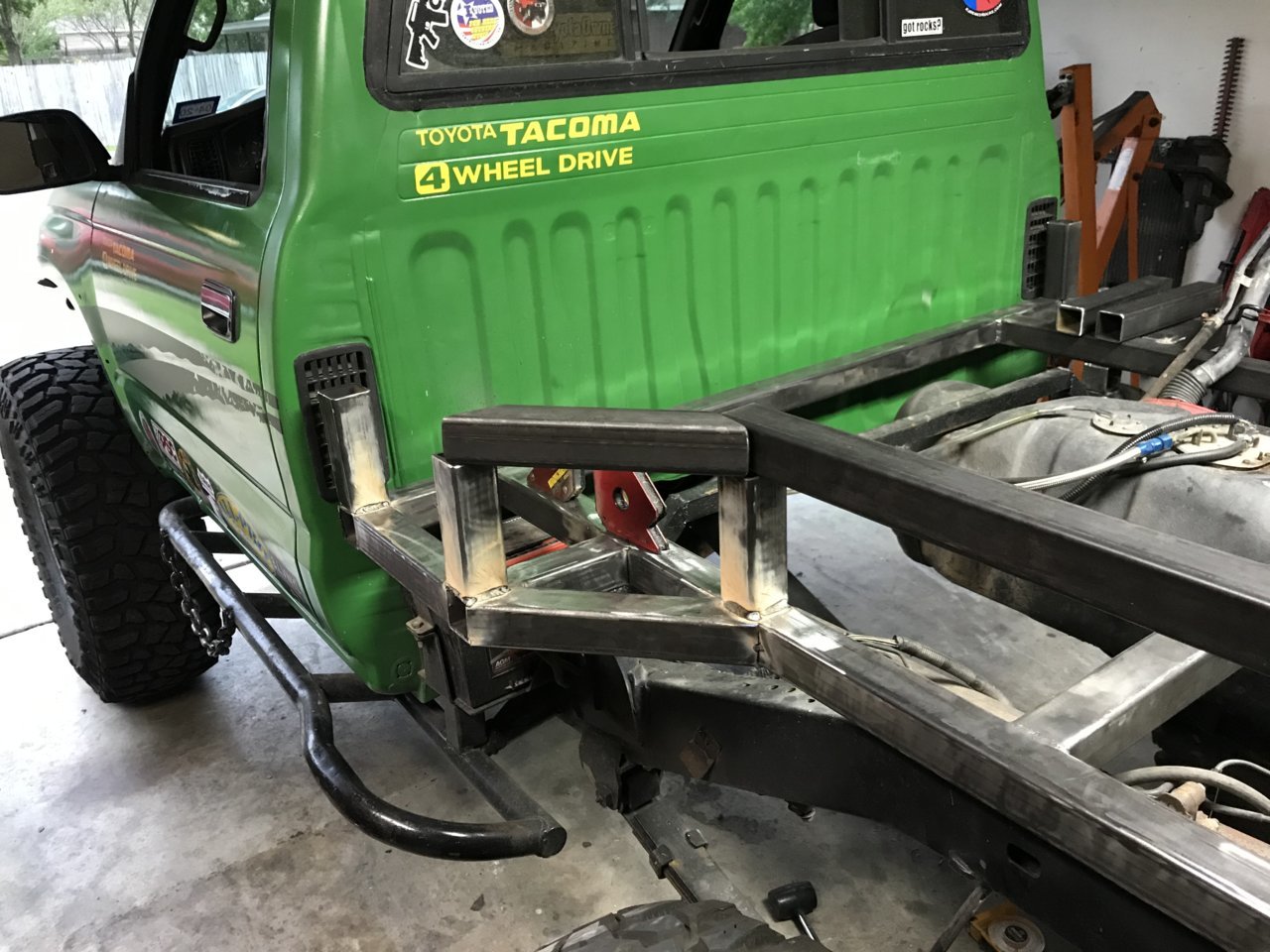

    Got the left side finished out. Have a few more welds to cover and need to figure out how I want to cap the ends. But I’m happy with how it’s come out so far.
