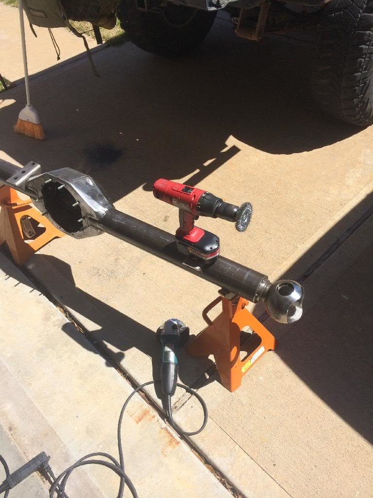

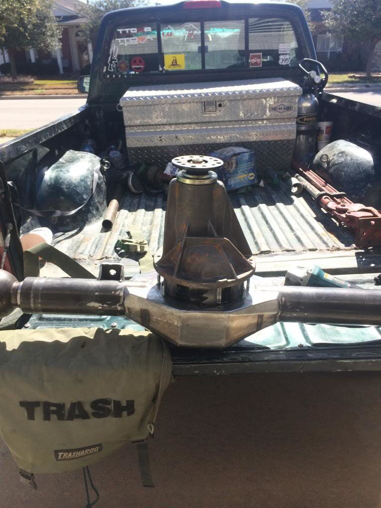

    On another note: I'm working on the axle today. Getting the axle cleaned up, had to clearance the inside of the housing for the diff.. Etc. pics later..

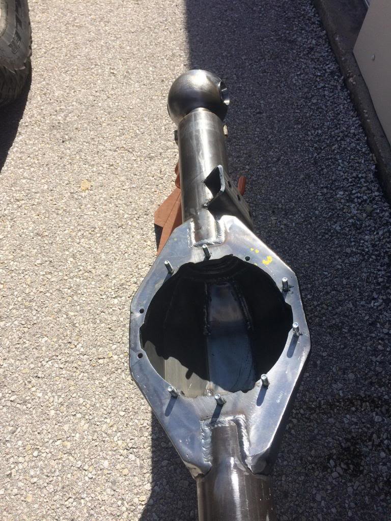

    Did some prep work today..
    Got the studs in the housing, replaced the stock knuckle bearing races with the Marlin 25MM ones, polished the knuckles.. etc.

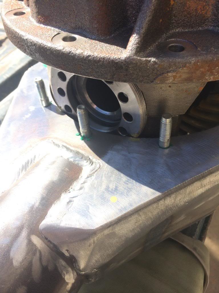

    Biggest issue of the day.. when I tried to dry fit the Marlin diff inside the housing, it wouldn't fit. The adjusters are so far out... brought it home (I have to keep my parts at the storage unit a few miles away) and started grinding. Nicked a diff stud but got it out. Got the diff to fit. Took lots of persuasion.

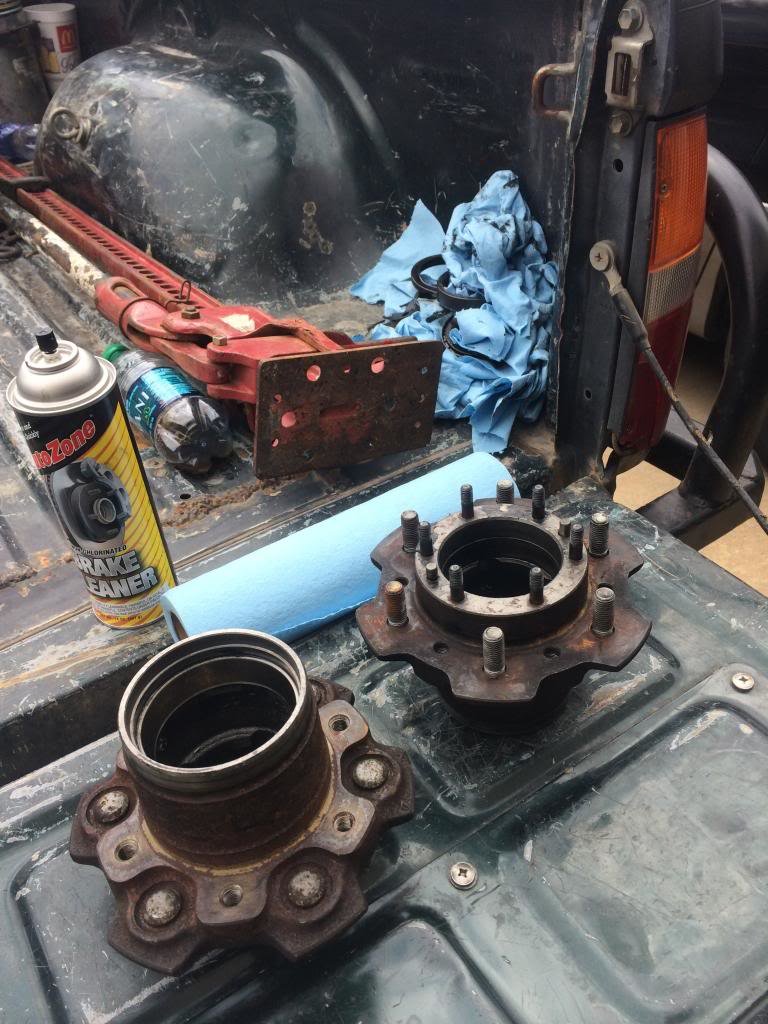

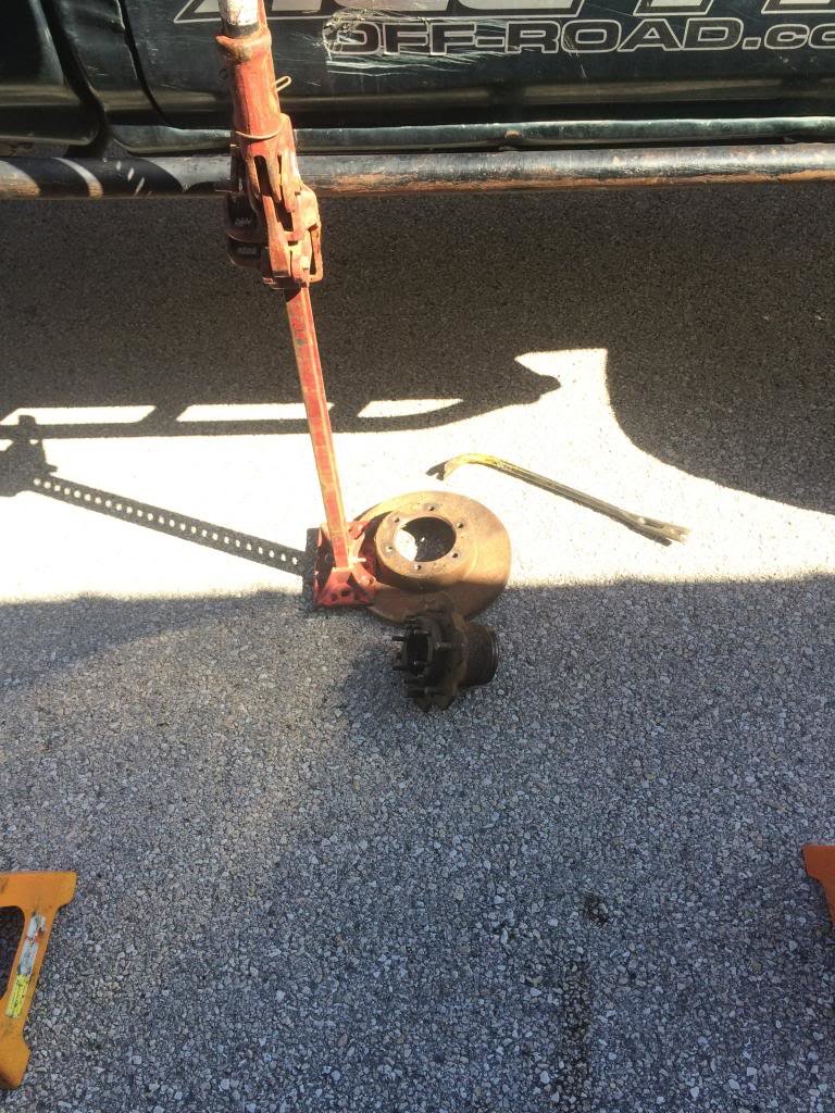

    I also pulled the old rotors off of the IFS hubs. I might try machine those down with my grinder here at home.

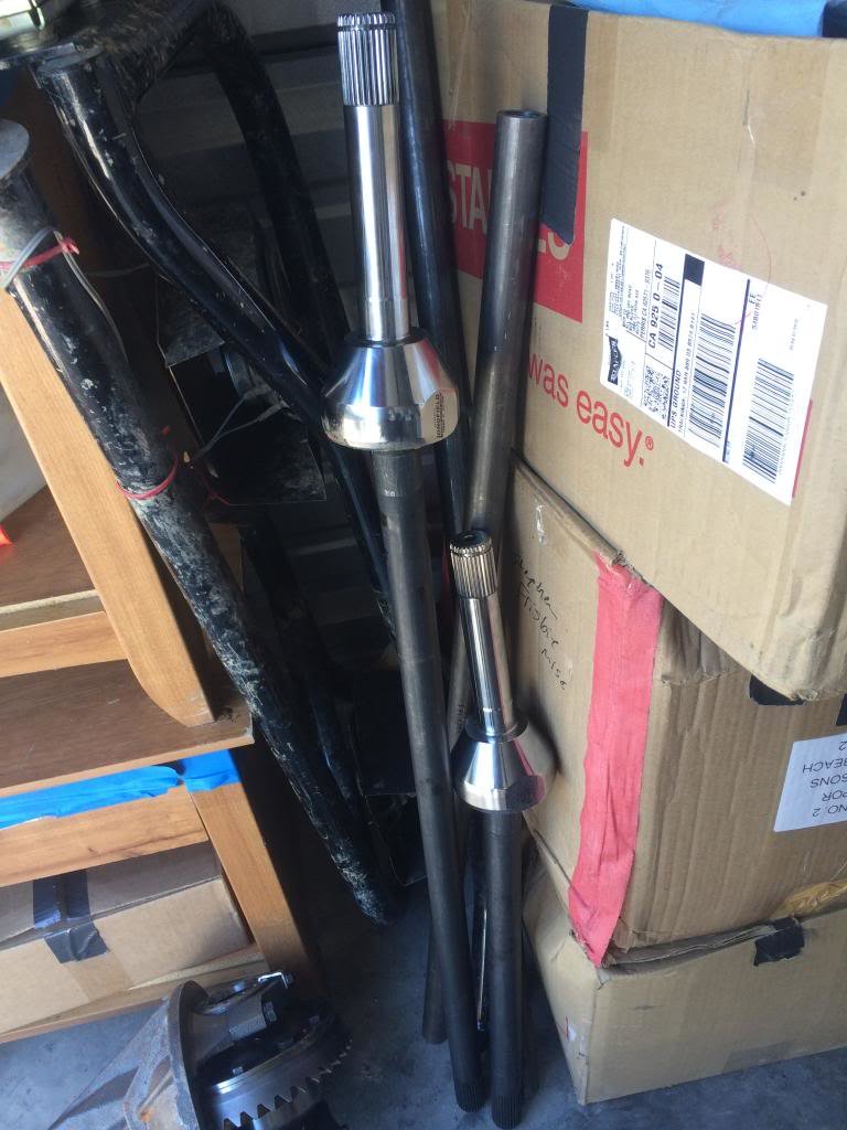

    Before putting the shafts in the birf, I verified they fit in the knuckle ball without grinding. They did. :)

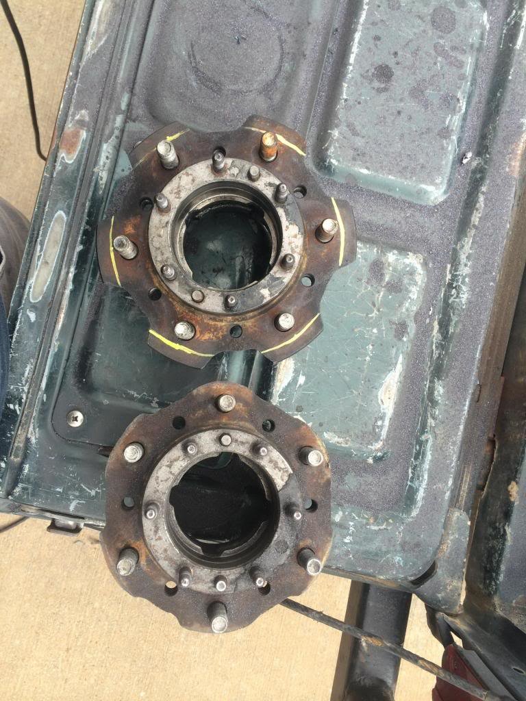

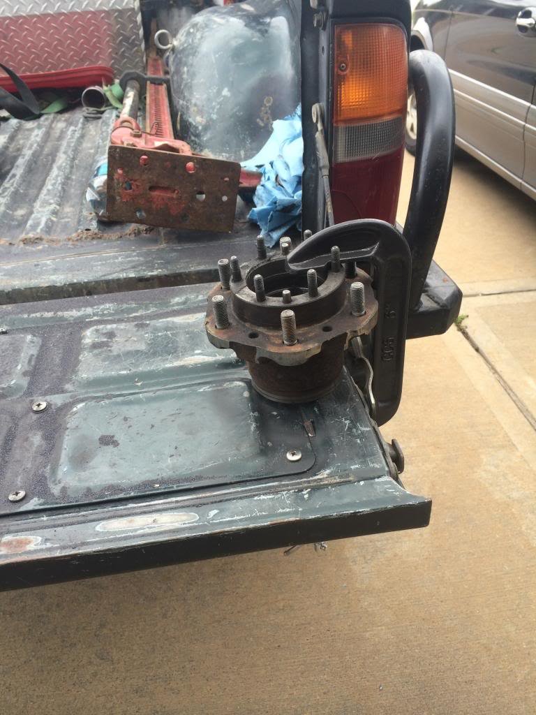

    Prepped the IFS hubs today. Got them cleaned, stripped of the old bearings/ races, turned down, and cleaned again. Ended up taking them to Autozone to check the fit in a Tacoma rotor. 1 fits, 1 is slightly too big. Will fix that sooner or later.

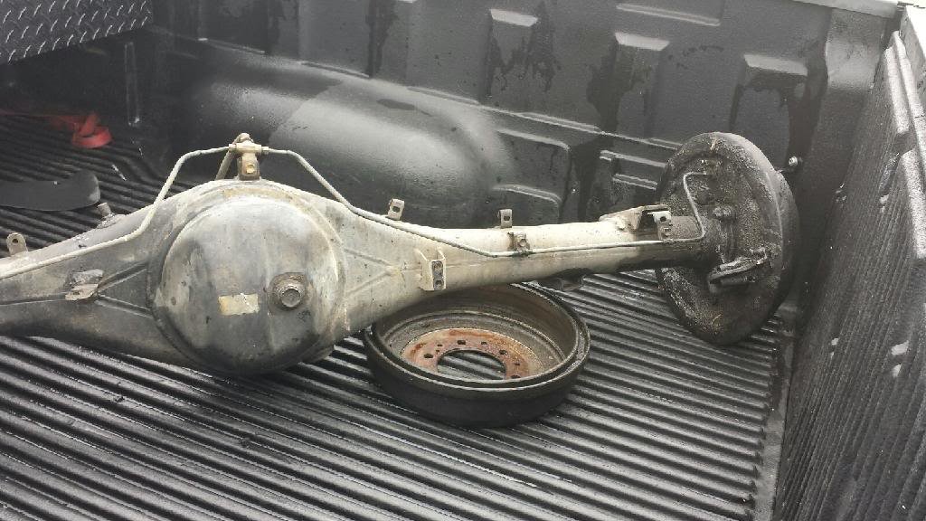

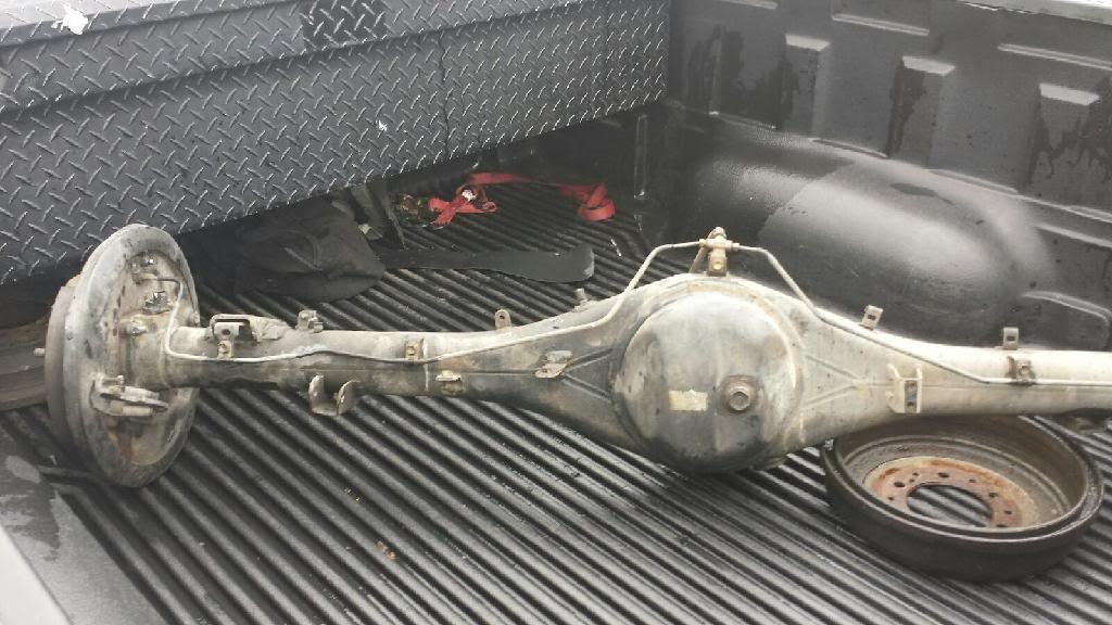

    A good friend of mine just picked up my rear axle from up in Dallas. He was headed up there for the ufc fight anyway so it made sense.
    Its from a 2002 Tundra, unknown mileage. These are 67" wide so it will match my front perfectly. Was only replaced because of a leaky pinion and axle tube seal.
    I will end up putting my 8.4 3rd in this. I'll also use my brake backing plates with the tundra shafts so I can keep the e-brake cable up above the leaf springs.
    It's a little dirty but that's not a big deal.
    Edit: picked it up for $120 and I owe my friend $45 for gas. Not bad in my opinion.

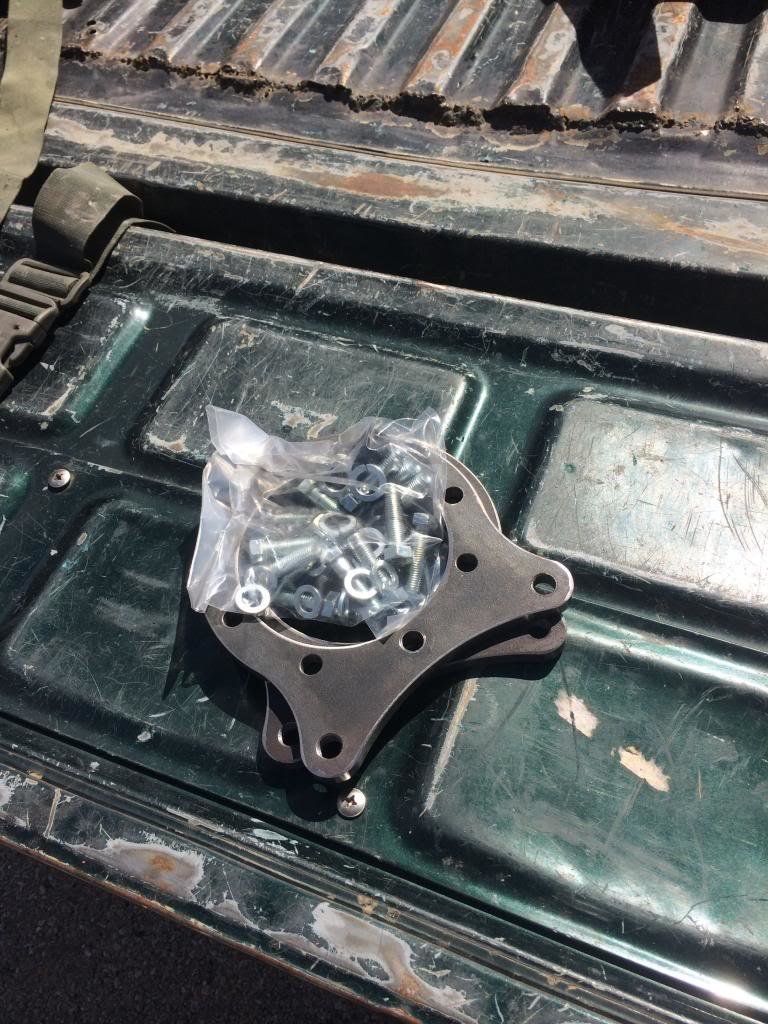

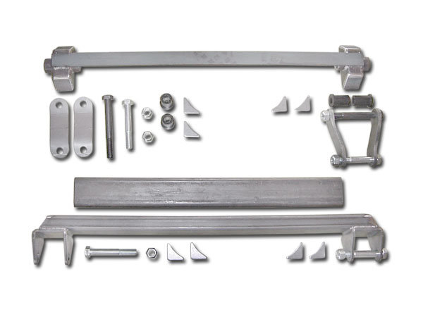

    Today I ordered the forward swing bronco steering box and a u-joint to connect to it (the one on the TG kit probably won't work).
    Also finally ordered the FROR hanger kit.

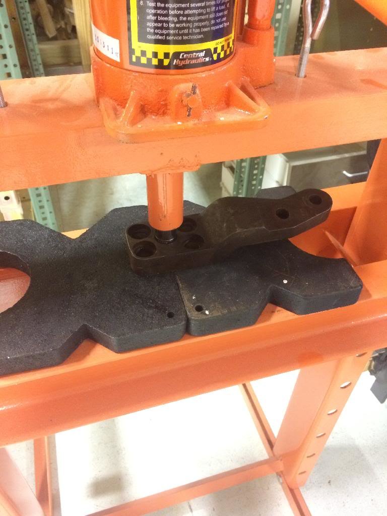

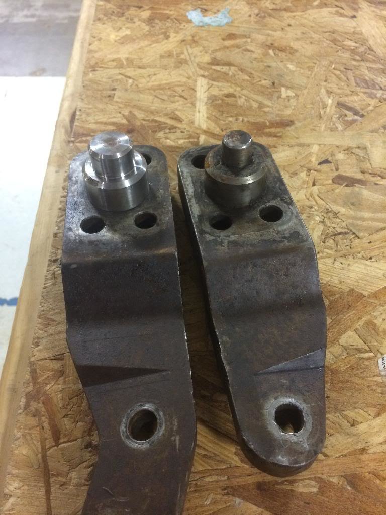

    Today I got to borrow a friends press so I could put my Marlin 25 MM pin kit and arms together.
    The difference in size vs. stock. These are BEEF!
    Special thanks, again, to Tom (Monkeyproof) for these FREE Marlin Crawler arms. Can't thank you enough!
