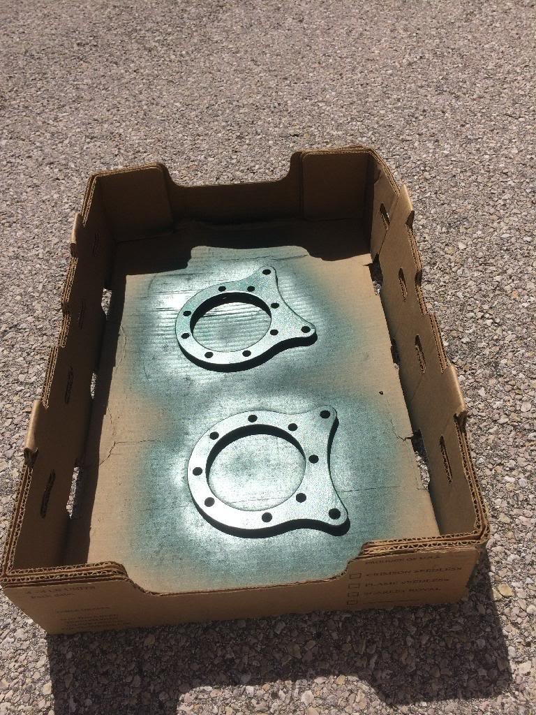

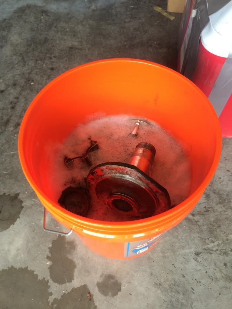

    Got my knuckles and spindles washed up today. Need more cleaning. There's 10 years of caked on grease on the knuckles. I'll probably soak them in something overnight soon.
    Got the axles out of the tundra rear. Tried getting the 3rd out but the fipg has it very stuck. Will try again soon.
    Got my brake brackets painted. Color matched them to the truck. Didn't feel like buying black paint and I had this stuff laying around.
    That's all for today. Really can't do much else with the front axle until its under the truck.

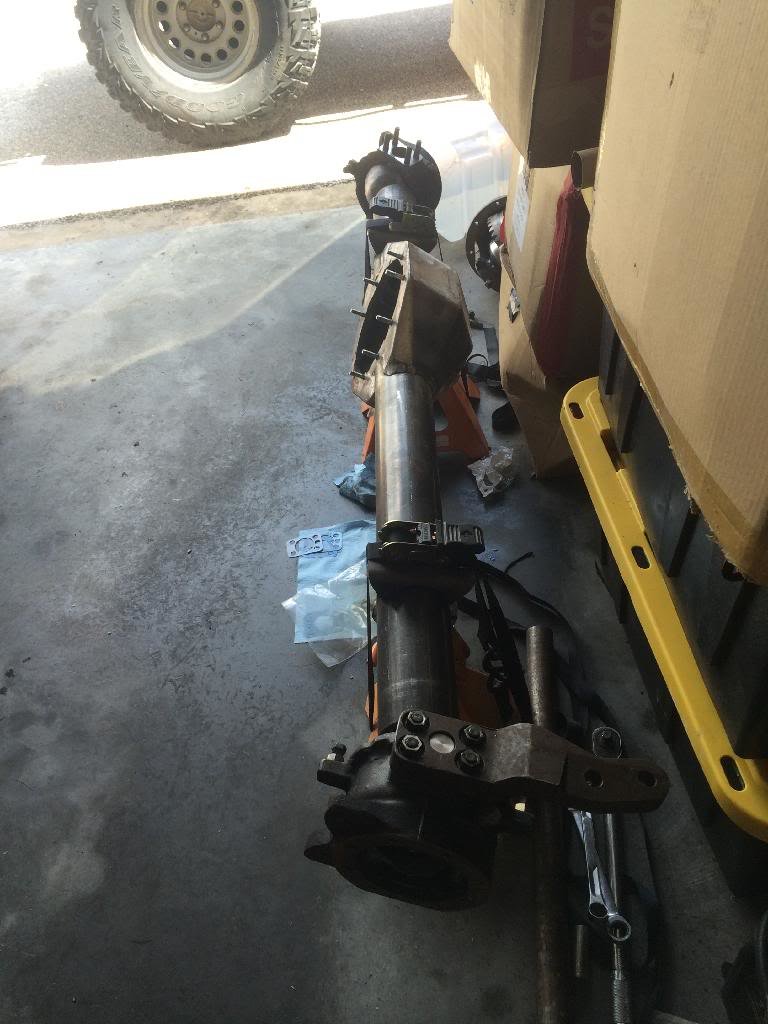

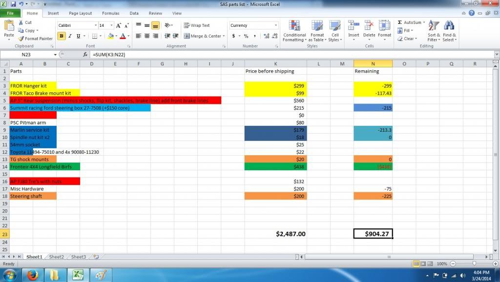

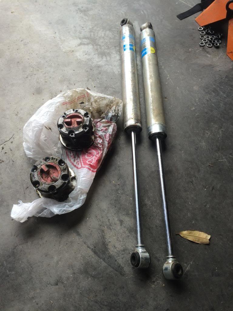

    Went over to the storage unit today to drop off my steering shaft u-joint, my new manual hubs, and a set of free bilstein 12's I got from a friend. Also wanted to get the knuckles, spindles, and these manual hubs soaking in some purple power to get them a bit more clean.
    The FROR hanger kit should be shipping this week.
    I'll be buying the correct steering box in the next day or two after summit finally refunds my money.
    After that, I'll have under $1000 of remaining parts that I need before I can start cutting.
    I removed the AP shock hoops from my list. They probably won't work due to the location that my steering box will have to be in. I'll just grab some cheap tube and bend up my own.
    Also, considering I found a power steering fluid that will work in both my stock power steering pump as well as the ford box, I won't be needing the PSC pump kit.
    I just need to source the proper conversion lines.
    Couple crappy pics for proof.
    Will update more when I have more parts.

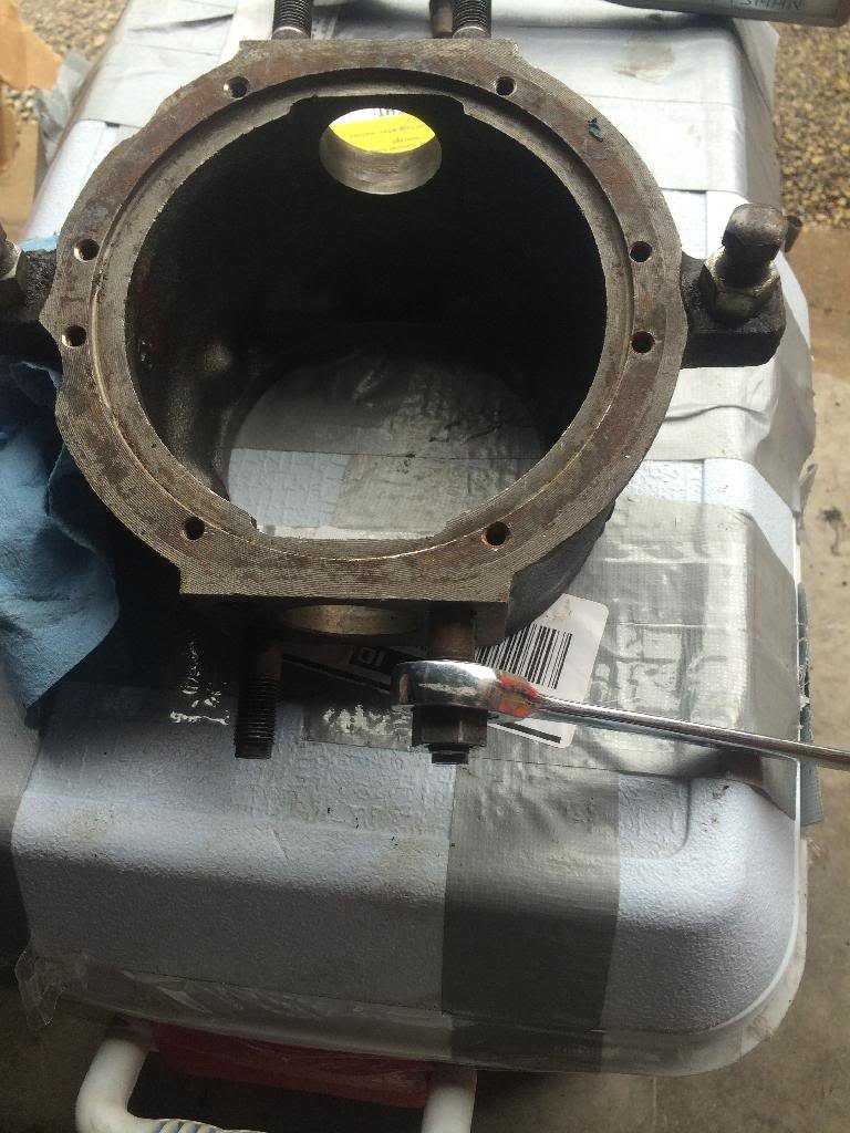

    Finally fully cleaned up the knuckles, spindles, and manual hubs.
    Started prepping to get the knuckle bearing preload set up.
    The Marlin Crawler 25MM lower caps have their own hardware, so I pulled those studs out of the knuckles. No biggie.

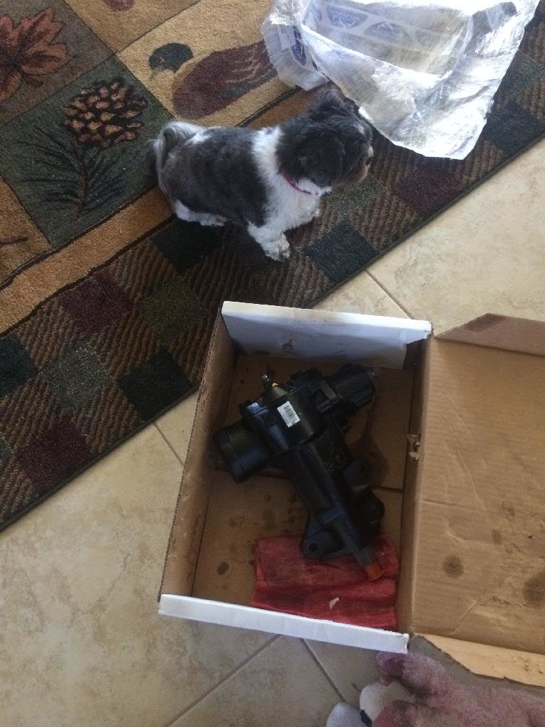

    Today I got the steering box, the FROR hanger kit, and the fitting for a high pressure line on the pump. This gear box is HUGE!
    Also found out I need to exchange a u-joint for my steering system from summit. (Wish me luck)
