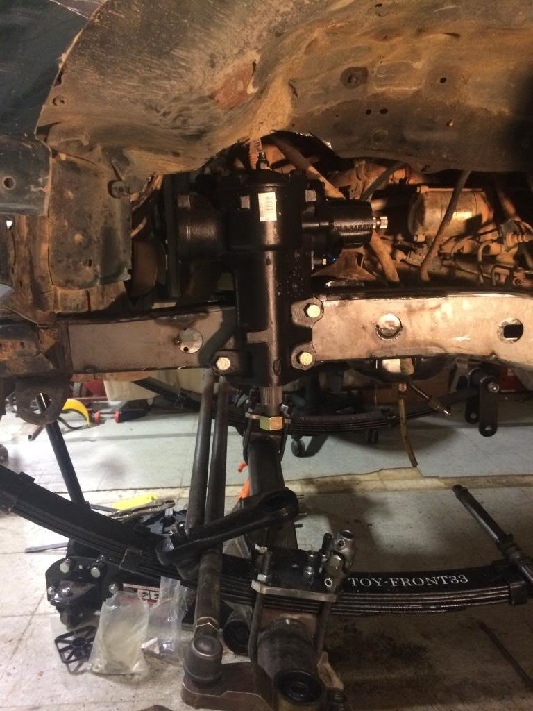

    Steering box is mounted, just gotta finish welding the brackets.

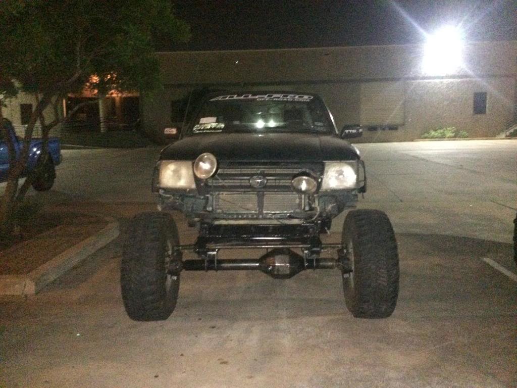

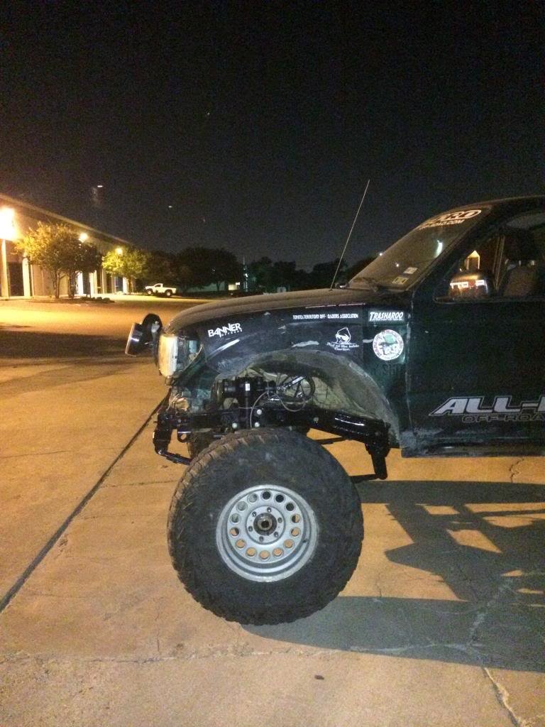

    The front is "done." I still need to put the inner shafts/ birfs in, weld the steering stops on, and a couple other small things. I drove it out of the shop and got it up to about 50. I've gotta get the toe set a little better but everything is working pretty well.
    I was hoping to get the center of the axle about 3" forward of stock. I measured everything and the axle ended up 7" forward. I've got a 111.5" wheelbase with an 80* approach angle. :O
    Working on the rear suspension right now. The truck should be 95% by tomorrow evening.

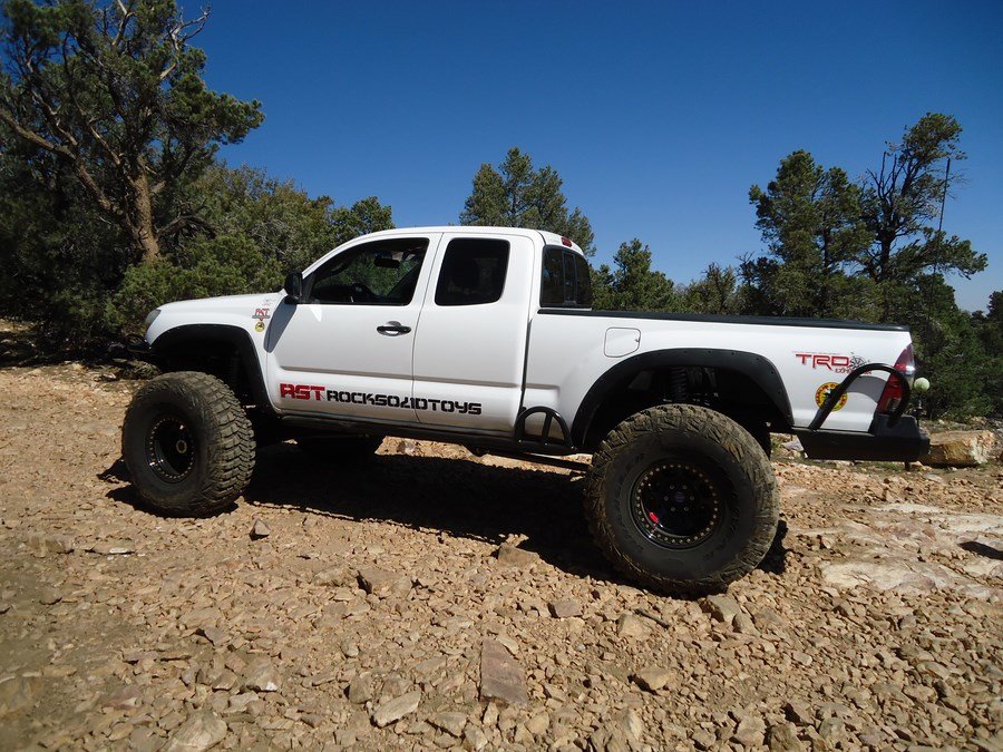

    Yup! Those slider boxes are awesome. Wish I knew about them for my old truck. You can play with truck heights by removing leafs to a certain extent or running the shortest shackle possible. My last Tacoma had the shackle under the frame and I got it to 24" to the frame on 37's by messing around with leaf combinations/shackle lengths.

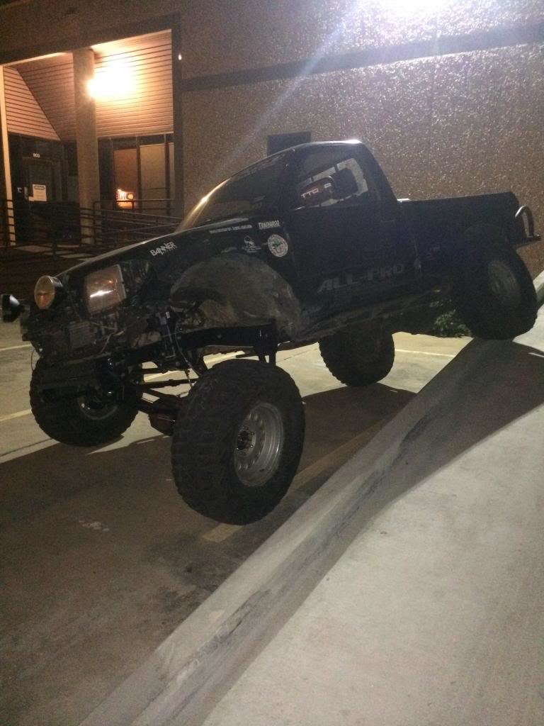

    I got to take the truck home from the shop tonight.
    It's slightly bouncy without shocks. Needs a steering stabilizer. Wanders a bit at speeds of 50 and over. Otherwise, everything is great. I need to triple check my toe which I thought I set at 3/16's in. I'll get some pictures tomorrow morning. I did the math and I was at the shop for a grand total of about 50 hours!
