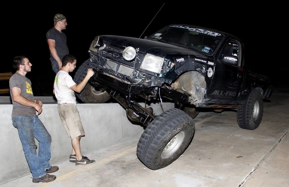

    Lol that'll be pretty impossible. I'm planning for Moab in the l late fall and AZRocks next March.
    It's a possibility. After I get shocks and a steering stabilizer I think I'll be a lot better off.
    It's all good.
    I think he meant that in the sense that project vehicles are never really "finished". They're always evolving and changing. And he's right, in my case.

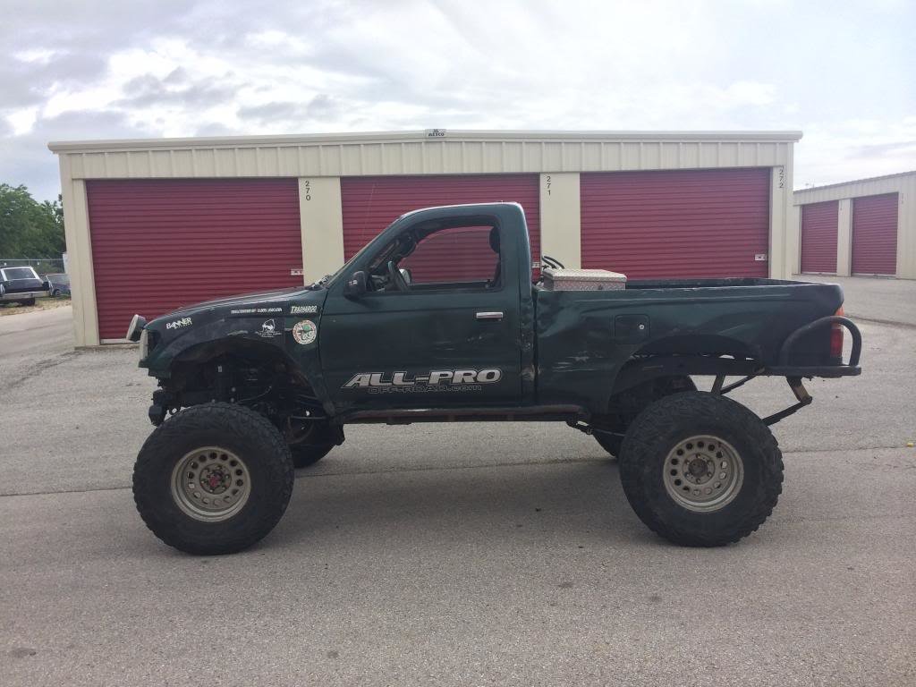

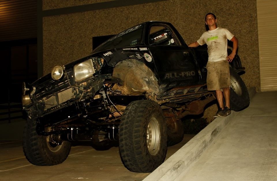

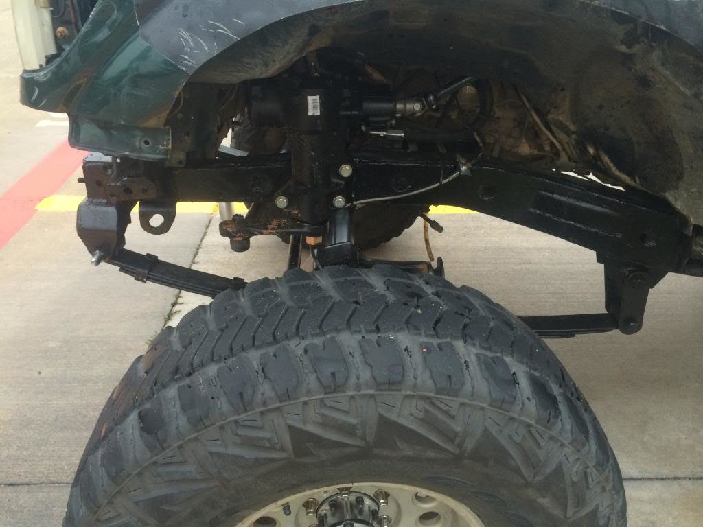

    More pics.
    In this first one I'm loaded down with all the old IFS, the front bumper, fab gear, etc. The rear was sagging a little bit.
    Unloaded
    These two were right after we finished the front and right before we started on the rear.

    Sweet mother of flex!!!
    She'll be a beast on the trails for sure man. Great work, awesome to see you whip something this extreme out so quickly. Respect!

    where did you get that sweet invisible drive shaft ;)

    Lexan has been around for ages brah

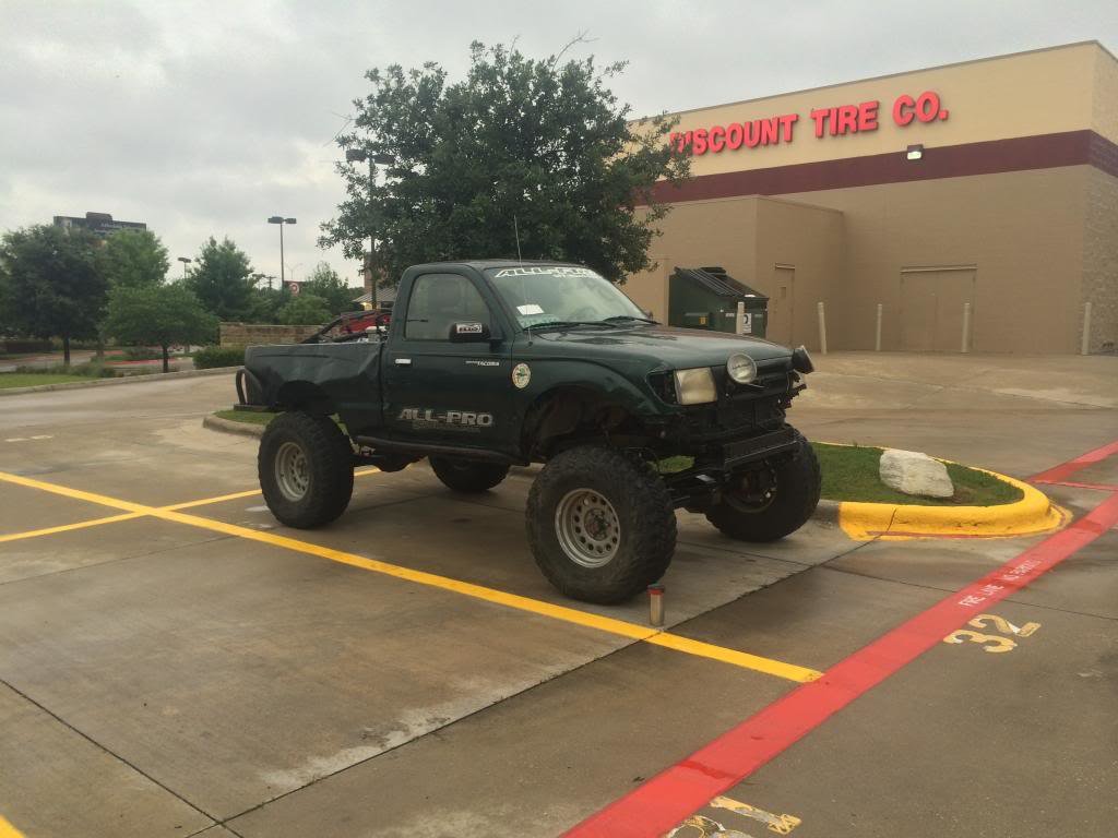

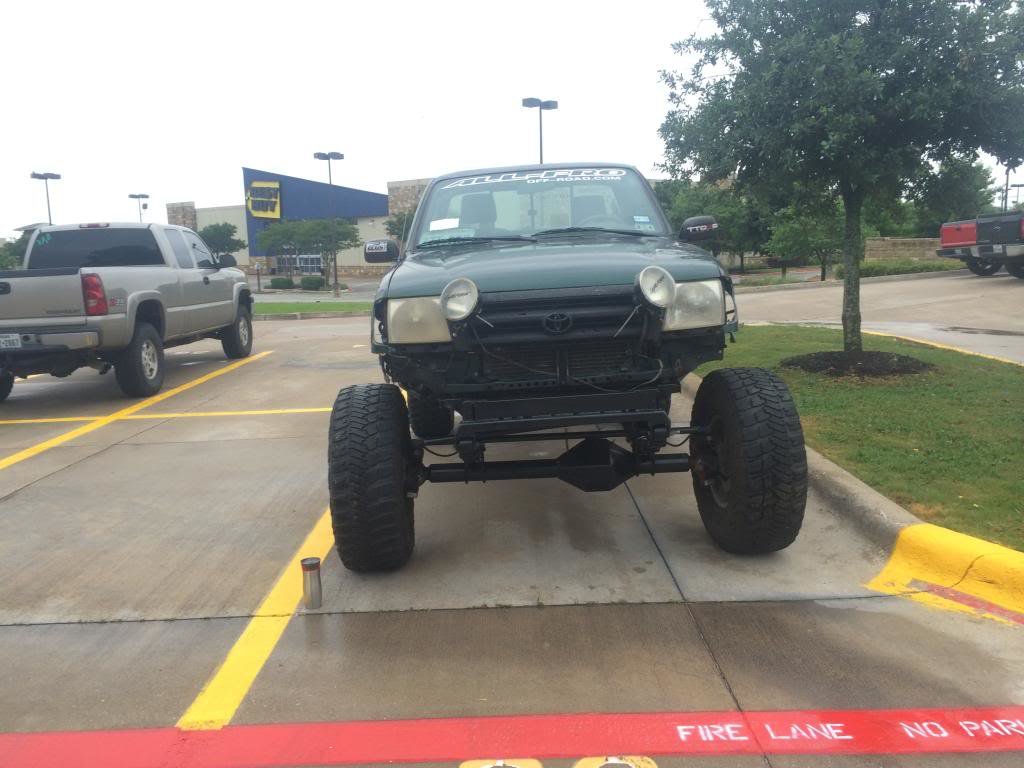

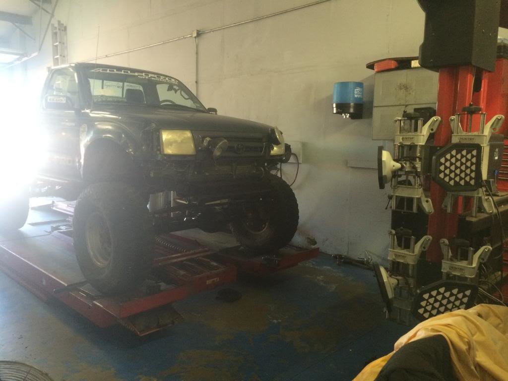

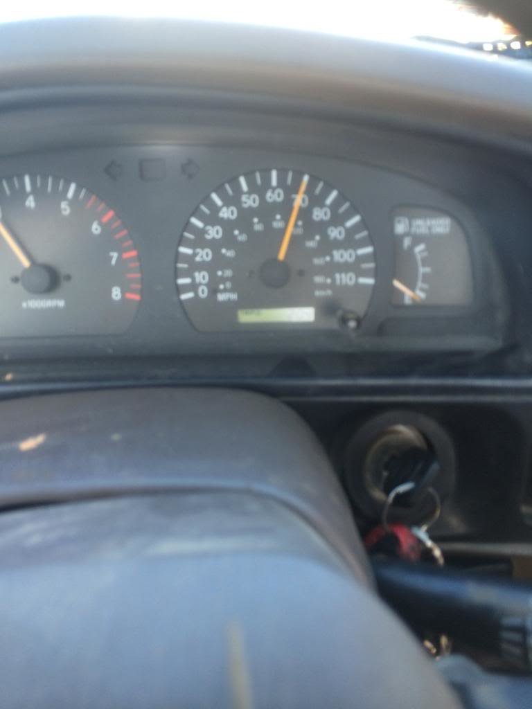

    Got the truck aligned today. I knew it looked funky. I thought I set the toe at 1/8" in but the tech said it was toed out. I think my "floating" Tacoma rotors threw off the measurements some. After the alignment I got it up to 70 with no death wobble and a lot less wandering. The only vibe present is from my rear drive shaft due to a worn slip yoke. The vibe was present before the swap, though.
    And before anyone says anything, I have a full tank of gas. My gauge is broken.

    very nice that rig should be pretty fun now.
    Well done on the conversion :thumbsup:
