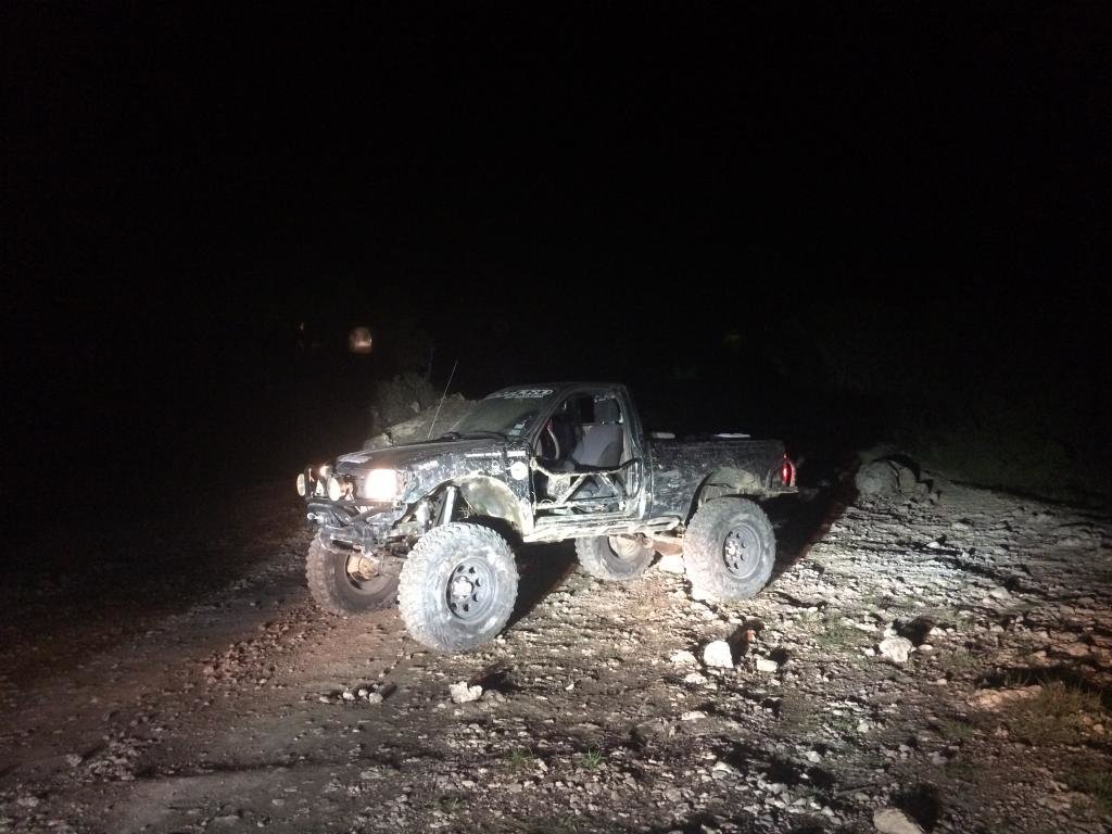

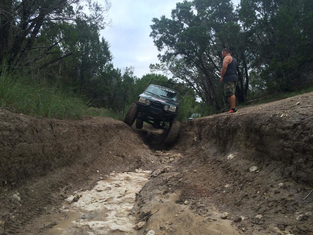

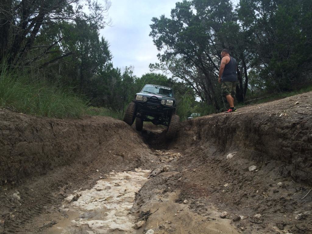

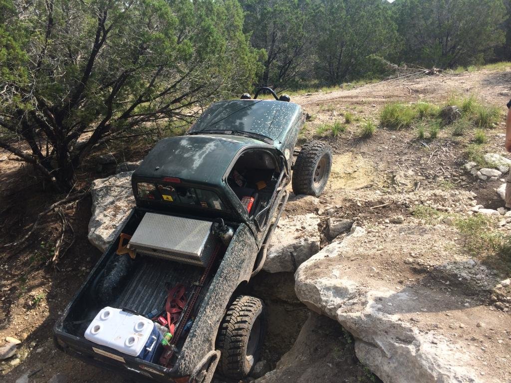

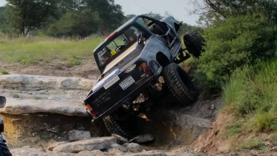

    Got the truck out on the trail this weekend at Hidden Falls. It did great. Flat out works. I thought I'd have a really tough time with 37's and no crawl box but it was fine. I still want to get one put in before Moab in September.
    Not a whole lot of really good pictures, but here they are:

  4. Jul 20, 2014 at 7:43 PM
    #164
    avw4x4
    avw4x4 Well-Hung Member
    Oct 20, 2013
    #114886
    2,414
    (M)Andrew
    Rochester, NY
    2003 Yota
    ...loading....
    :drool:
    What a beast man! Looks like a blast!

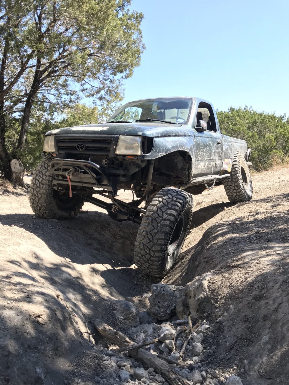

    It's seen its fair share of miles since I made the last post. A few modifications, a trip to Moab, and plenty of wheeling here in Texas.
    The 37" goodyears lasted all of 20K miles. My rear end being welded definitely didn't bode well for longevity. About a year after the swap I tossed the cragar steelies and put on some Pro-Comp proxy series 45 alloy fake locks. They were 20 pounds lighter per wheel than the steelies and that helped a lot for acceleration and power, especially on the highway.
    I am now sitting on 40" Coopers.
    I now have a crawl box with a 4.7 low range gear. I bought a brand new rear driveshaft from Tom Wood's when I put the crawl box in. That way I didn't have to worry about driveline vibes. Works great. I really enjoy the crawl box. I feel like it took the truck to the next level.
    I also moved the shackles on the front end further forward about a year after the original SAS. The shackle angle was really steep originally and the truck was really tall at first. That dropped it a good couple inches. It looked way better and way more proportional.
    This was about 2 years ago now. I think this was my first trip right after the crawl box. Still getting used to not slipping the clutch to crawl.

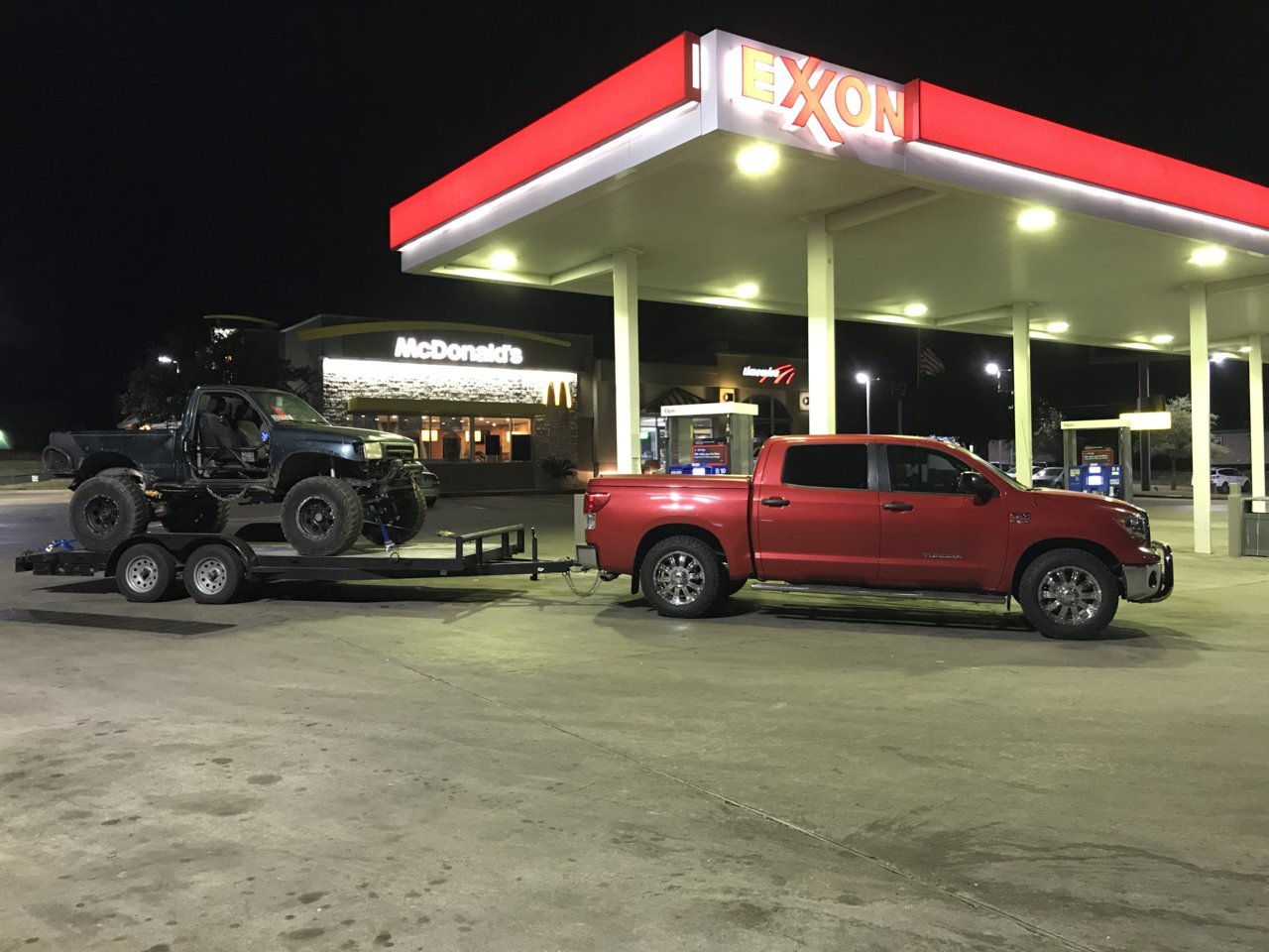

    Fast forward 6 months after that I bought a house and a Tundra. I borrow my friends trailer from time to time to tow the truck wheeling.
    December 2017 first time towing with the Tundra.

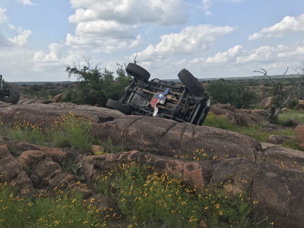

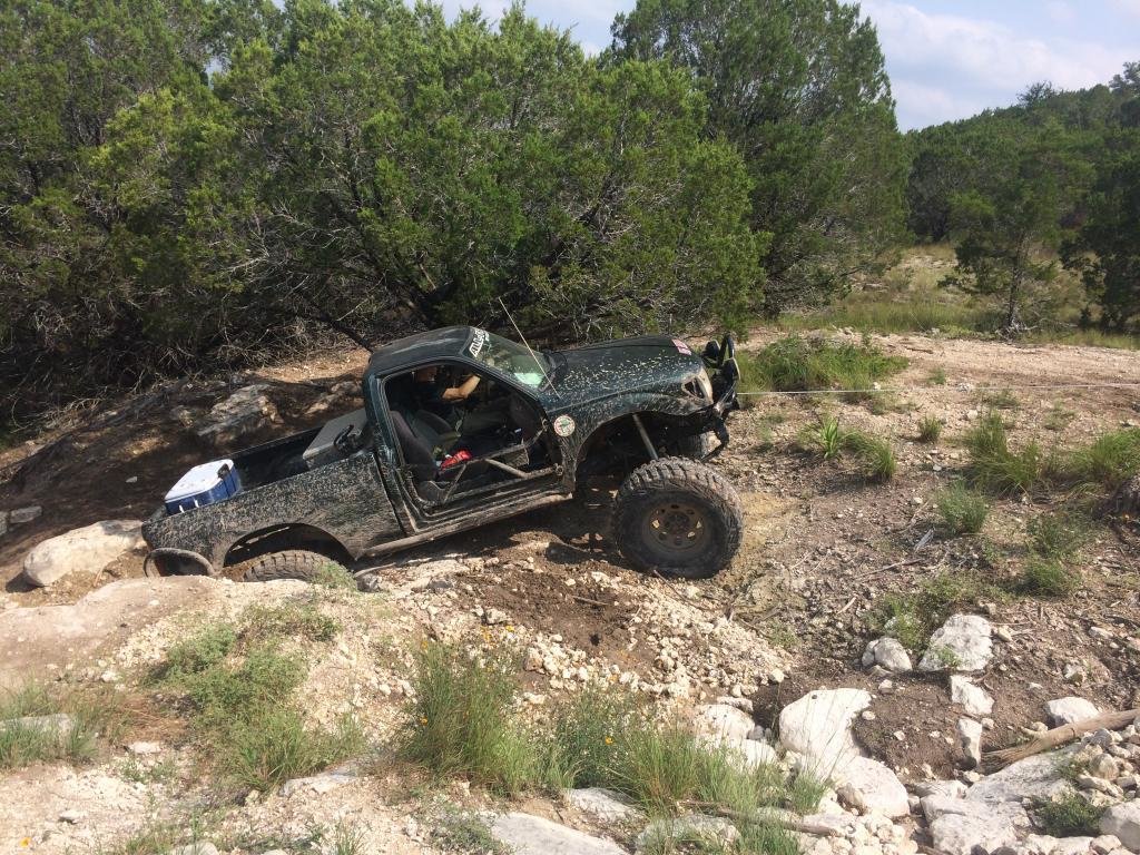

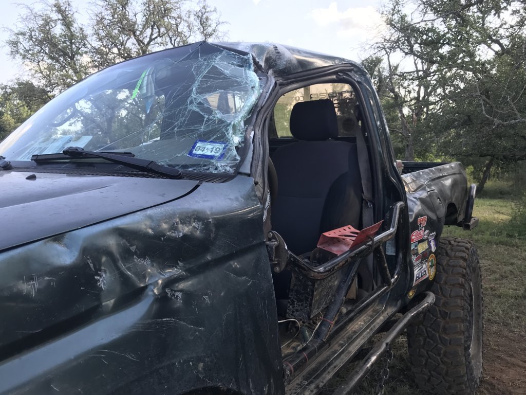

    This past memorial day I rolled the truck at Katemcy2 in Mason. The damage was much worse than my previous flops. I walked away without a scratch. Pulled the plugs, blew the oil out of the cylinders, and drove the truck 2 hours home.

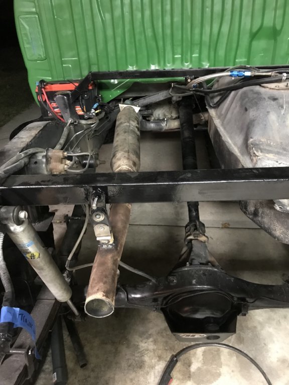

    Cut the floorboard out so I could pull the dual cases with an engine hoist and re-seal them up.
    I got the new cab painted and had a bunch of friends come over to help me swap it.
    Putting it back together.

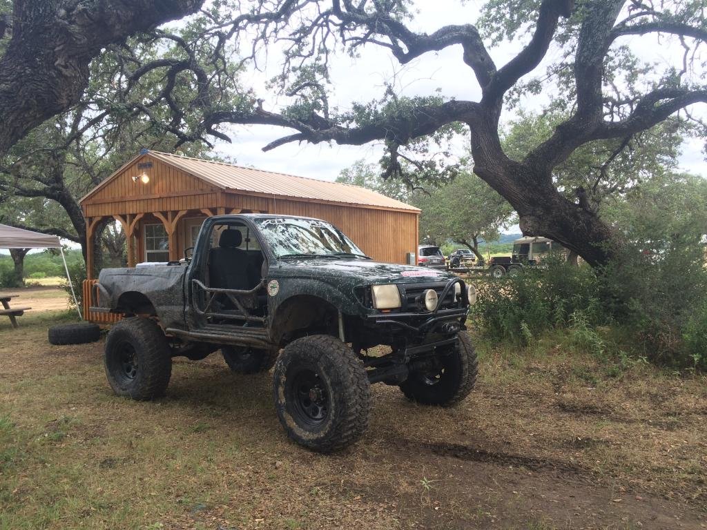

    I've always wanted a tube flat bed. After killing the bedside from the flop I cut the bedsides off, moved the gas tank up and to the other side, put the battery in the back, and moved the exhaust to the other side.
    Fired her up for the first time after the cab swap

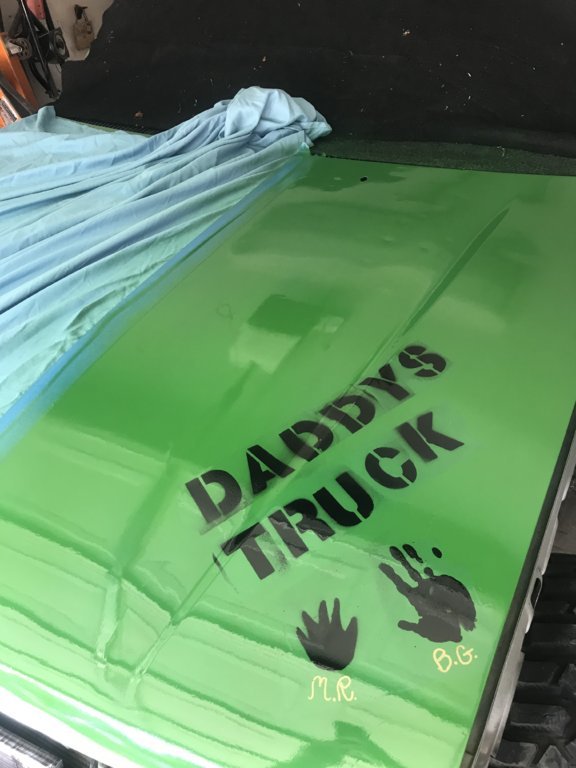

    New color is John Deere Green.
    Added a personal touch to the hood.

    That's pretty much how it sits right at the moment.
    I got a PSC pump kit and a rogue fab tubing bender for christmas because this truck really needs a cage. Fenders should be painted within the next few days.

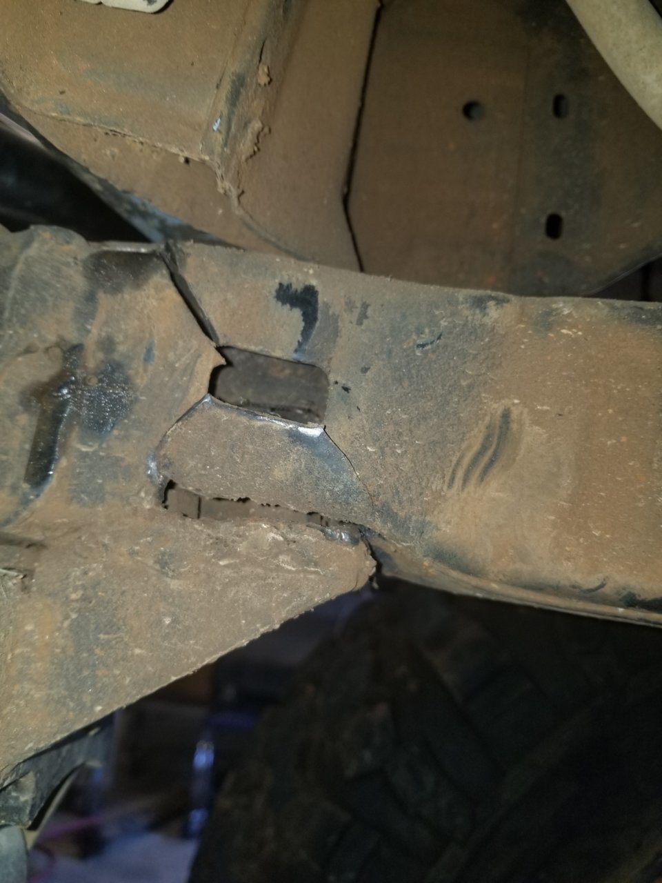

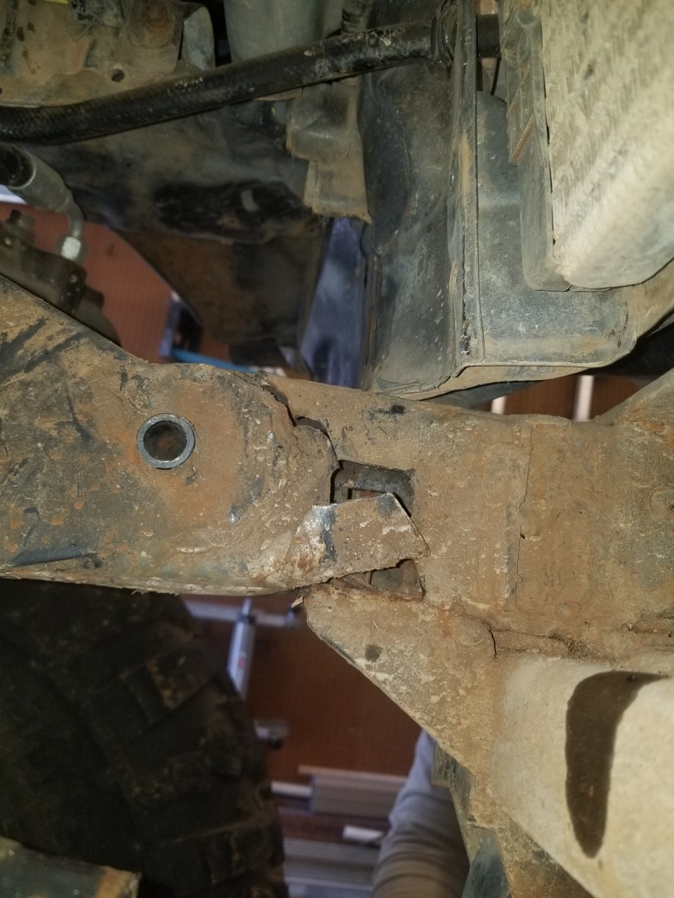

    looking good Steve! When you did your cab swap, did you notice any cracking in the frame? Mine was hidden by radiator.

    I found the same cracking back in 2015, about a year after the swap.
    Managed to weld a fish plate over it with the radiator still in the truck. Mine wasn’t as bad as that though. Just the 4 cracks coming from the edges of that rectangular hole.

    We welded up the cracks and plated over it. Also plan to but off the body mount and reinforce the outer frame as well. Time will tell if it will hold.

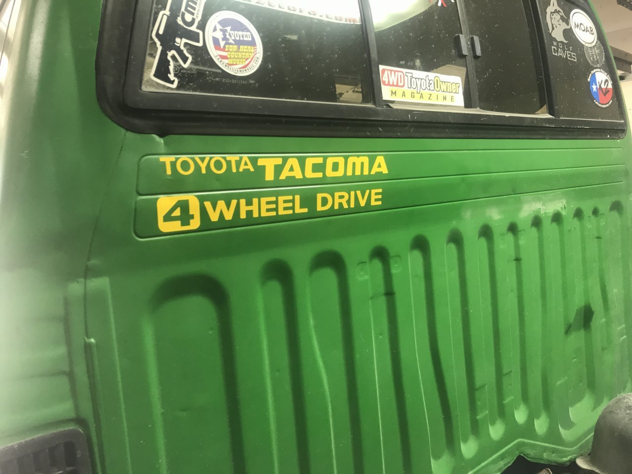

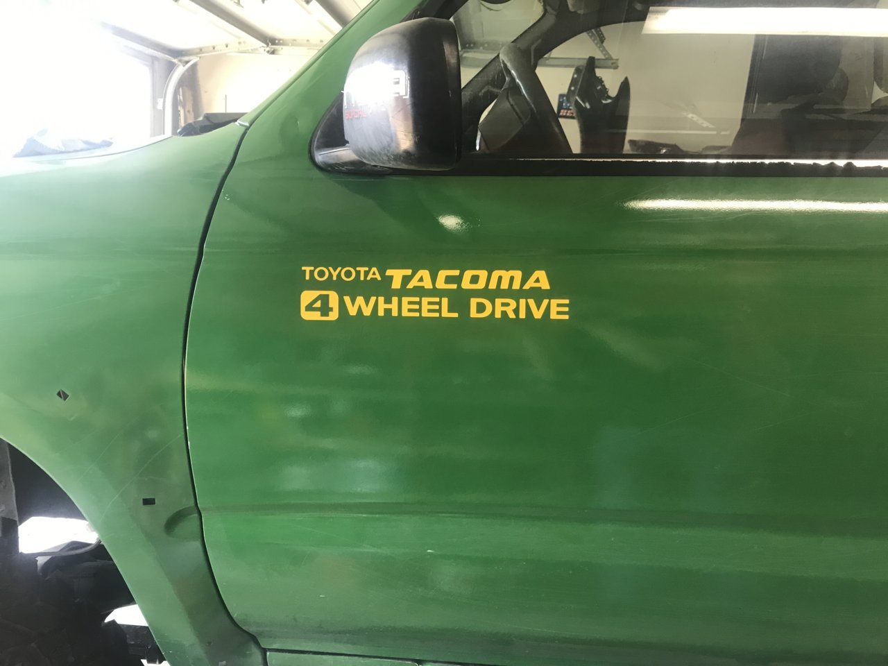

    Also finally got the chance to get my decals put on. I had a friend of mine copy the ToyotaTACOMA logo that is normally stuck to the doors and tailgate. I wanted the same font. Came out great. The yellow looks awesome on the green. Looks more military than farm implement.
