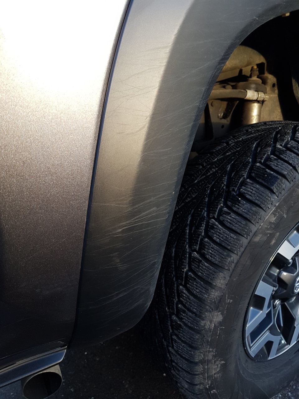

    Got some scuffs on my fenders already. Can't feel anything crossing my fingernail over them so it's not a deep scratch or anything. Any advice on buffing them out or diminishing the look?
    Edit: Referring to the black plastic fender flares on ORs

    If they are so light that you aren’t feeling them with your finger, but you can see them, you may want to get some 303 protectant. It may make them a little less noticeable. It’s awesome stuff for any black plastic parts of your truck, because it restores, and UV protects the black color. It’s like armor all on steroids

    Hey Joe, if you're gonna off road in brush then can't do anything about it. If you want to fix it, sand with 3,4,5,600 wet sand and spray with Duplicolor Bumper and Trim paint in clear, that stuff is pretty good, did an 03 Taco and came out perfect.....don't sand too deep don't know what color is under, or color match then the clear. Should look good......

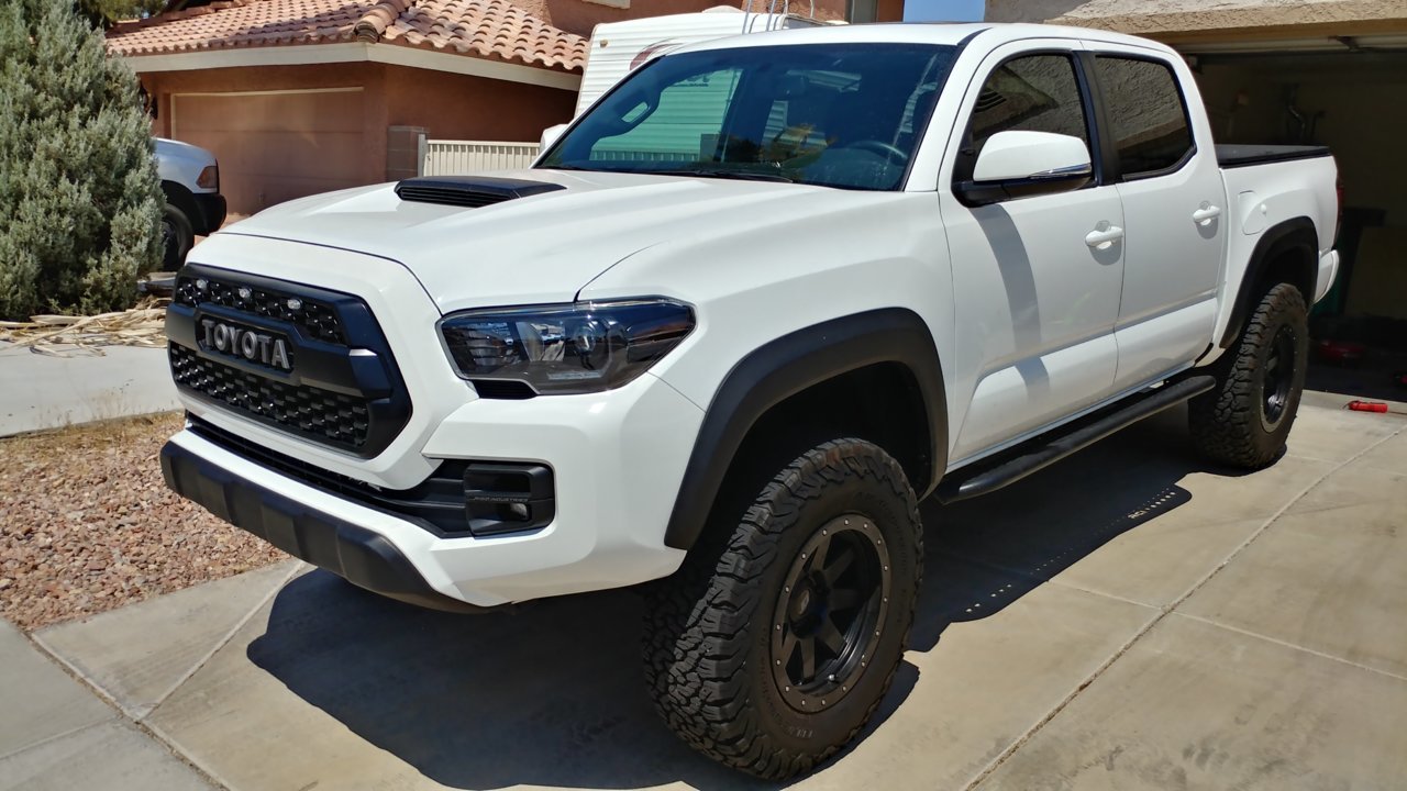

    2016 Tacoma DCSB 4X4 Manual
    Front suspension : Extended travel Kings with Total Chaos UCAS Rear suspension : Deaver progressive AAL w/out overload & Kings Rims : SCS SR8 17" Tires : Bfg KO2s 285/70/R17 ARB Compressor ARB Lockers front and rear with 4.88 gears Nitro 4.88 Gears TRD Pro Grill, and fogs Headlight BHLM Rigid Radiance 32 stealth mounted.
