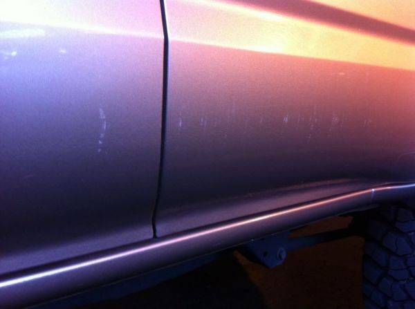

    Ok, so basically the car I park (I should say parked, I asked for a different spot. :rolleyes:) next to at my apartment complex has opened his door into my doors multiple times. By multiple, I mean about 30+. Yes, I counted the scuffs. Anyways, there are no "dings" fortunately, just the paint scuffs. Will these come out with a wax or anything? Or should I confront this guy that obviously has no respect for other people's property and make him pay? Just because you drive a shitty 1992 Ford Taurus doesn't mean you can repeatedly open your door into mine. Motherfucker. Anyways, can I even do that (ask him to pay for the damages)? Any advice would be much appreciated. Sliders are in the works! :D
    Best I could do for now. This is all from the same person. Looks much worse in person. I will get more pics in better light tomorrow.

    Wash, Clay Bar, Polish and Wax. I had something similar and I used Meguiar's Ultimate Compound for the polish step and it took it out. It didn't work on the fender flares but worked on the paint. If simple detailing you can do by hand doesn't work, I'd make the dipshit who did it pay. That crap pisses me off.

    Yea what pugga said..
    I usually just use a rubbing compound then follow it up with a wax.
    You gotta know that it is not gunna just come out. You gotta use some elbow grease.

    Sliders to prevent future damage. Turtle Wax rubbing compound to remove past damage.
