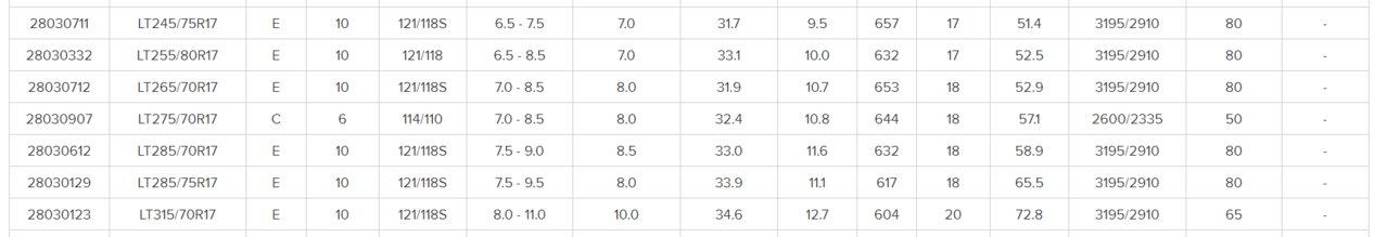

    To be honest your wheel choice is the biggest hurdle
    ^ Pulled from Falken's website.
    The only size in the at3w that'll fit to a 9" wide wheel is the 285/70R17.
    (285/75R17 and 315/70R17 both fit the wheel but those are ever bigger tires)
    That wheel is wide and a low offset, you're going to need to cut the rear fender well area and most likely get a cab mount chop to alleviate the rubbing.
