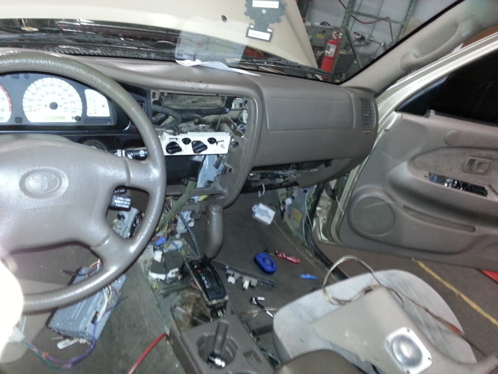

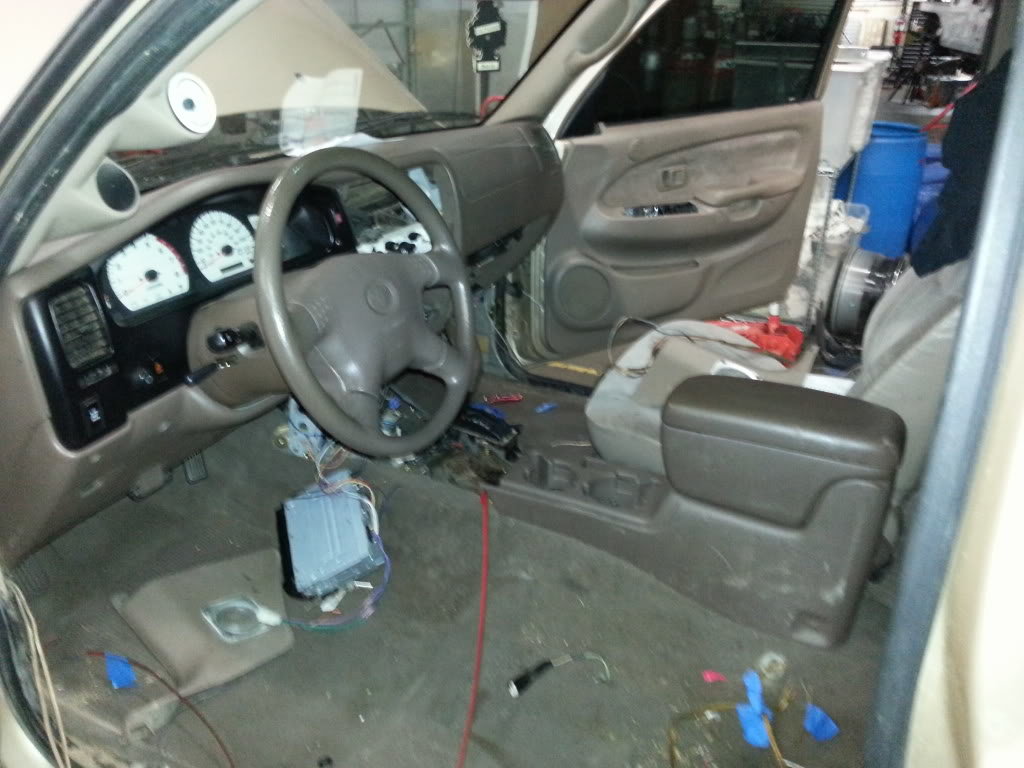

    Build update:
    Spent 6 hours fixing the stereo last night. Previous owner had a serious rats nest of wires through out the cab running to an amp that stopped working. All fuses checked out fine but it would not turn on with the key on. Even tried jumping the signal wire to the constant hot wire so it was wired direct. Nothing. So I removed the amp all together and wired it straight to the deck. Works like a champ now! I also found out the interior is fully dynomatted while I was pulling interior panels.
