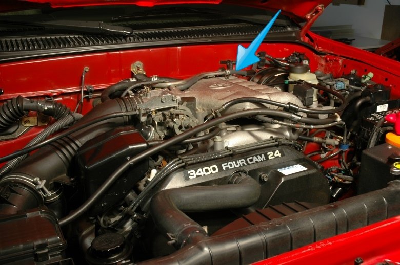

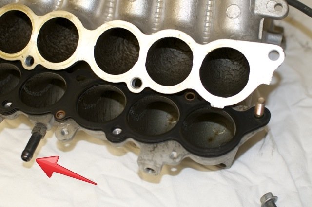

    On the 3.4, running an intake cleaner thru the brake booster line will reach only one cylinder, no more no less, red arrow below.
    Best to use the PCV port or better still the line from the charcoal canister.
    This is the best line to use on the V6.

    @Dirty Pool is right, the brake booster line wont reach all cylinders! Just take a look at it and youll see why. Use the pcv, youll see that from there all cylinders will be feed! It enters just after the TB instead of down further in the intake like the brake booster.
