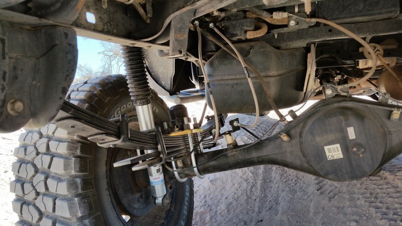

    It's been a thousand years since my last update, but nobody cares. Let's not kid ourselves...
    Anyways, she's had some work done recently. Here's the list of maintenance/upgrades that have been going on for the past few weeks.

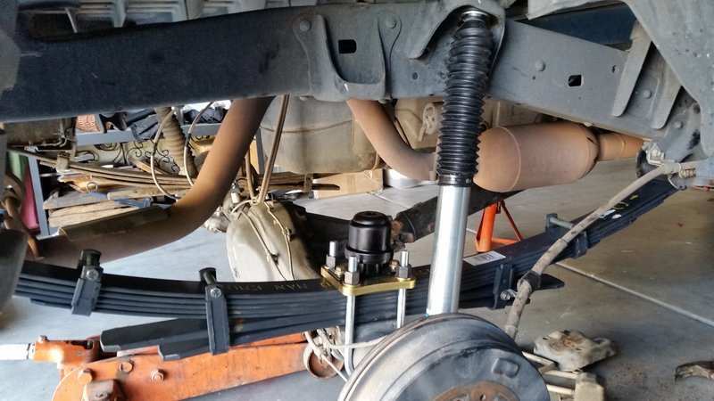

    • Removed AAL and factory springs, and installed Dakar leafs with poly bushings in all leaf eyelets and in shackles
    • All-Pro u-bolt flip kit, drilled and read for Wheeler's bump stops
    • Added Wheeler's Super Bump stops on all 4 corners
    • Went with the longer rear Bilstein 5100's (B110 model) for more downtravel
    • New front 5100's, kept the same 886 coils because they are holding up so well
    • Upgraded to the new Light Racing upper ball joints that now have a grease zerk and new design
    • Added LEDs to my ARB awning
    • Replaced both top shock mount kits (old rubber was destroyed, and shock top eyelet was worn)
    • Valve cover gaskets, plenum gasket, and plug seal gaskets finally replaced
    • PowerStop drilled/slotted rotors with ceramic pads
    • Extended front/rear braided steel brake lines
    • Brake fluid total flush
    Last year's fixes:
    • New LCA bushings
    • New driver's side LCA
    • New CV's
    • New inner tie rods
    • Diff and transfer case fluid replacement
    • Partial transmission flush (40%)
    Fixes remaining within the next month:
    • New steering rack
    • New outer tie rods
    • Power steering flush
    • Transmission mount
    • Install gas tank skid (need to get Off Road gas tank straps with studs to mount)
    She runs like dream again, with power restored. The ride is so much smoother, and downtravel/flex in the rear is much better than before.

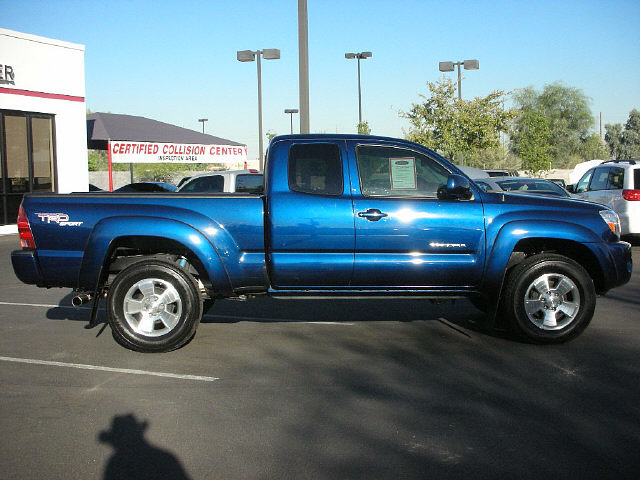

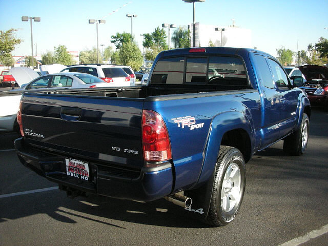

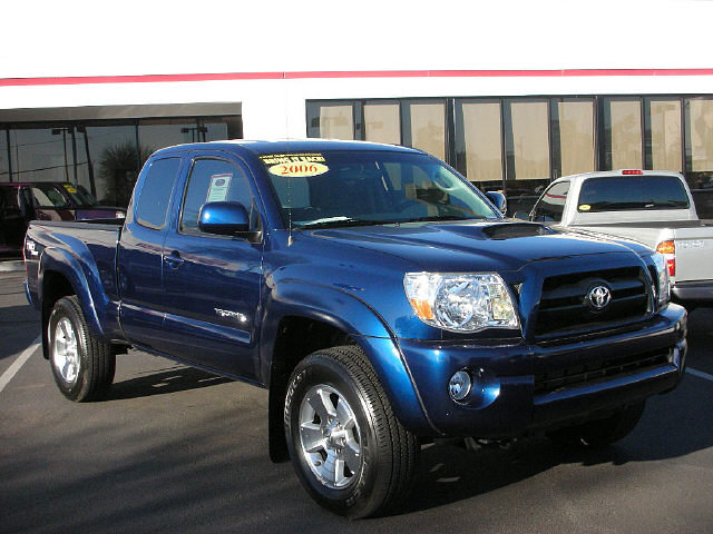

    Wow, I actually found the pics of my truck at the dealership when I first bought it. I thought I lost these long ago...

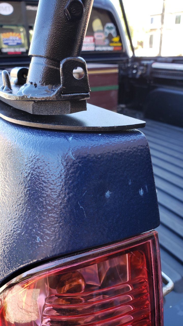

    Unfortunately, I got in a hurry to mount the bed rack by myself for a camping trip and I whacked the back left corner of the bed. Ouch! It hit hard enough to dent the metal but it only scratched the coating. My paint guy said if I ever need, he saved the mix formula and could make me a small cup of this stuff and it's really easy to touch up any dings like this with a small brush. Once the hardener is mixed into the blend, you have about 30 minutes to apply it but he said he could do it on the spot for no charge.

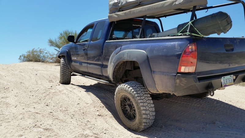

    Luckily I've been camping and backpacking a ton, but not with you guys. I've been to Overland Expo every year but I've camped onsite with other friends. We like walking around the show all drunk and whatnot and not have to relocate.
    Desert camping season is upon us though. I've got some AZ Trail hikes in October and early November, but I'm always game to set aside weekends for truck camping, too.
