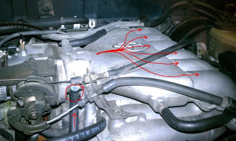

    im dumb (and a bit lazy beacuse everyting and anything i could want is already on the interwebz) but i would like someone to point out what vaccum line to suck seafoam into (preferably a picture) for a 98 3rz-fe, also, any other info would be appreciated.

    The one coming out of the brake booster - that black circular thing on the firewall in front of the driver. Unplug the line going into the booster with the motor on, put a small screwdriver in the throttle body lever to keep rpms around 2000 rpm and then SLOWLY feed the Seafoam into the line via a small funnel of small cup.

    don't use that hose! it only feeds one cylinder...at least on the 3.4's...theres a hose between the TB and intake plenum (I think it comes from the pass. side PCV) use that hose. It will feed all the cylinders...again for the 3.4's, dunno about the 2.7's...

    Use this hose

    That's the one I did. If you take your throttle body off you will see the hole from that hose is directly behind the throttle plate and will for sure feed all cylinders
    I think it feeds only two on the 2.7 but not sure.
    my question is are you supposed to put your foot on the gas while you pour it in ?(don't let the vacuum hose suck it in from the bottle)

    no need to increase the throttle. the vacuum from the hose alone will be enough. just pour it in the hose slowly

    any pictures of the line to use on the 3.4?

    this pic is from another forum but you'll see why not to use the brake booster line as it only feeds one cylinder...this hose connects from the PCV

    I used a bottle for the vacuum hose that goes to all cylinders as indicated in this forum - that was excellent advice, by the way. I like the idea that the sea foam will reach all cylinders via the intake - not just one.
    And aerosol (harder to find in Sea Foam) for the air intake side of the throttle body. The seafoam aerosol comes with a long red nozzle so that you can open the butterfly and spray into the IAC port. I am still debating about taking the throttle bottle housing completely off so that I can give the IAC a more thorough cleaning - the Toyota pickups should start with one crank rotation of the engine. At least the 22RE did.
