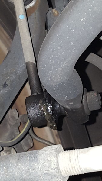

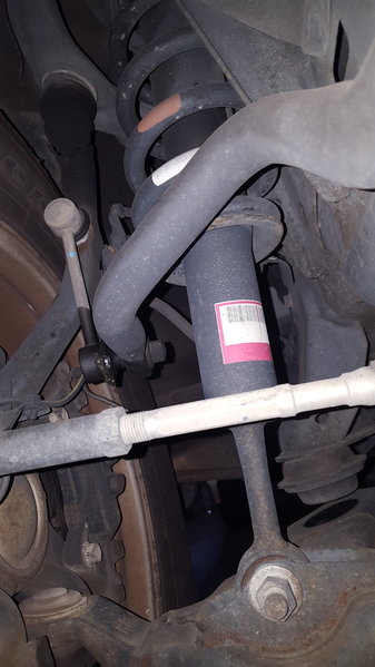

    What is the name of this part and how concerned should I be? The pictures are the front passenger side. I don't know much of anything about suspensions so bear with me. I also posted on 4runners.com but there's not much traffic over there. Thanks for any help. 2016-08-06 10.19.29.jpg 2016-08-06 10.19.38.jpg

    sway bar link

    That small grease leak is minor, it will cause the link to wear faster, but it's not a big deal. There is a small ball joint inside that requires lubrication.
    The sway bar when worn causes clunks over bumps. It wont cause tire wear or vibrations. All it does is connect the left front knuckle to the frame and to the right knuckle to increase stability.

    I'm no mechanic... but I don't think that sway bar joint "leaks". It's just really, really well greased it appears.

    That won't cause a vibration, if anything, if it's really worn out it'll make a clicking/clunking noise. If you're having vibration issues you should have the wheel balance checked.

    That bar is cheap and easy to do. Better replace it.

    Spring Hill, TN
