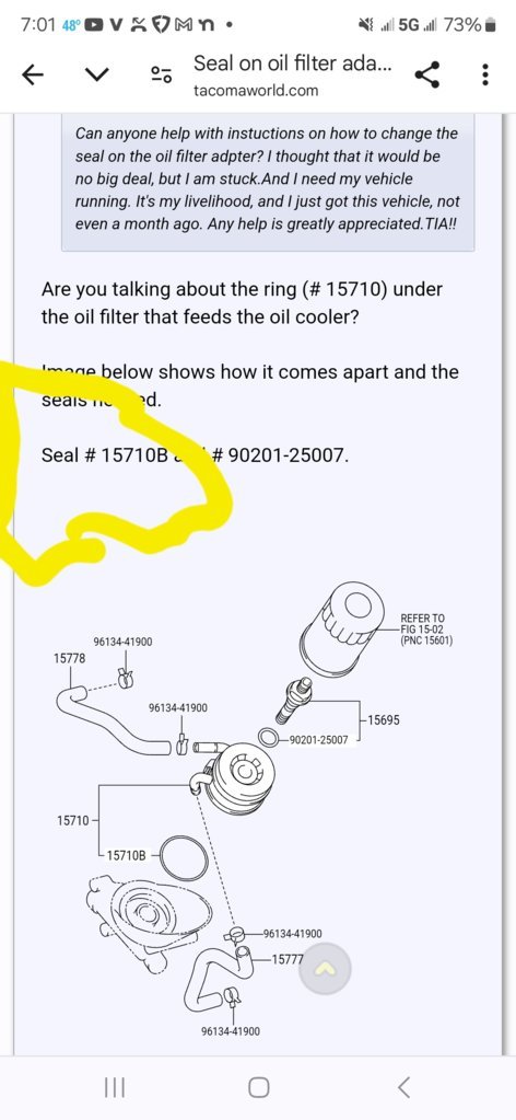

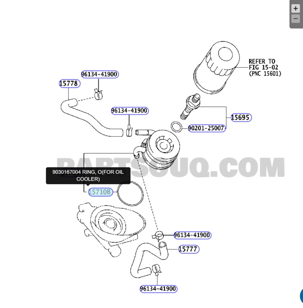

    Are you talking about the ring (# 15710) under the oil filter that feeds the oil cooler?
    Image below shows how it comes apart and the seals needed.
    Seal # 15710B and # 90201-25007.

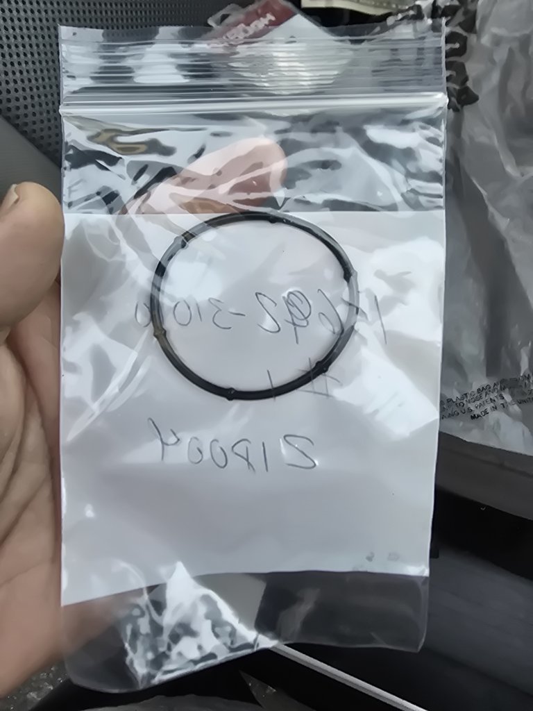

    17377589284682497302052877738951.jpg This is all the seal is. I believe the diagram that the fine sir sent me above. Maybe exactly what I need or is the actual part. But I cannot get this stupid thing off. I'm wondering if I need to take part that has the threads that you actually screw the filter onto, I wonder if that is a nut that I need to remove.

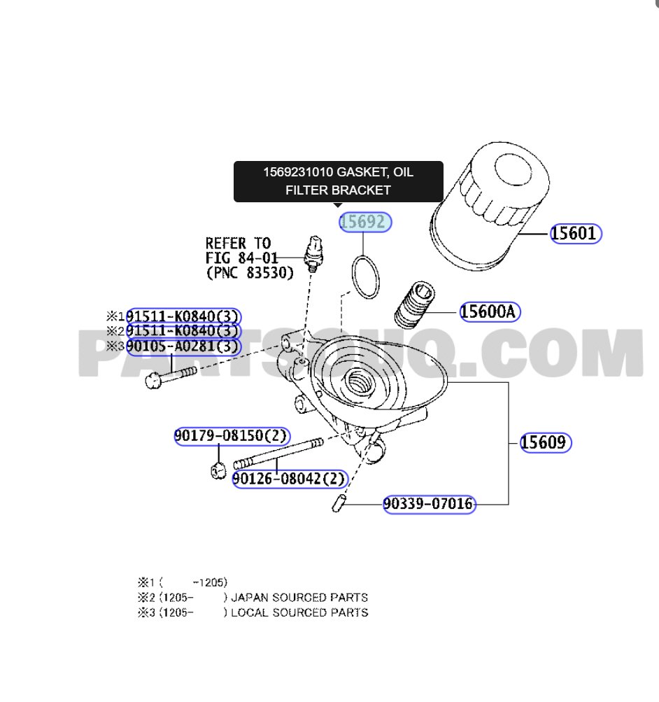

    Now I'm concerned, though, with the diagram that you posted jimmyh. Due to17377593937782141407379588775018.jpg the part number that you have and the part number they gave me is 15692. I think the way they wrote it on here is super weird.

    Looks like the oil cooler gasket to me.
    The number in jimmys diagram is not an actual part #.
    It’s a reference number.

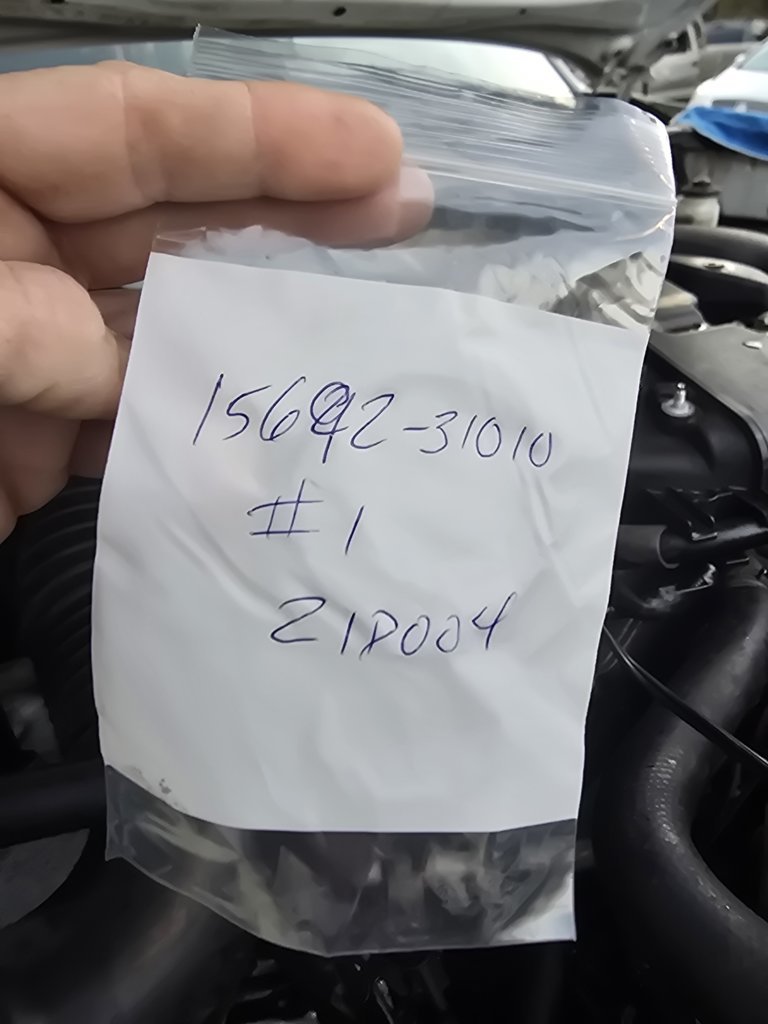

    The number that the guy at the dealership gave me, or he hand wrote it on there. Whether that's accurate or not. I'm not sure, but he handwrote 15692- 31010

    But I do see what you're referring to as well on his diagram, the little line that goes from the the adapter down to the seal, there's a a number on the line, obviously, that's not a part, so I guess you could be right that they are all just reference numbers. I'm not sure.

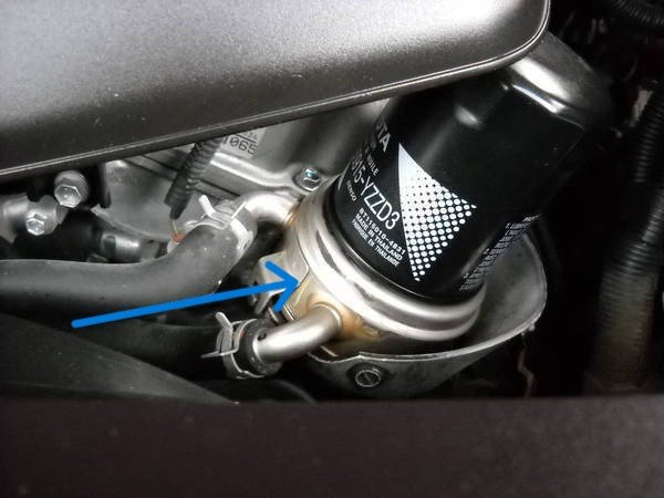

    Ok. Before we get too far ahead of ourselves.
    Does you truck have an oil cooler?
    The thing below. with the 2 hoses on it.

    My data says he gave you the seal for the NON-Oil cooler truck.
    So you would be right. It's NOT the correct seal.

    Damn-it. Is that included in the diagram that you just sent? Or did you look that up somewhere else?
  20. Jan 24, 2025 at 5:02 PM
    #20
    TnShooter
    TnShooter The TacomaWorld Stray
    Sep 2, 2010
    #42625
    21,083
    Deogee
    07' TRD Off-Road, Auto
    STOCK
    Came from the web site in my signature.
    https://partsouq.com/
