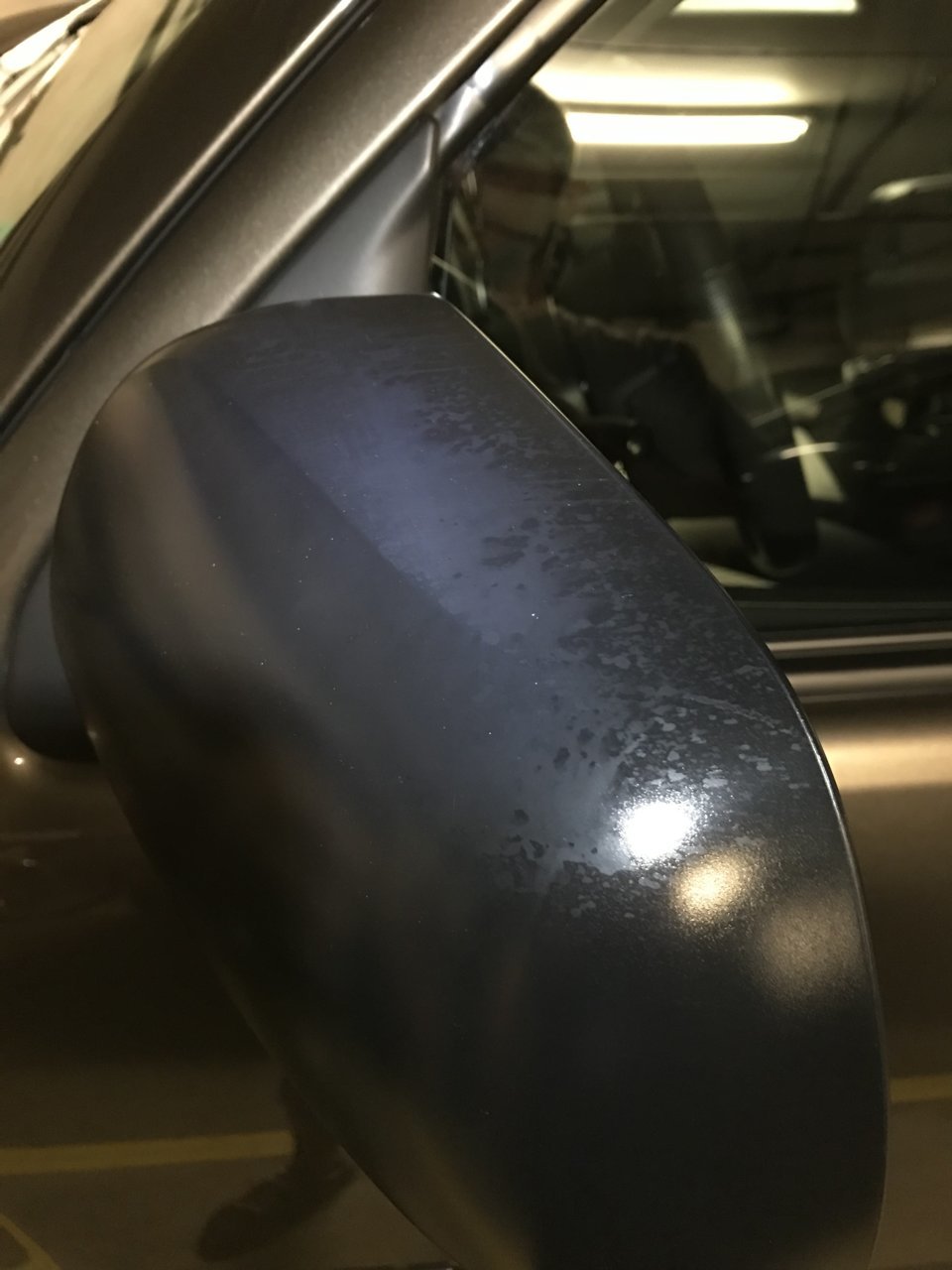

    "full strength" = using all purpose cleaner right out of the bottle. APC is generally pretty strong stuff. And for many cleaning tasks, "full strength" just isn't necessary (i.e. cleaning rubber trim).
    Example: spill a little coffee on your seat, you don't need a super concentrated degreaser/detergent (APC) to get it out. Super concentrated degreaser/detergent might actually cause a lightening/discoloration/staining of the fabric. But SOME cleaner is necessary. So, you dilute the APC. One part APC to 10 parts water, for example. Or 1 to 5. Always use the minimum amount required to get the job done in order to "cause no harm". No hard and fast rules here, just be smart (ex. many "spills" can simply be cleaned with water).
    In the detailing world, it's simply a "safe practice" to dilute APC's for the task at hand. Especially when working on OTHER people's vehicles. You don't wanna damage someone else's vehicle. Chemical cleaning products can be harsh on certain materials and cause permanent damage. Dilute when you can. APC's can be VERY hard on plastics, especially if left to dry in the sun.
    Here's a perfect example of damage that can be caused by cleaning products. I used some Sea Foam Bug Remover to clean bugs off my truck TODAY. I sprayed down the dried bugs on the front of my truck, let it dwell for a couple minutes, then sprayed off with the hose. Bugs came off effortlessly. No scrubbing needed. That's why i got the Bug remover (it's essentially an APC). Success.
    I also sprayed it on my rear view mirrors. But I forgot I did it and moved on to something else. I didn't get it rinsed off in a timely manner, it dried in the sun, and guess what...
    It actually damaged the plastic. Chemical cleaning products are HARSH. They're also very effective when used appropriately. But shit can go south quickly when you're not paying attention. Had this been someone else's vehicle, I'd have been devastated.
    So this is an example of using a very strong cleaning product and not getting it rinsed off in time. Had I rinsed it off in two minutes, I'd have been fine. But 10 minutes and it caused permanent damage. Had I diluted the product, the damage wouldn't have occurred.
    Was full strength product needed? Nope. I probably coulda wiped the bugs off with a wet towel. And now I have shitty looking rear view mirrors. I knew better. I got lazy.
