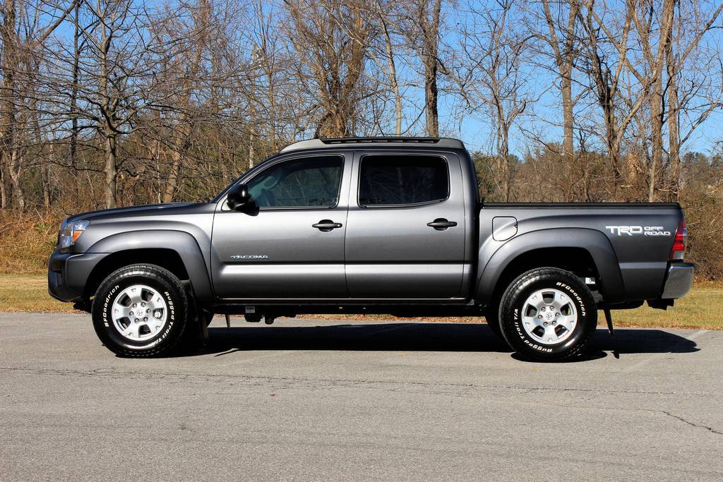

    Here are the steps I did to my paint & trim when I picked up my 2014 MGM DCSB in October.
    1. Washed with Duragloss #902
    2. Clayed with Meguiars Clay Bar Kit
    3. Polished paint with Optimum Finish Polish on a White Lake Country Foam pad & Griot's DA.
    4. Applied two coat of Four Star Ultimate Paint Protection Sealant
    5. Coated all the black plastic trim with Ultima Tire & Trim Guard Plus (prevents fading)
    6. Shined tires with Meguairs Hyper Dressing diluted 1:1.
    When it comes to detailing be sure to take your time. There are a TON of products out there that will give you incredible shine & durability. Most of the products mentioned in this thread are top notch. It all comes down to what you want to spend. I try to hit the sales at Autogeek (20% off & free shipping) when they have them several times a year. Also, when I buy a product & really like it I will but the gallon size next time around which saves a lot of money in the long run.

    Looks good AMarkham!!

    Beautiful color and depth!
