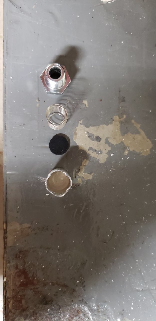

    Does anyone have an actual, definitive, technically sound answer to the question of whether the transmission and diff breathers are one or two way?

    I guess at this point the only definitive statement would be from Toyota engineering. Ok, back to figuring out what suspension upgrade I’m gonna install.

    Inside the silver cup goes the spring, then the seal, then the seal sits on top of the threaded bung. Looks like it behaves like a check /poppet valve to me. But yeah the only real definite way is to ask the engineers who built it lol.
    ETA: the OEM "two way" does not have the same internals with spring etc. Idk if that answers your question

    Ok, here’s the thing, no auto manufacturer/engineer that I know of, would design a lubricated component that would allow contaminants to enter the chamber/diff housing. That would almost certainly reduce the reliability/life expectancy of said component. That being said, it is necessary to allow for heat expansion of gases to escape the chamber, if that makes any sense.
    Or to put it this way, if you take a deep breath and dive underwater, you can spill-out the inhaled air, but you can’t take any air in while expelling said air. Your diff valve is designed to work the same way, more or less.
    Water may however enter the chamber if complete differential axle housing is immersed in standing water for a period of time at either the pinion or axle seals, as they are primarily designed to keep oil inside said chamber. And I mean no disrespect, but having a breather mod is an exercise in futility imo.

    There are membranes which will allow air to pass in BOTH directions while excluding water and dirt.
