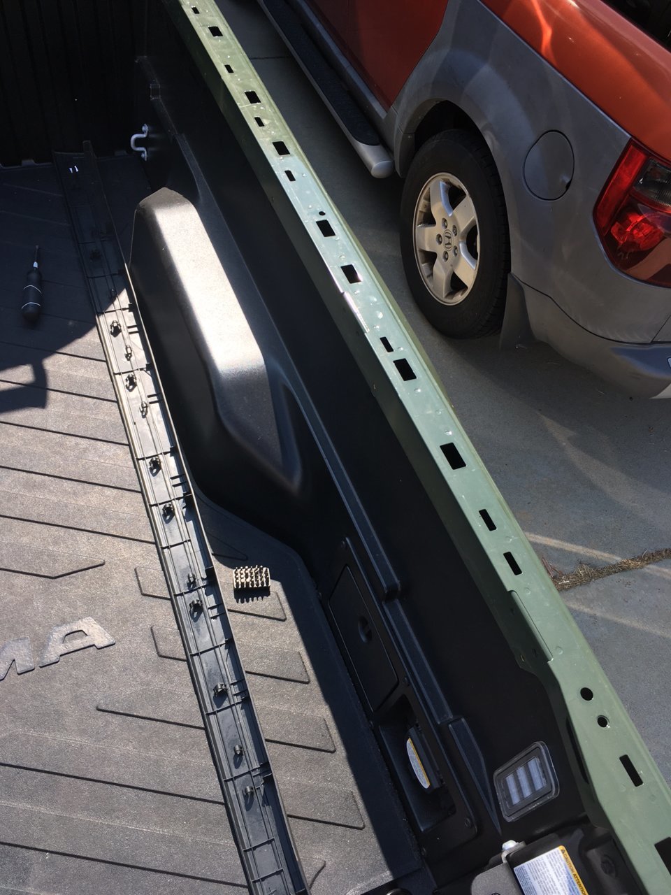

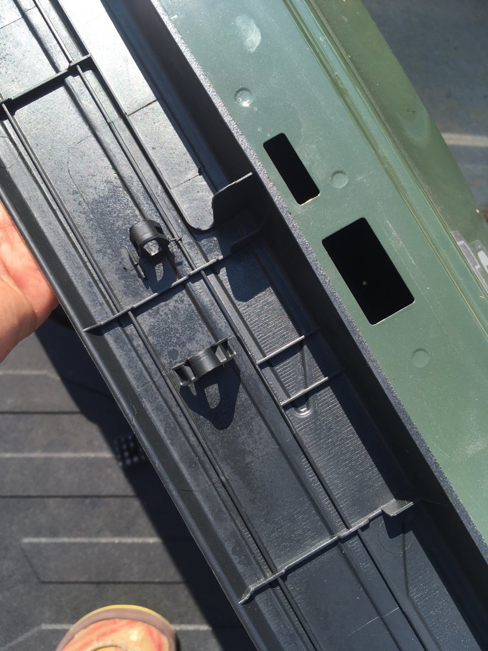

    Bed rails came off easily but be careful as mentioned above by another. Videos online show people just pulling them off from one end like pealing a band-aid off. Go slowly and pull up each section carefully. The tabs can break and or get deformed. The plastic rail may also get a bend in it if you pull all the way up from one end and peel.
    What I was not expecting was that just about every opening along the top has a tab that gets pressed into it. At first I was thinking, great I bought the foil ape for nothing. Well I didn't use any along the top at least.

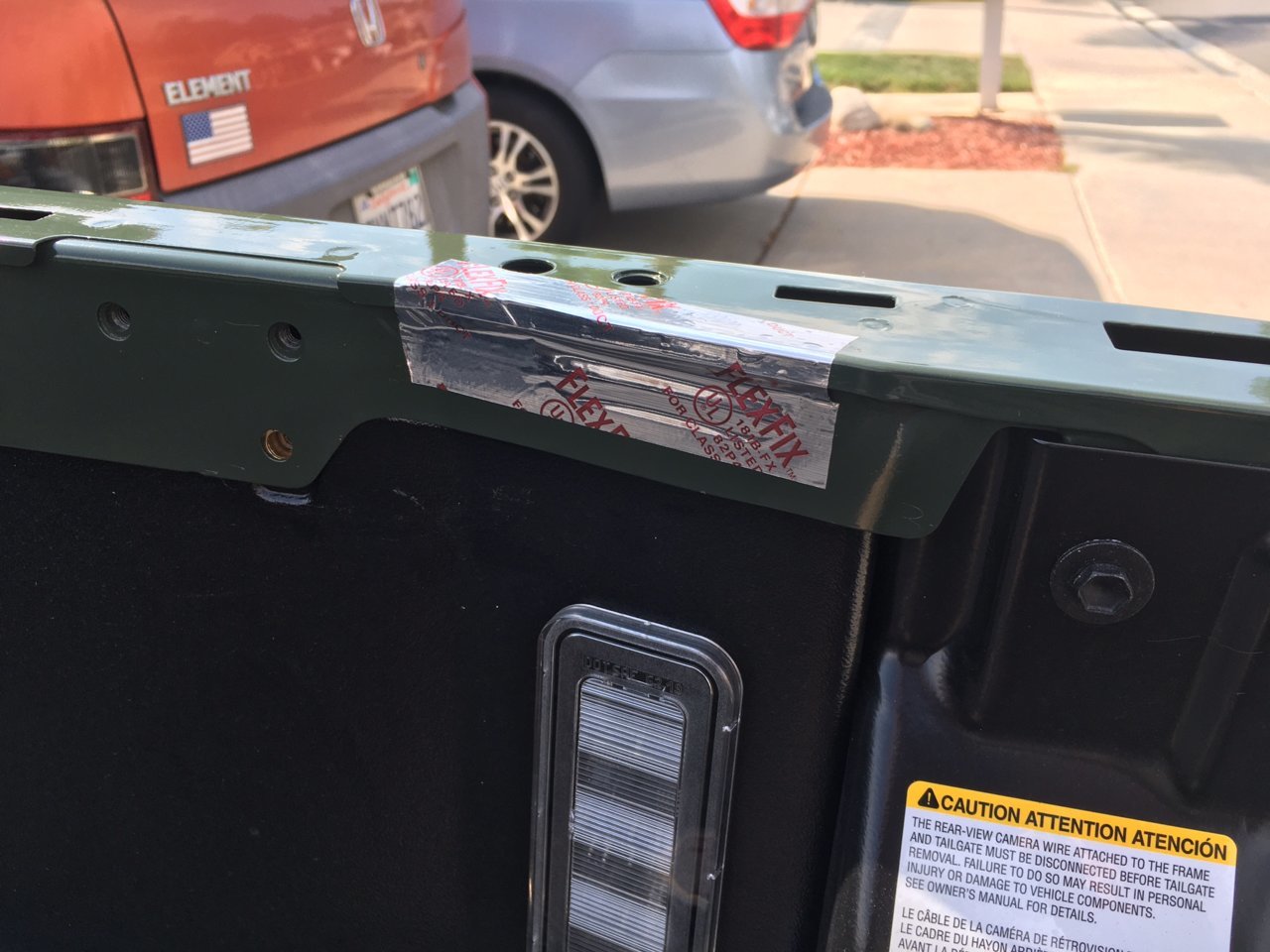

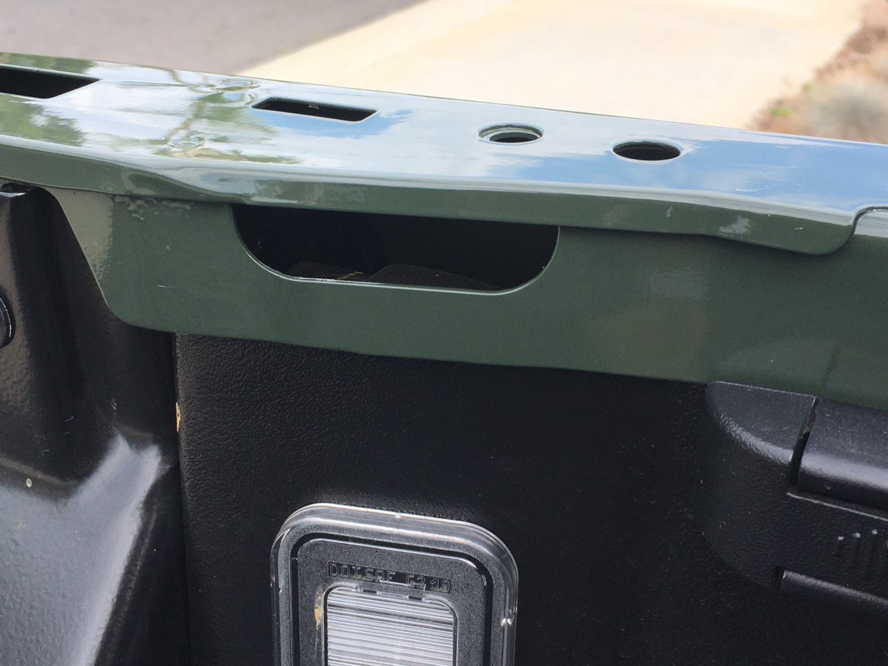

    This opening was a surprise to me and it for sure had a viewpoint indirectly to the wheel well. I did use foil tape over this area.

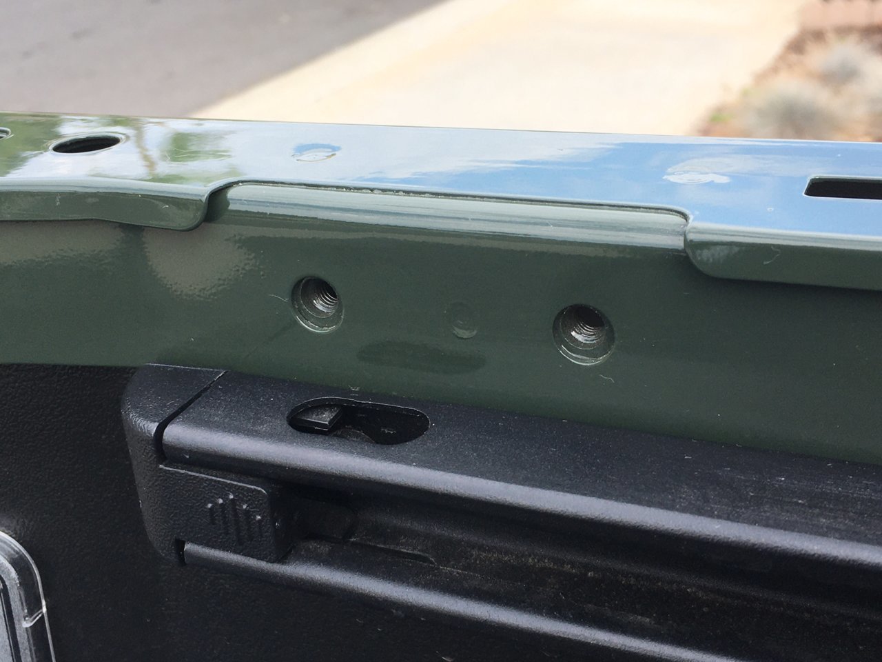

    Also don't know what these mounts are for, but these also could see daylight so I foil taped over them. There area three sets on each side (sorry no pics of tape over them.

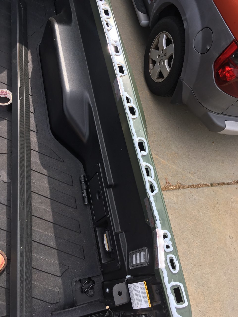

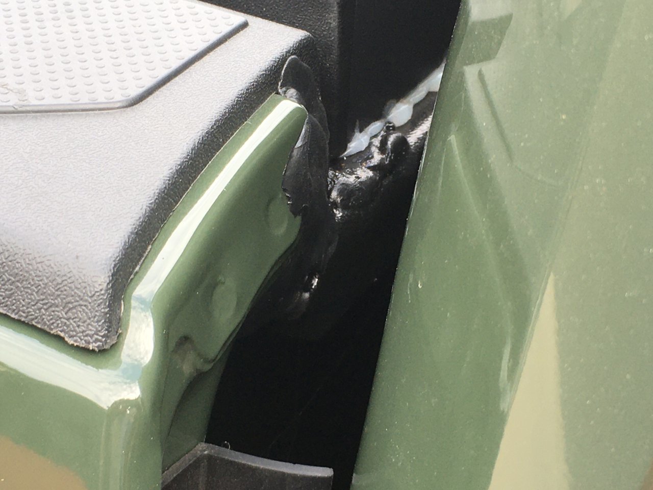

    This is my silicon job. It took more than half the tube for one side, so buy two tubes. I was generous on the bead size based on other threads I read.
    This one one of the back corners. You can see some clear silicone along the front of the rail, this is from when I installed the front rail a few months ago and while I had it off I decided to seal it.
    You can also see my buildup of butyl rubber where I am starting to seal up the corner. Most of the pics you see are just of that "gap" between the front rail and the side rail, but there is a lot of hidden unseen openings for water and dust to get in.
    I've seen sloppy pics of silicone just squirted all over the corners. I decides the butyl would be cleaner and more controllable.
    Not I also took the mounting rails off, rolled short, very thin pieces of butyl rubber, put them on the back of the rails surrounding the bolt mounting holes and remounted them to hopefully eliminate any water from getting in from that area (no pics).
    Like I said, not perfect but better than not trying. I need to tackle the tailgate area and cubby hole area next but those are not critical to get done before the ARE MX shell goes on.
