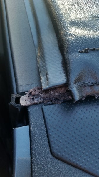

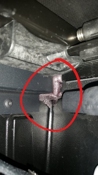

    So I finally got warmer weather to try this in, and I tinkered with a few alternatives before I found one that seems to last. I have the TruXedo Lo-pro tonneau cover and I like how it fits, but as many of you have experienced, I got leaks around corners. I dusted the inside of the truck and drove it in the rain and then through a car wash and found where most of the water is coming in at.
    1st, and probably most, it's coming in through a large gap in the top corners near the cab. Not from the tonneau, but from the bed itself. 2nd, around the tailgate has a significant gap (this was more noticeable after the car wash).
    I tried silicone, gap seal, and flex shot but nothing would stick to the truck well enough. At last I tried Great Stuff (for Ponds) and it sticks in there really well.
    https://www.amazon.com/GREAT-STUFF-Stone-Insulating-Sealant/dp/B001AQ0FVC
    I just sprayed enough in the openings to fill the gap and then let it expand over the next few hours. I trimmed the excess and this is how it turned out:

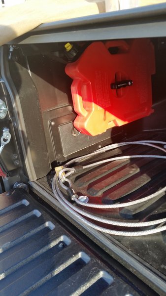

    I will clean it up and paint it late, or plastidip it.

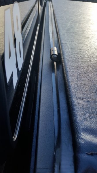

    Next I used gorrilla tape (to go) to tape down the entire length of the rubber flap from the tonneau:
    It holds up in the rain just fine, and if it starts to peal I'll just put more down.

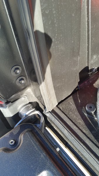

    Next I sealed the tailgate with Tailgate Seal (making sure my corners overlapped somewhat):
    https://www.amazon.com/gp/product/B00IPQWXZQ/ref=oh_aui_detailpage_o00_s00?ie=UTF8&psc=1
    And I dusted it down and tested it again. We didn't have rain, so I had to drive it through the carwash, which is probably a better test anyway. It only had a few drops of water in the bed from the sides and a few drops from the drain holes in the bottom of the bed.
    Overall I consider that a success.

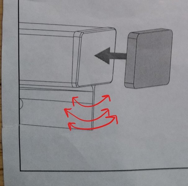

    I know yours is the Lo Pro but the new Truxedo TruXport ships with supplemental instructions and two pieces that fit on either side of the header to water proof it like you did. It wants you to take off the header though so I just shoved them down in there instead.

    I still had the instruction sheet with the part #:
