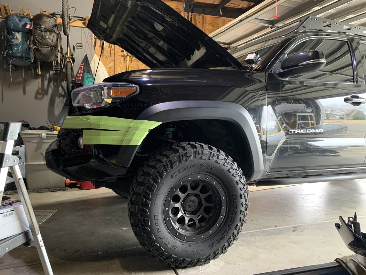

    Looks like I will be eye ballin it then. How long did it take you from start to finish?

    it wasn’t long, once eddy laid the tape and told me to cut straight, lol. Then again we were in a rush, hence why I have no winch mounted still.
    you’re probably gonna cut and hang the bumper a few times to get it to fit right. Make sure you have at least a 1/4” gap, otherwise the plastic will rub off the powder coating like it did on mine, because I am too lazy to finish trimming it properly.

    I have been trying too figure out how to cut a straight line on my bumper for the past hour haha I don't have a laser level and can't tell how to angle it? any ideas?:sawzall:

    Place some tape on the bumper measure and make several marks. Then get some thin line tape and tape above those marks pulling the tape taught in between each mark. Like playing connect the dots

    I have tried using lines on the body but it looks angled to me? lol is it supposed to angle down or up or straight across?

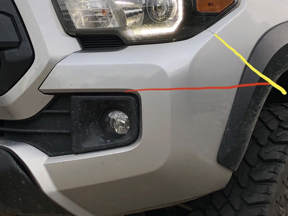

    The line should intersect right where the bumper meets the fender.
    red is the cut line, yellow is the fender/bumper line:

    It's gonna look a little funky around the corner. Bring the line down the bumper some that way you have extra and can sand/trim to where you want it.
