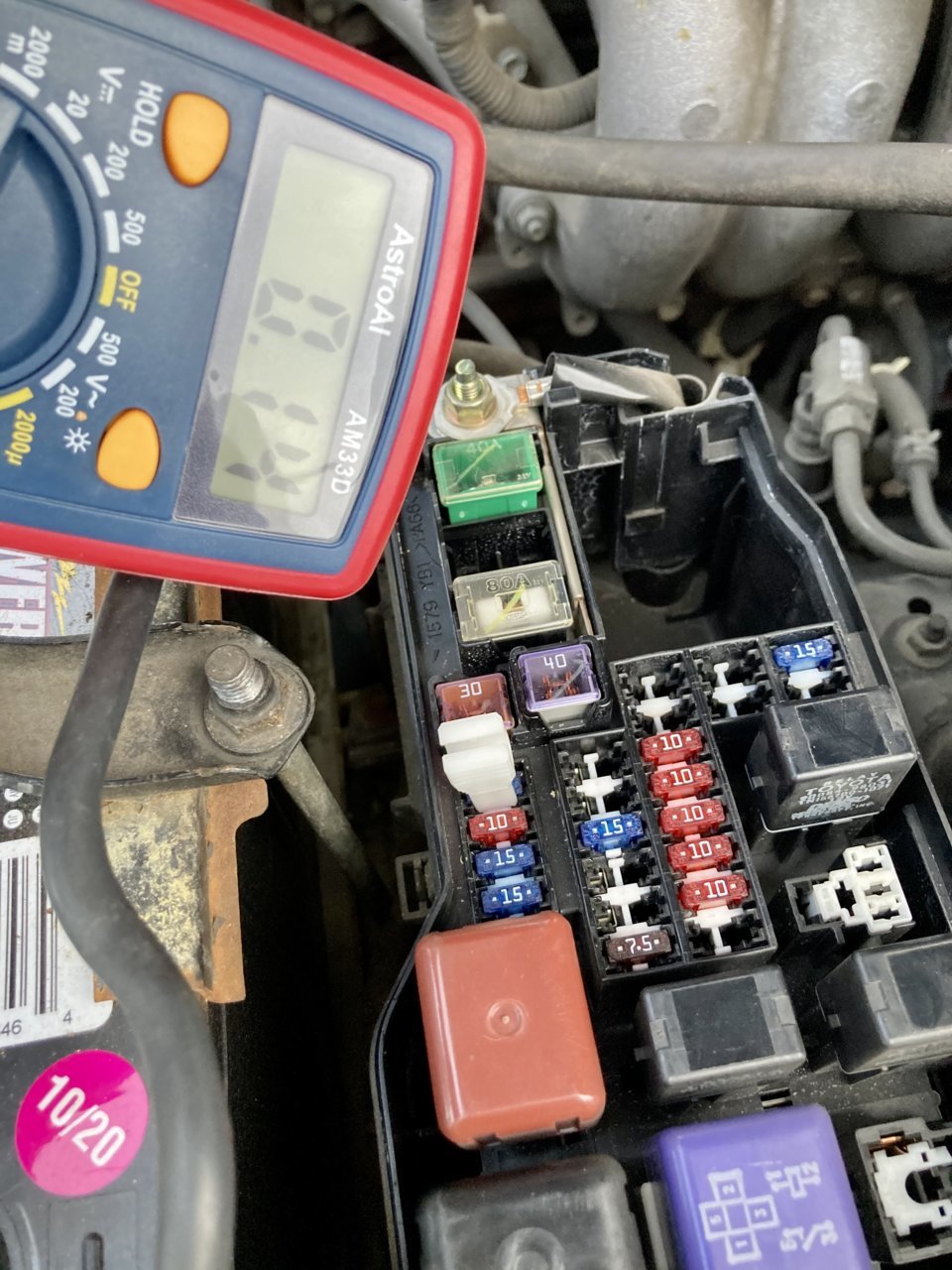

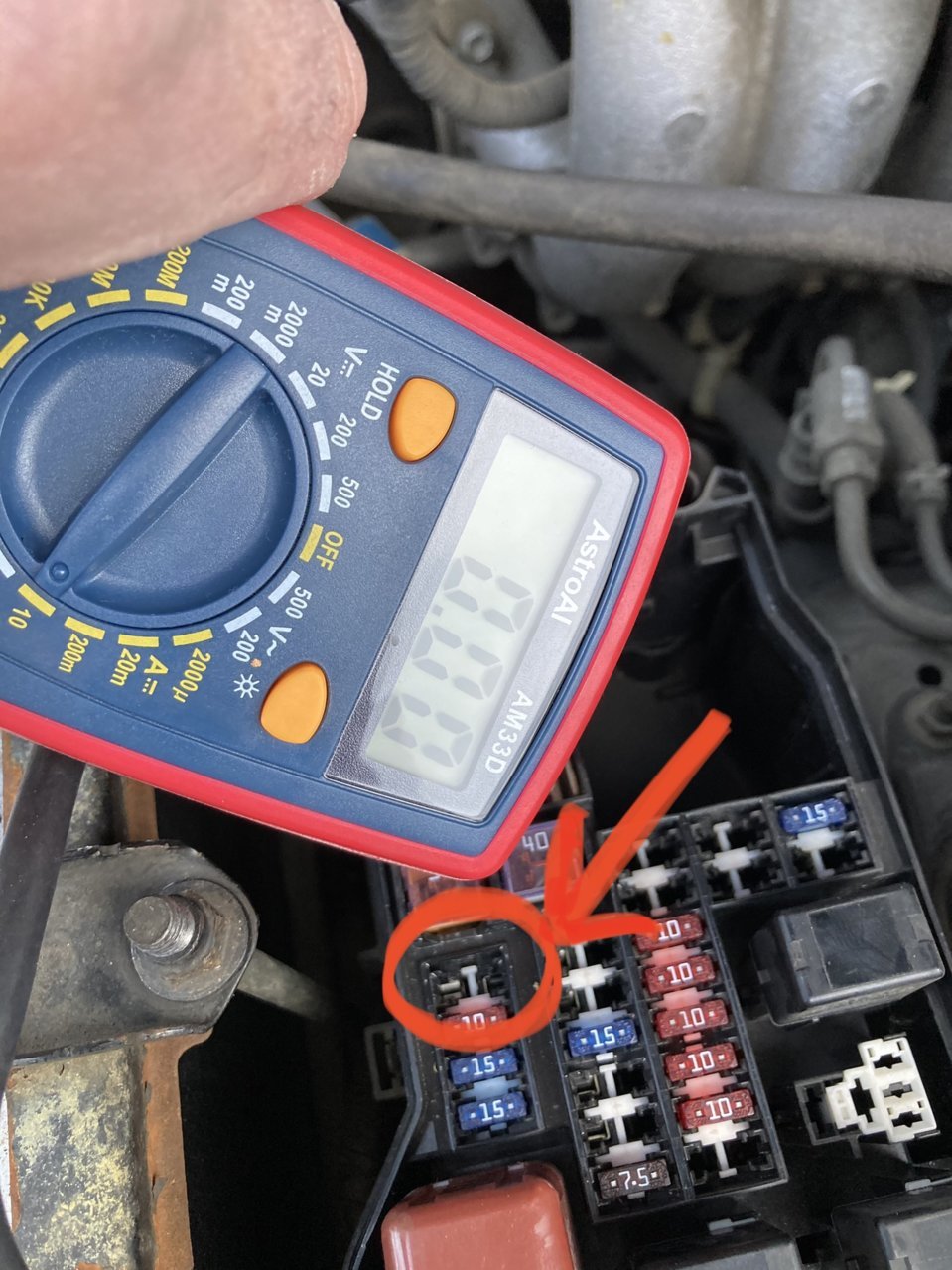

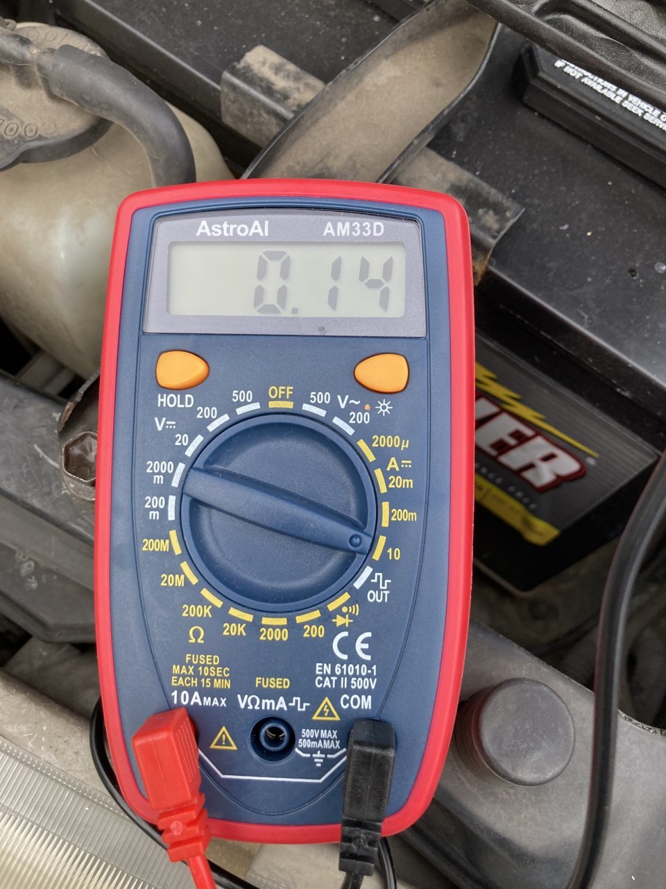

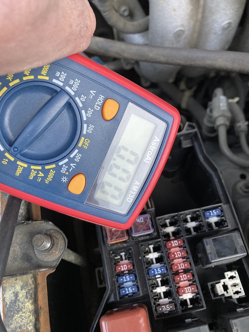

    I watched both videos you guys posted; thank you. I connected my multimeter in-line, on the negative side of the battery, on the 10amp test setting as described in both videos:
    With the ignition switch off, the doors closed and all other switches turned off, there was a steady reading of .14 on the multimeter:

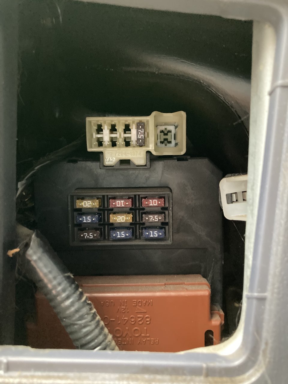

    I then went through the interior fuse box, removing each fuse one at a time and the meter stayed at .14.
    Then I went through the fuse box in the engine compartment removing each fuse one by one. The only fuse that made a difference in the reading was the dome light fuse. When I remove that fuse the draw drops to .00 on the meter. Yes, the dome light was set to OFF and the door was closed. I tried it multiple times and got the same result, so I appear to be making progress:
    Since the sun just set I removed the dome light fuse for now. I need to do a little research into that circuit to figure out how I'll find the short. In the meantime, I'll wait and see if this makes a difference with my slow start problem in the morning. I'll add more to this thread when I make more progress. Thanks again for any and all advice that's been offered! -B

    I did this once and found similar results.. about a 150mA parasitic draw when the truck was off. It's high by modern standards, but a good battery should be able to go a couple weeks and still start your truck.
