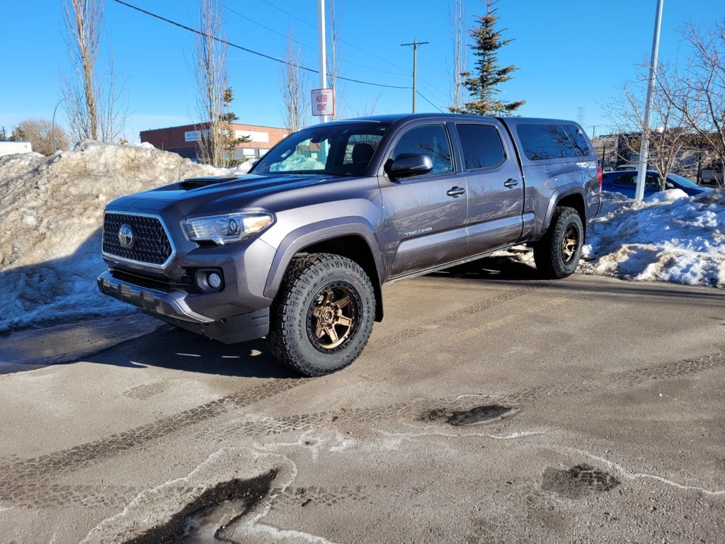

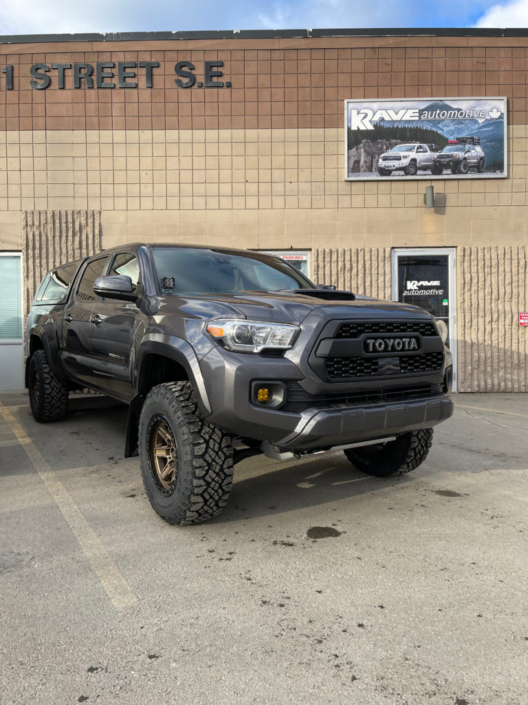

    5100s on middle knotch with 2 inch coils with add a leaf in rear or that Eibach kit with add a leaf. no rear block. These are the 2 options I've been looking at. For past 5 yrs I've been running 2.5 inch spacers up front with 2 inch add a leaf in rear. Have never had a issue, just waiting for a shock to start leaking to upgrade.

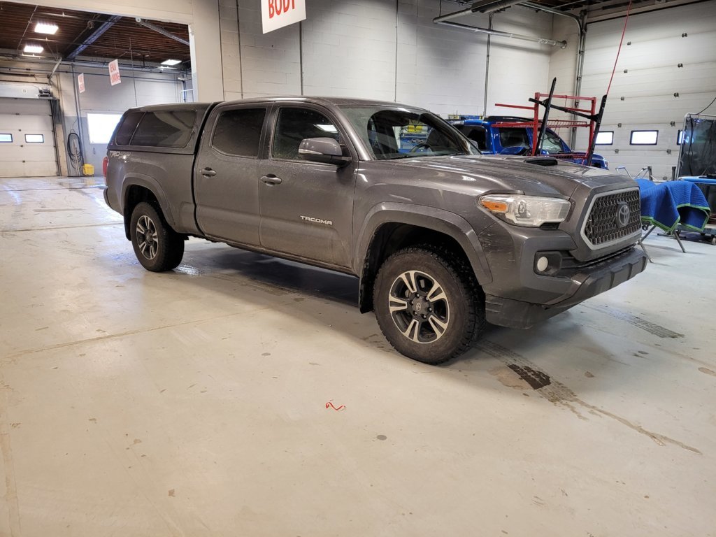

    I would skip the lift start with a wheel/tire combo. Then finish planning for what you want and lift down the road if you still want to. As a 2"+ lift is going to look mighty goofy on stock wheels/tires.
    A 0 offset wheel pair with a 265/70r17 or 255/80r17 will completely change the look of the truck with the fewest drawbacks and the biggest impact.
    Stock
    Wheels and tires
    Lifted on 265's
    Same lift on 285's
    Same front lift more rear lift -38 offset 295's
    I'm on my fourth wheel and tire combo these days it is the best way to personalize the look with the most options.
    If your fully attached to doing a lift now, on road it really doesn't seem to matter which brand you go with. The difference is fairly minimal from any of the reputable brands. Plan for supporting mods such as front clamshell bushing. Carrier bearing drop possibly angled leaf shims. All of this can reduce weird vibrations that can be caused. I also highly recommend for every inch of front lift you also lift the rear an equal amount if you use your truck to tow or haul anything beyond groceries. A level truck will end up front high when loaded and that kills your steering feel.

    Lift doesn't matter for clearance besides ride height. That was running 3/2 in that picture became closer to a 2/1 after spring settle and the bumper was added. The wheel offset and alignment is what made it happen, high castor alignment and that wheels spec was 17x9 +1

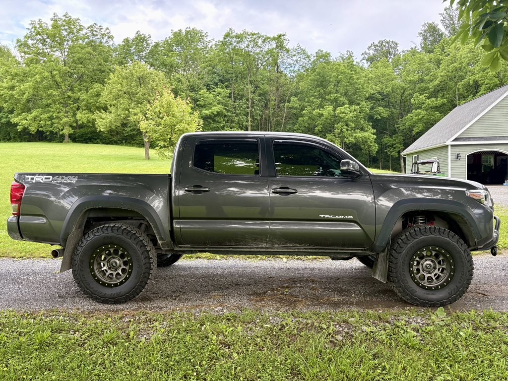

    Eibach Stage 1 and 285’s have been a winning combination for me while running the ridges & mountains of central PA.
