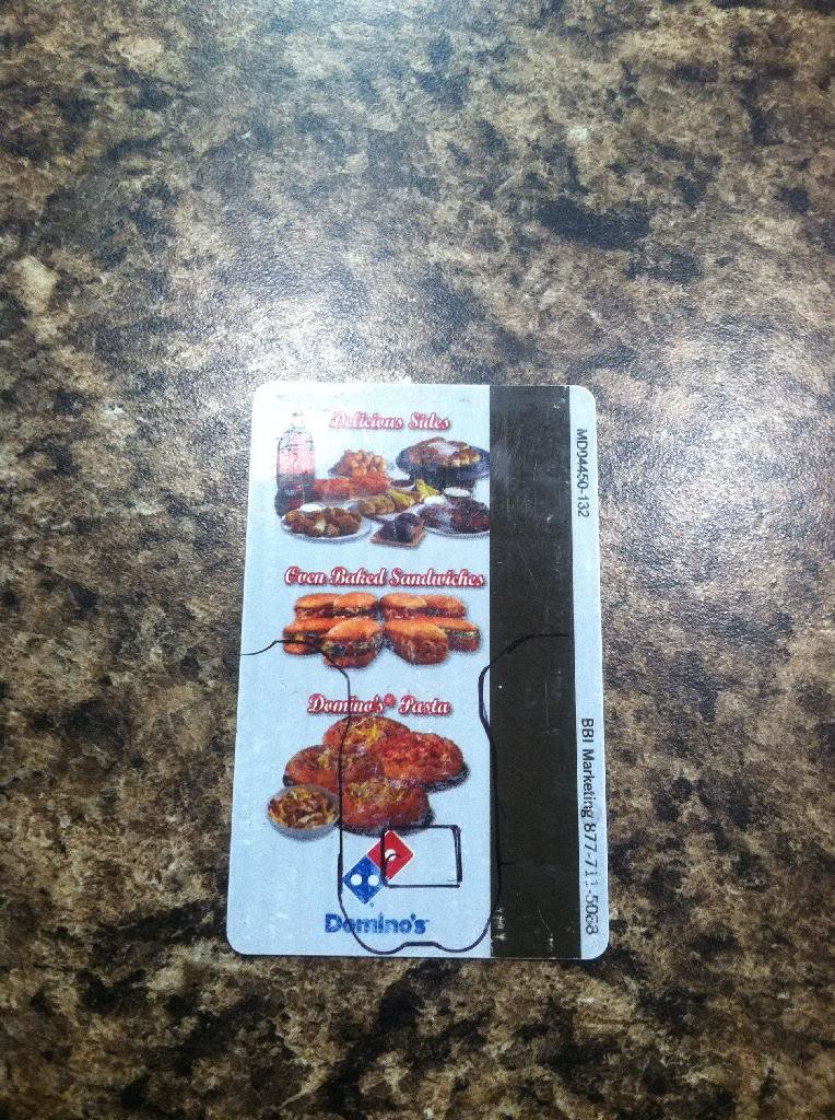

    Step 1
    Trace seatbelt plug onto card w/ sharpie -

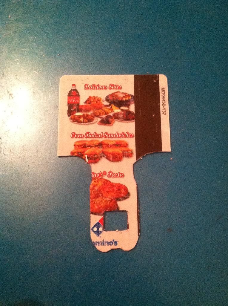

    Step 2

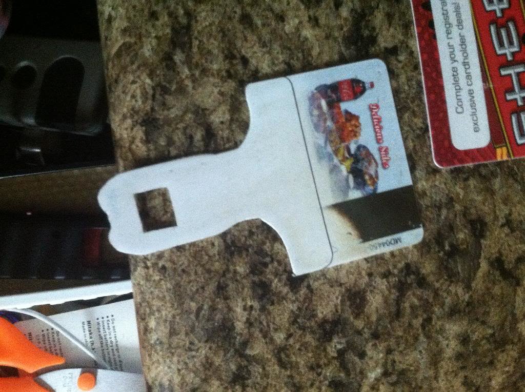

    Cut out seat plug with scissors & Exacto blade -

    Step 3
    Sand it down so paint will stick -
    5AFFD028-8234-4EE0-B72B-DDDCF86A650D_zps_bda80c05b714bd2e01beb14bf0bbfdcec6f57477.jpg
    (I decided it was too long so I trimmed it at the line I drew)

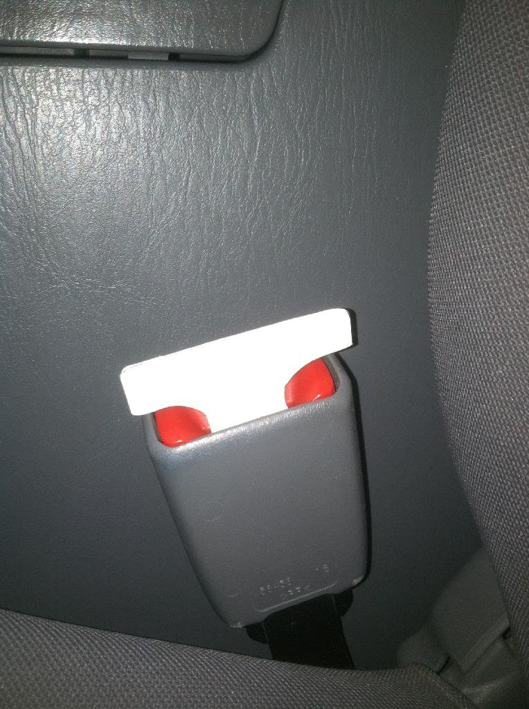

    Step 4
    Test fit -
    1606179F-9432-4C61-A3DA-EC59F2DD2EF8_zps_3927ac8ae6a7cffd1e8188c6ebd875256ed93007.jpg
    It should click in place just like the seatbelt does. When it clicks in, the light should go out. When you hit the button, it should pop out just like the seat belt does and the light should come back on.
    If it doesn't fit, adjust accordingly. I had to sand some edges to smooth everything out.

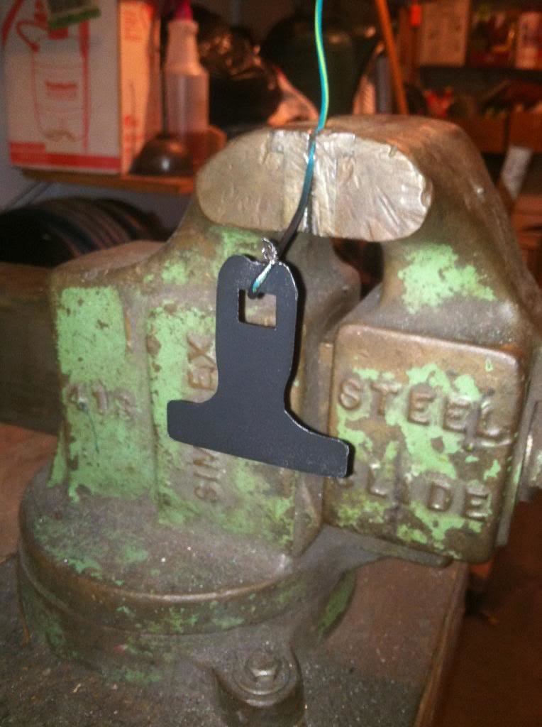

    Step 5
    Paint w/ your choice of color. I used flat black -
    56CEFDE6-FBBF-4016-8864-9EAB387D1BAD_zps_e765c12b785a47133fb4207be54a3b3f2541dd96.jpg
    Its currently hanging in the garage drying. I'll have finished pictures tomorrow after work.
