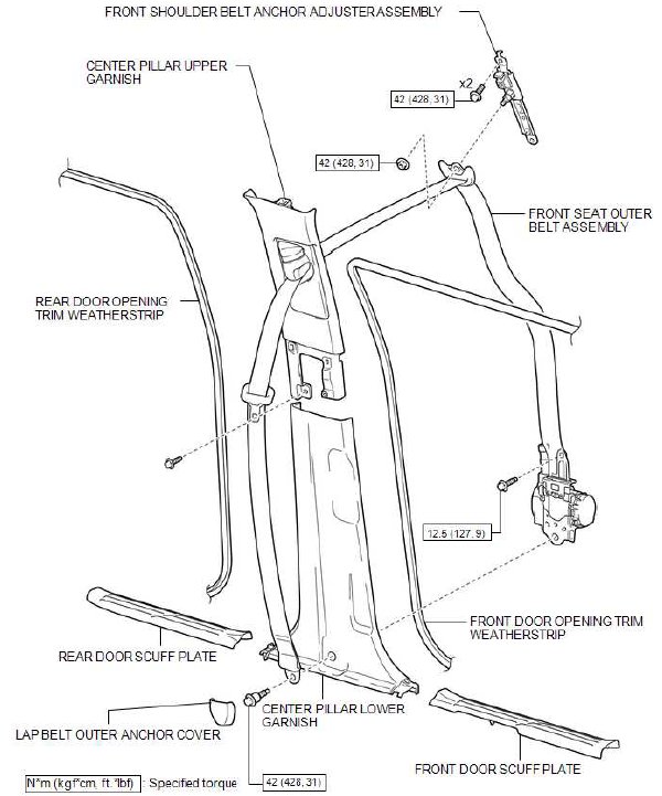

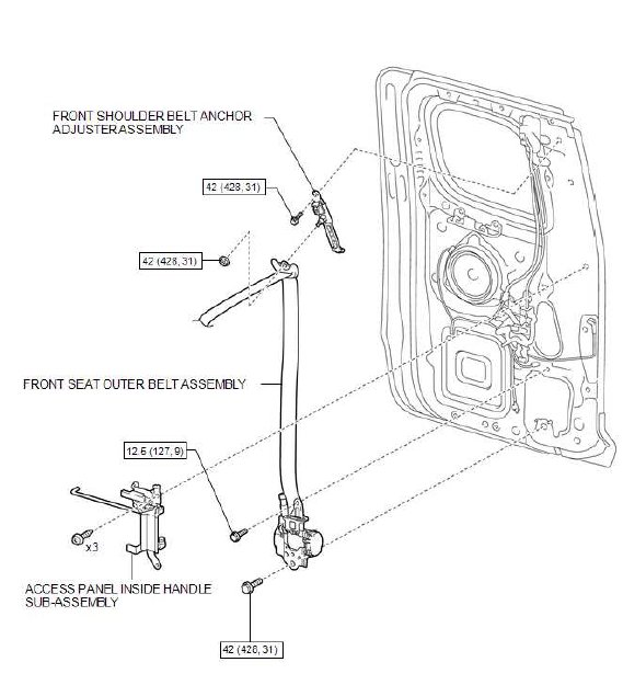

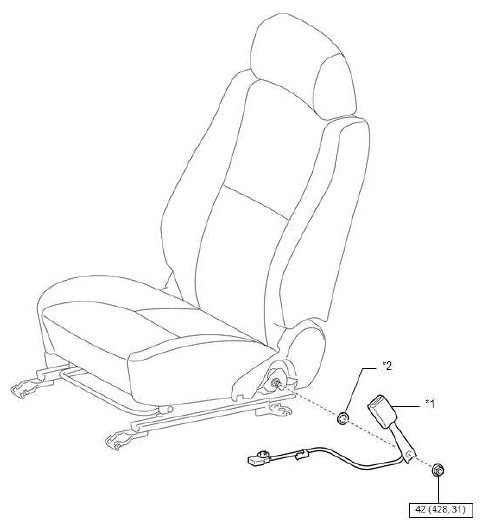

    Good Morning TacoWorld! I'm having some trouble downloading the FSM from the sticky and hoping someone can assist. I am looking for the torque specs on the passenger side bottom seat belt bolt near the floor of the 3rd gen tacoma.

    This one?
  3. Jul 11, 2022 at 7:54 AM
    mattleg
    mattleg Well-Known Member
    Aug 31, 2018
    #264744
    921
    Kansas
    2020 OR DCSB AT 4WD
    Double Cab
  4. Jul 11, 2022 at 7:54 AM
    mattleg
    Aug 31, 2018
    #264744
    921
    Kansas
    2020 OR DCSB AT 4WD
    Access Cab

    See the online SM link in my signature.

    Thank you both! Exactly what I needed. Really appreciate the help from both of you.
