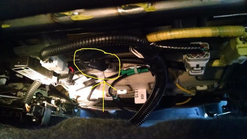

    Not sure about the 15's, but with my 13 I unplugged a wire beneath the seat.
    And get ready for losers to chime in and add " How about you just use the seatbelt" or " I got an idea how about using your seatbelt" etc.

    I have a '13 as well. You recall what wire?

    Thanks! No soap box here. The trip odometer trick doesn't work on mine and I'm not paying the stealer to program it!

    Unplug that pig and enjoy the silence!

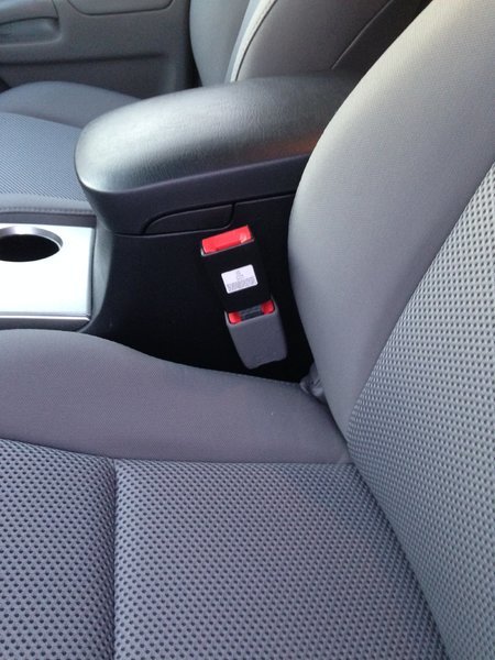

    I use this in my 15. Buckle up on the road. No chime around the farm. image.jpg
