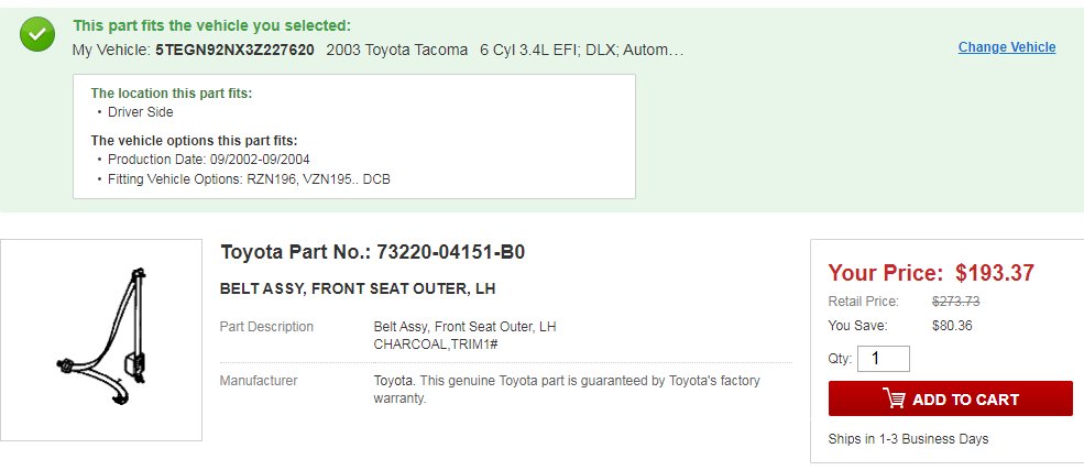

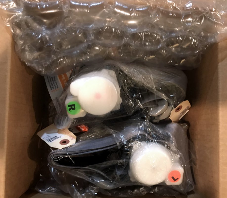

    Update #4..Seat belts were returned to me on Monday, February 10th. So, the turn around was exactly one week.
    Now the bad news. No difference or worse! :mad: That's right....worse than before, and I didn't think that was possible.
    I even had my wife come sit in the truck and she agreed, they are worse.
    There was a plastic "keeper" attached to each seat belt to keep them from retracting so you could re-install. These were removed after bolting them in.
    Let me state, that I marked clearly on the Drivers side seat belt, "Driver" with a blue sharpie (look back at previous pictures). I did this so I would know where to re-install...if that matters.
    I called them yesterday and spoke to the customer service rep and explained my experience. She stated that the first thing the tech will ask, is were the seat belts installed on the correct side. I stated that yes, I had marked "Driver" on the L side, and the L sticker is on that seat belt.
    So, the tech is supposed to call me today.
    I'm not going to bash the company, but needless to say, I'm disappointed. I really don't want to have to remove these again, and ship them off which is probably what they are going to ask.
    So, in conclusion, I would recommend just ordering new.
    In the meantime, I'm going to go to parts.camelbacktoyota.com and order a new drivers side seat belt.
    Can someone please confirm the part # below?? I've seen where members pay in the $160 range, but for my VIN# it's around $190.
    Day they arrived back. Nicely packaged, and identified by L & R stickers.
