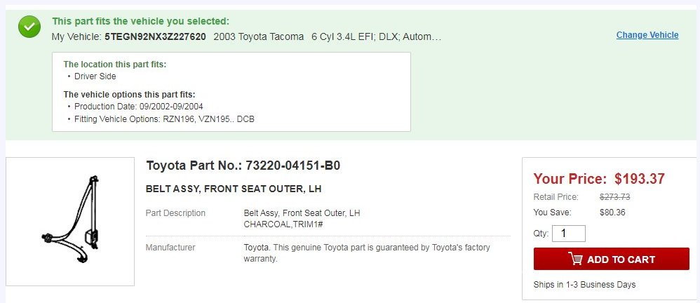

    I called Camelback and spoke to Mike in the parts department. For my Vin#, this is the correct part.
    parts.camelbacktoyota.com
    cruiserguy, GQ7227 and six5crèéd like this.

    you saved $80 :spending: over retail list, i bet my local dealers parts dept would want $400 for a belt if i get it from them and their 'usury' markUp

    Yep, i just ordered it! :spending:
    It's just money...........they make it everyday!

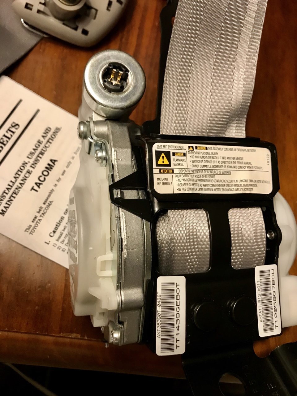

    Before I installed my brand new seat belts I compared them to the old one taken from the truck. The old ones were not bad - no tears, not dirty, they were going back on its own if not restricted (like by twist). But when I put them side by side with the new one I noticed three major differences.
    1. Spring in old one was much weaker than new. I guess over years the spring got "tired". I mean to pull the belt out of the mechanizm I needed less force than on the new one.
    2. The old belt is swollen comparing to the new one. It is like comparing a paper towel to computer paper. Not dirty, not frayed just swollen.
    3. Guides inside the mechanizm have signs of being shaved by the belt. Surfaces of these guides were not smooth and shiny like in the new one. These guides created some of the resistance.
    That convinced me that there is no way "refurbish" or cleaning old seat belts will make them work like a new one, unless belts, spring and all guides are replaced - which basically is the whole seat belt.

    New seat belt from CamelBack Toyota arrived this afternoon.
    Once I get it installed I’ll update.
