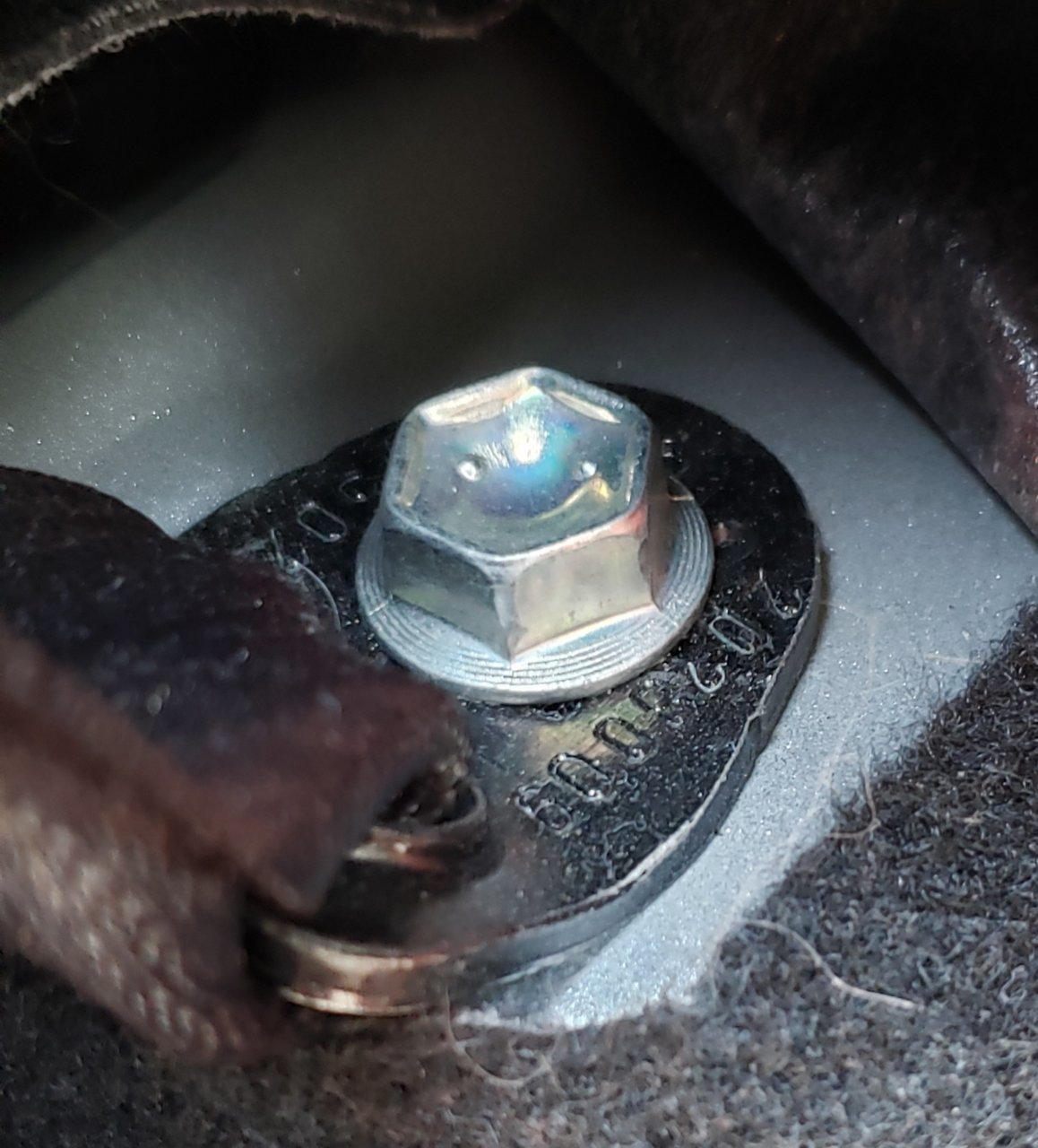

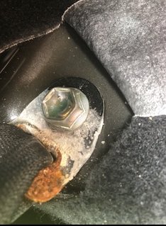

    White stuff on the bolt. White stuff on the belt right at the threads. Damaged threads.
    For sure I’d say you had something corrosive cause that damage.

    For Pete's sake. No it is not "rust" as in iron oxide. "White Rust" is a term in general use to describe the material resulting from the oxidization of the zinc coating on galvanized metal. While the word police may be correct, if you use the term in the presence of those who deal with this problem everyone (well except the extreme newbies) will understand what you are talking about.
    Think of it like Kleenex. Not all tissues are Kleenex. But if you ask just about anyone in the US to hand you a Kleenex they know what you are asking for.

    My bracket has similar rust on the passenger side which seems odd considering the location. Agree with Jeep. That is the sacrificial zinc. Once it is gone you will see iron oxide rust. The driver side has no issue.

    Looks like a lot of abrasion. Odd there doesnt seem to be any damage to the belt itself though

    There's nothing galvanized there though.
    My truck is 3 years old, lots of wet dogs, and general crap carried back there. No "white rust".

    This is mine. I have no idea why the passenger side is rusting, but as you can see, looks pretty much like the OPs. You can see where the zinc is losing the battle and rust is taking over.

    Doesn't really matter what it is. The dealer should fix it without question. No way does Toyota want that liability nightmare.

    Galvanized metal sounds good in theory. But in practice if you get even the smallest break in the surface you loose protection. Then the moisture migrates in and under coating corrosion begins. The problem is you can’t see it until it’s somewhat advanced.
    If you want to avoid corrosion you should use an appropriate grade of stainless steel. Exposed to the wrong stuff it will oxidize nut not near as fast.
