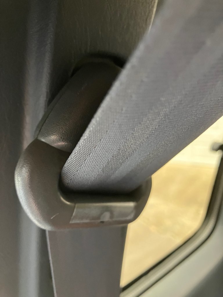

    1996 Tacoma 4wd 2.7 + 2023 TRD Sport
    I fixed mine by putting a strip of UHMW polyethylene tape on the metal pillar loop. The anti-friction tape works wonders at this point of max friction where the belt takes a sharp 180 deg. turn. PTFE tape may work better.
    I don't consider this a permanent solution but it's been 5-6 years and the belts are still retracting nicely.

    Where u place the UHMW….
    The place is hidden? Like by the spring mechanism (non appearance)
    Or can u post pix easily?
    Thanks man

    Here's a picture of how I applied the low friction tape. I'm holding the belt up for visibility.
