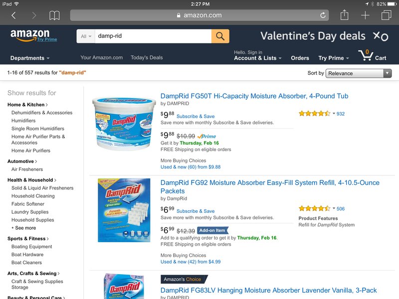

  3. Feb 14, 2017 at 2:30 PM
    George1441
    George1441 Much happier
    Apr 10, 2016
    #183876
    1,344
    George
    2016 Chevrolet Colorado Diesel
