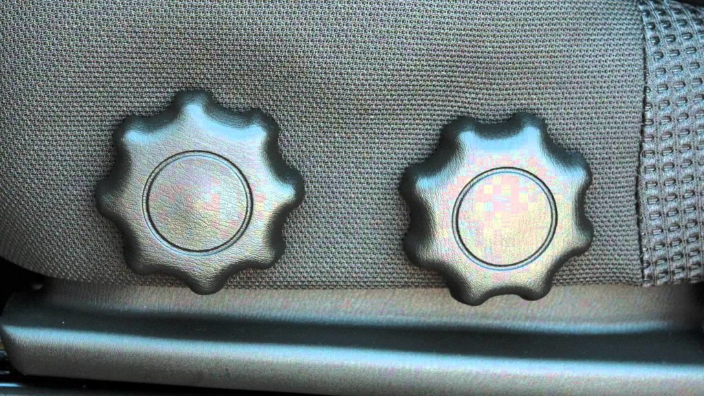

    Manual raises up/down equally front to back, power seat can tilt, well with other brands anyway.
    88 Camry and 12 Xterra had 2 knobs on the side, could raise/lower the front and back independently, that was nice.

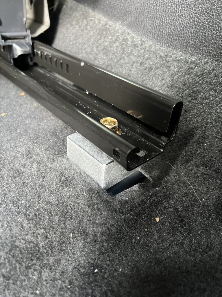

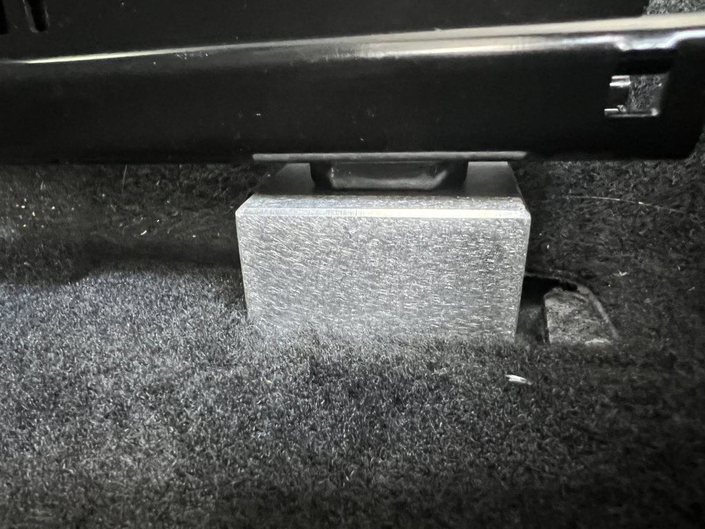

    Just an update: 2 sales of new style rear spacers, both happy with comfort, pocket faces down onto mounting hump in floor, flat side up. Not as I intended however they are stable. Mounting floor humps under bracket would not work with flat washer style spacers sold elsewhere. 1 customer now wants 2nd set for passenger seat. 1 customer still on the fence. Neither has returned them for a refund.

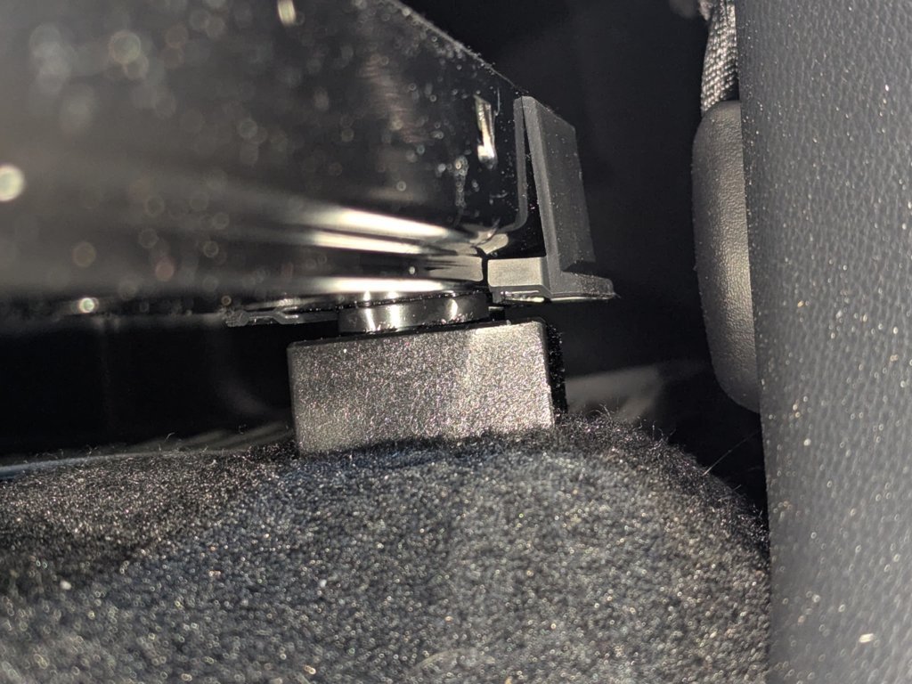

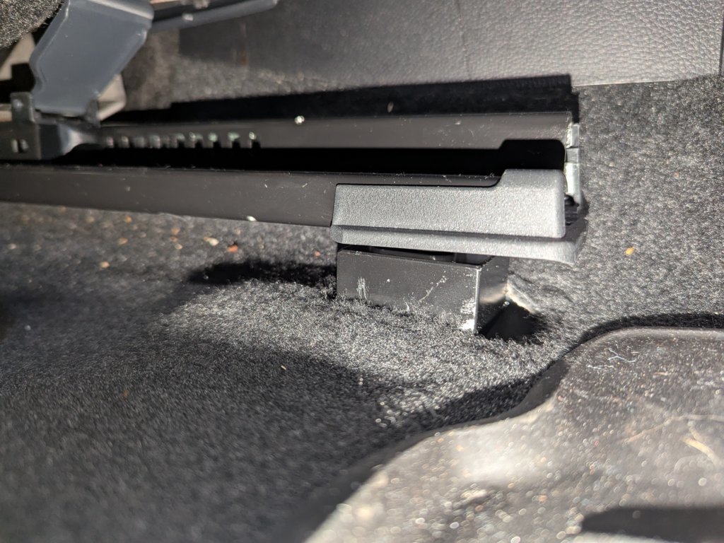

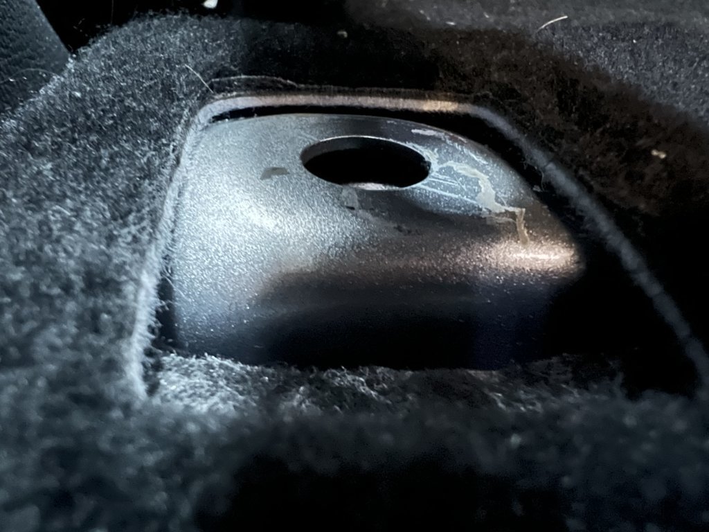

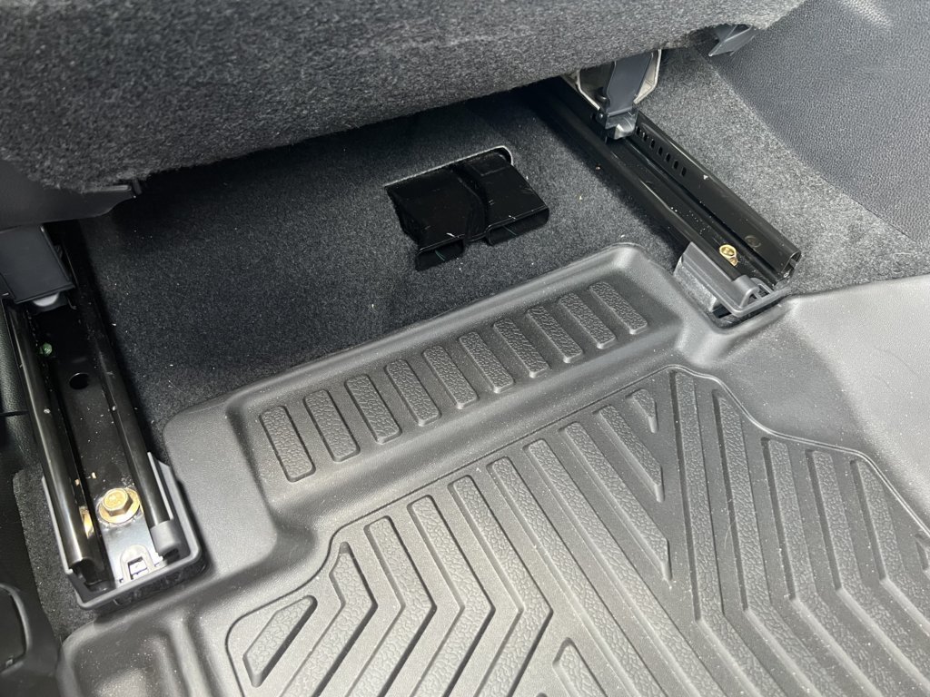

    Seat spacer pictures installed. Unpainted mounted with pocket facing down over the mounting hump. Painted (by customer) mounted with pocket facing up as planned.
    Mounting floor hump:
    Mounted with pocket facing down:
    Mounted with pocket facing up:PXL_20250302_163444926.jpg PXL_20250302_163313817.jpg

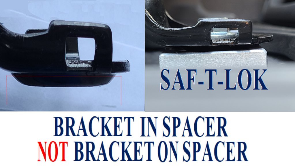

    NOTE THAT THESE ARE ONLY FOR THE REAR BRACKETS. NOT FOR THE FRONT.

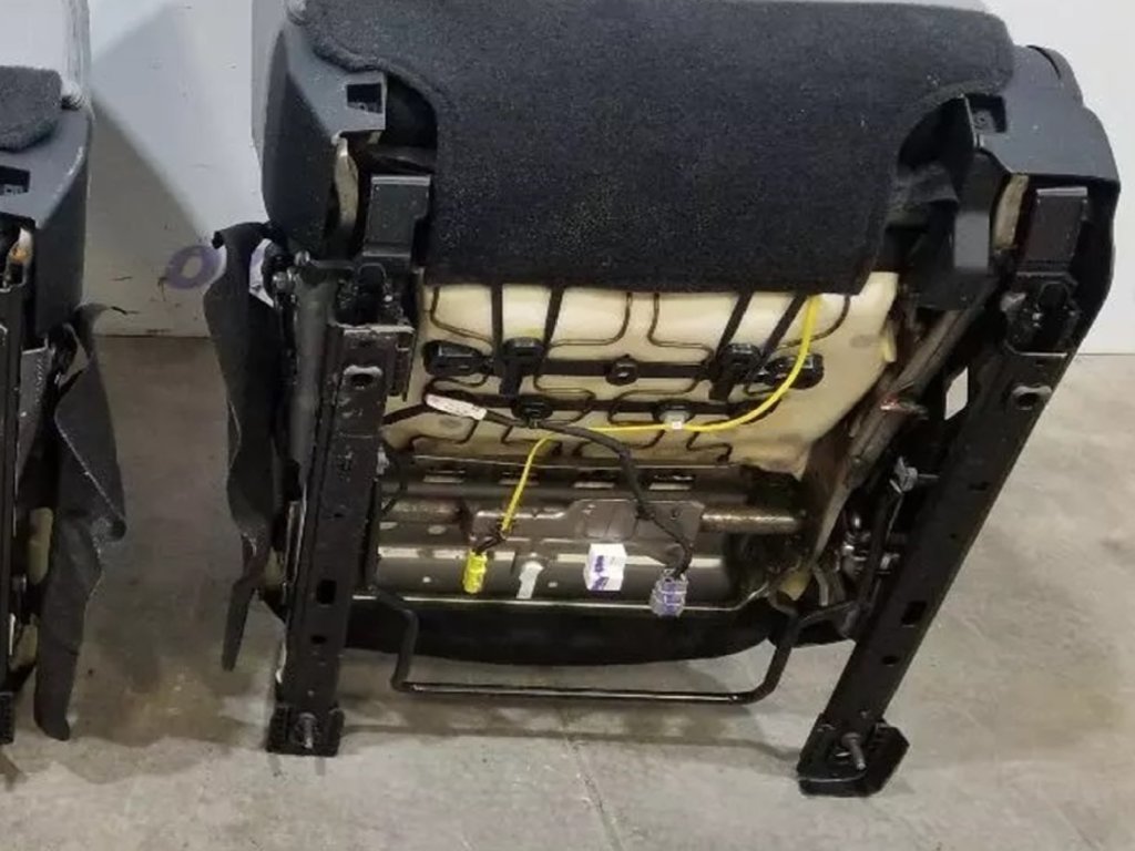

    POCKET: The pocket was initially designed for 2005-2023 Toyota and other brand vehicles. Under every vehicles rear bracket there is a boss on the bracket, and sometimes formed into the bottom of seat rails, that fits within the top pocket of the spacer. Some bosses are round, some square and some rectangular. This is a preventative safety measure and I am the only one that makes this design. If you place body weight in a seat with my spacers, without installing the bolts, you cannot knock the spacer out with a 2 pound hammer. Flat top style spacers could never pass that test. I call this my SAF-T-LOK™ spacer. Picture a solid ball, like a bowling ball, and place the ball on a flat floor. It rolls at the touch of a finger. Place that ball on a solid block, with the top having a shallow radius pocket, and the block would require much more force to knock the ball free. Putting a grade 10.9 bolt through the ball, spacer and floor would make it very difficult to move.
    4TH GEN FITMENT: I sent out 2 initial pairs. These were blind tests based on images of actual 2024 seat frames (did not have floor images). The 1st big surprise was the rear floor change. All previous Toyota vehicles had a flat floor mounting position (some pre-2005 were vertical). The new ones have a "hump" that was not planned for. The pocket is designed to be on top. Tester 1 tried both pocket up and pocket down. He was happier with the feel of pocket down. Tester 2 mounted his pocket up. He was happy and confident enough to order a 2nd set for his passenger seat. I would like to have more feedback however I only have the 2 from testing. Neither one requested to return them. It appears that there is not much contact between the actual seat and the bracket from the factory. As the "hump" was not planned for I have not made any changes. I sell this same spacer in a full front/rear kit for another vehicle brand. I will not make them to exactly fit the "hump". I had a similar experience with an SUV, with a multi-angled nightmare floor design, that I could not reproduce perfectly. I already take a beating on labor and try to keep prices reasonable. Time will tell if these are marketed to the 4th gen. Doesn't appear to be any options right now. I sell my quota every month so if they don't sell here they will sell somewhere else. Thanks for inquiring.
    2024/2025 SEAT: As I don't have any 2025 images perhaps you can compare the following 2024 picture to your 2025.2024 taco seat blownup.jpg
