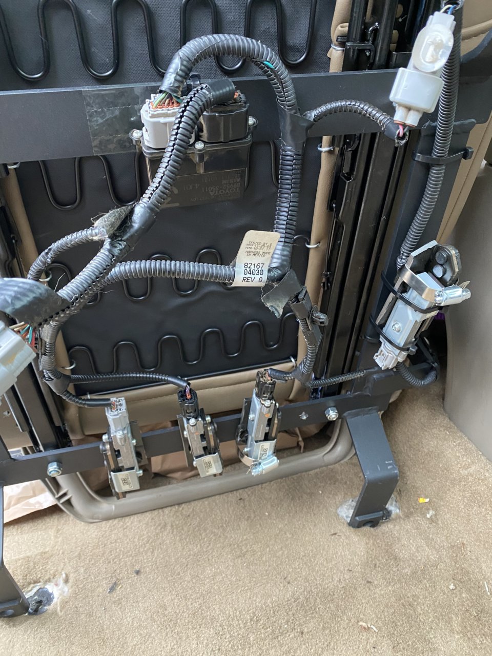

    I figured these were some sort of load transducers which turned out to be correct. First make sure and label the sensors and the wire so you put them back in the same place. I cut most of the bracket away on all four of them. This is not necessary but I wanted to make them as compact a possible so I could mount them underneath the seat. Then I took hose clamp and tightened one around each load sensors. This put enough pressure on the sensors to simulate the weight of a person thus allowing the airbag to be on. After that I drilled a hole in each sensor and mounted them underneath the seat.

    I thought I’d add my pics and thoughts now that I’ve done it. I only needed a hose clamp on two sensors to trigger the airbag to be on. I attempted to mount them all to my seat bracket using the existing threaded hole/screw on the sensors. For whatever reason, this was causing inconsistent results with the airbag being on or off. As soon as I would unscrew one of the sensors with the hose clamp, the airbags would come back on. My theory is something to do with it grounding out.
    anyways, I moved one sensor off the the side and zip tied it out of the way and for whatever reason, and now the airbag is consistently on. No complaints from me.

    The sensors are in the passenger seat. It’s what holds the seat itself to the lower bracket to sense weight. I believe the bladder is only on bench seats.

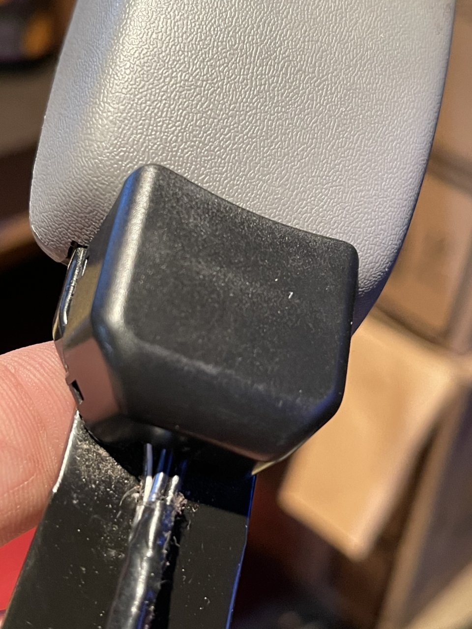

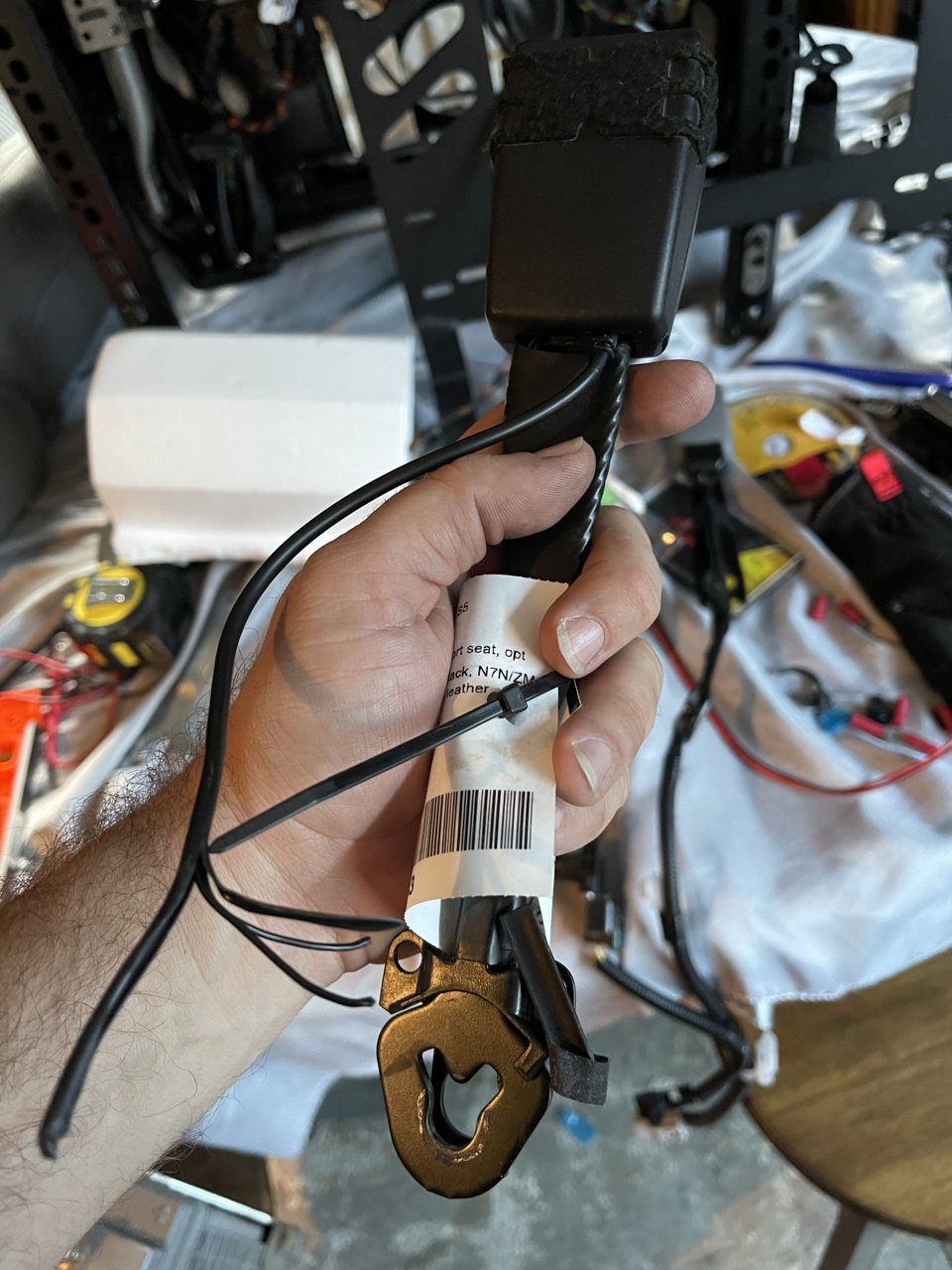

    Anyone have any idea what the black box or extra 2 wires go to on the seat belt buckle? Others only have 2 wires. I’m guessing maybe it’s the sensor for something curious what it’s for and if that could be moved to a new buckle.
    Tacoma has 4 and behind that black cover is a small board.
    another I was hoping to use only has 2.

    Interesting. Is that on both sides or just one?

    Top one is from the drivers side. The bottom one is an Audi buckle. I’ll have to check the passenger. I was expecting something funky on the passenger not the driver. I need a longer one and the Audi one clips in with the Tacoma belt bit sure the 2 extra wires and what’s in the extra part.
