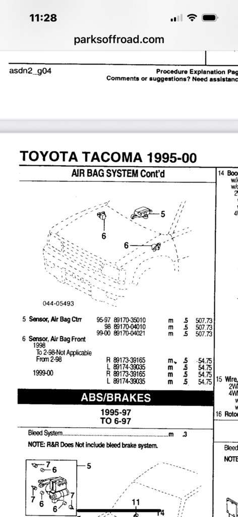

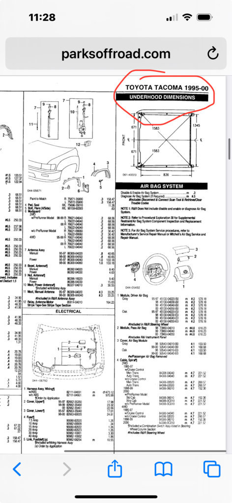

  8. Jun 13, 2025 at 9:30 PM
    ControlCar
    ControlCar My Moto: Help & Learn…period.
    Jul 22, 2023
    #429578
    3,284
    Steven
    Sugar Land TX
    1996 Taco 2.4L 2wd Automatic
    Clock Volt meter/LSPV Delete/Hyundai 16’s/FP gauge/after 9months of wrenching ZERO oil leaks
    IMG_6816.png Yeah this shows 95-00
    Very basic AB system

    On my 96
    My AB lite sometimes is normal/shines brightly/fades in and out/goes off after 15 min drive
    AB computer/PCM is failing
    Located on tunnel under ashtray
    Can source a used PCM or send off to an electronics rebuilder
    Or take out bulb (like I did) when I installed new cluster
    LarryJ1959[OP] likes this.

    Per that microfiche…..nope
    Relatively same ab system 95-00
    not even a buckle pretensioner
    That came out b4 seat occupancy sensors/side AB’s
