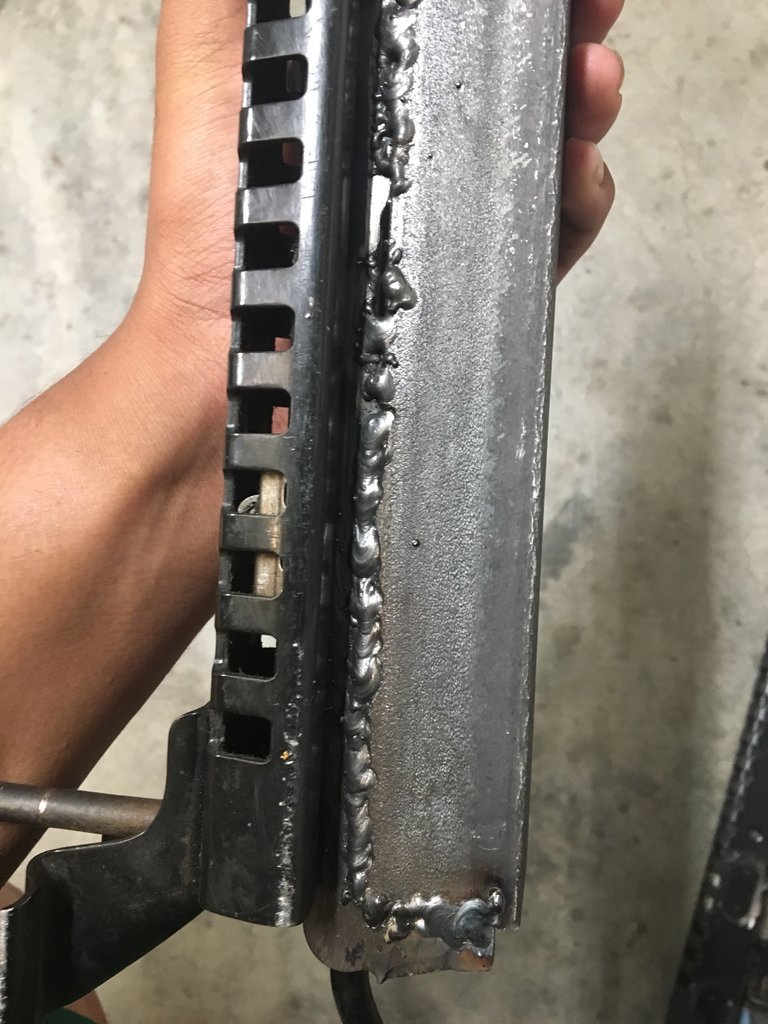

    Doing the same thing with Lexus power seats. I actually preferred to use BMW seats, but after searching 50 different BMW's I found their seats to be way too stiff. The Lexus ES300 seats I'm using are actually memory foam I think.
    Welding is a real PITA... I'm trying to keep the sliding mechanisms intact for my extra cab and its taken me a lot of welding and grinding to get them almost perfect.

    I grinded down the existing seat ratcheting mechanism and welded on angle iron. From there I'll weld the Lexus seats to the angle iron.
