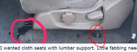

    I did think about it. I also contacted the tacomaworld hookup at AutoAnything and he told me he could get me some caltrend or coverking seat covers for a good price as well. I've also thought about just saying 'screw it' and getting some corbeau A4's. Still undecided.
    Do yours seem to sit just a bit unlevel? Also, what did you do about the back leg? Mine was off by about an inch and I just bent it over so as not to have to drill a new hole.

    My back leg was off only 1/4 of an inch at most. I didn't have to bend it. I secured the other two legs first, then put my weight on the chair and got it over the hole, dropped the screw in and tightened it down.

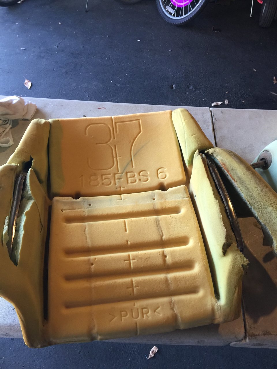

    I took my seat apart and found this . Looks like the glue gave out them the foam got cut by the metal . Going to try to reglue hopping it helps . Anyone know how to do it a diffent way for cheap F2B8BD91-AAC7-40C7-ABE4-D0EB4D55FEDF.jpg

    Haven't read through all of the exchange here so maybe this has been covered. You can buy complete OEM replacement foam for just under $200 a seat that includes Top & Bottom. Check out Leatherseats.com or Katzskin.com as well. You will end up with from $800 to 1K when finished but they will be far superior to used salvage offerings. Also, a good time to add a good quality heated seat kit for your ride.
