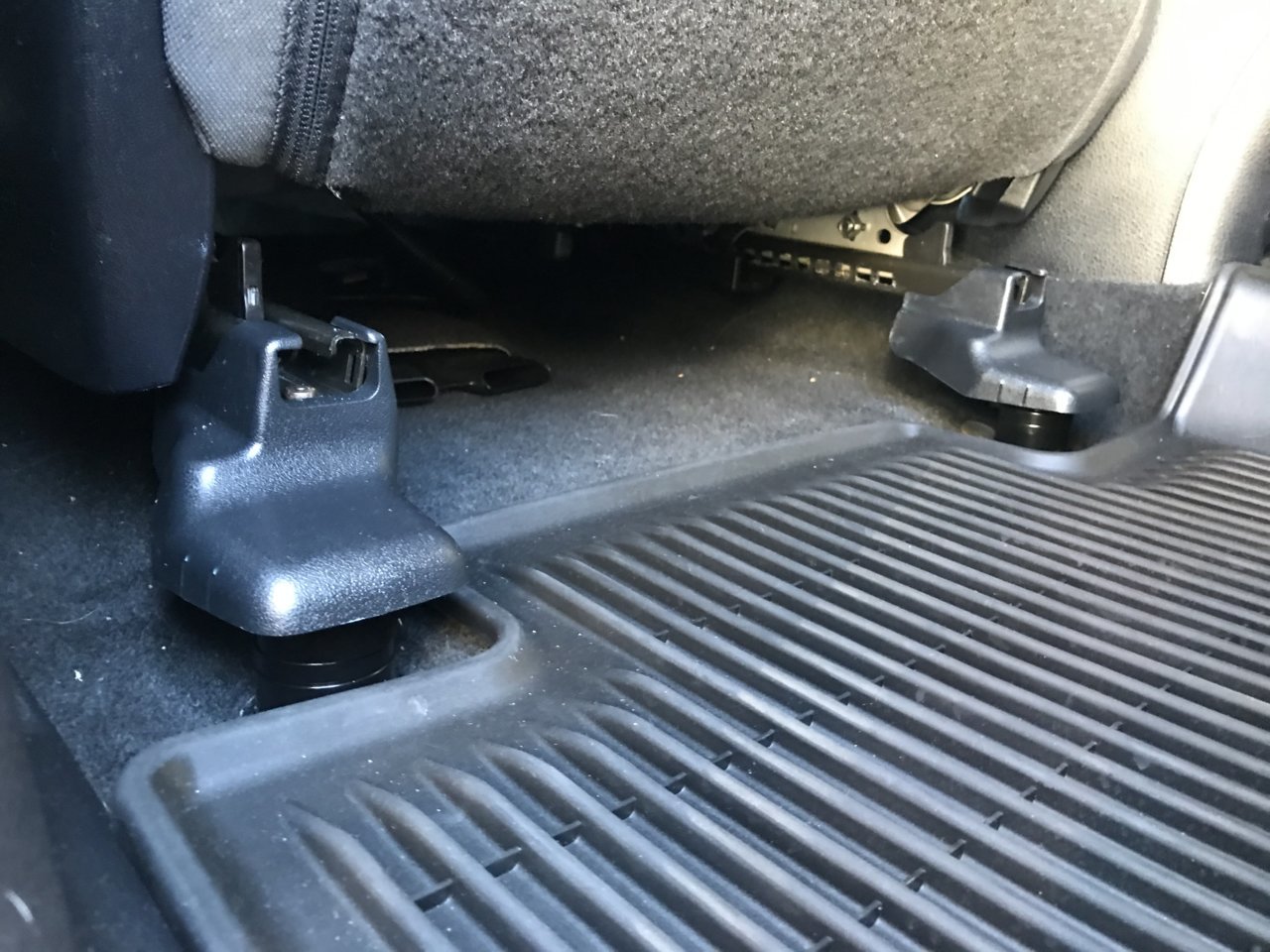

    Thank you for the pics. That doesn't look bad at all. Looks like it came that way. Do your knees hit the steering wheel now? It looks close on the bottom. In your opinion does it make a big difference as far as how you look over the hood?

    @shelbell1086, my knees don’t touch the steering wheel. It doesn’t feel like I’m sitting in a hole anymore. And it does help me to see over the hood better. So far I like it and I’ve just ordered a set for the passenger seat as well.
