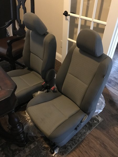

    Stumped with a seat swap I'm doing in my 2013 Tacoma regular cab. Swapped the bench out for two 2013 bucket seats. The driver side went in perfect and the airbag and seat sensors all plugged back in one for one. He passenger side...not so much. There are two connectors that come from the wiring harness to the seat. The yellow connect plugged right into the yellow airbag connection on the bucket seat. The problem I now have is a black connection from the wiring harness and a gray connector on the seat. Obviously they don't match. This is causing the pannseger seat warnkng light to be active. Is there and adapter I need? What am I missing? Any help is appreciated. I am converting the truck for a theme build and need the buckets versus the bench. Thanks. I can include pictures of the connectors tomorrow.

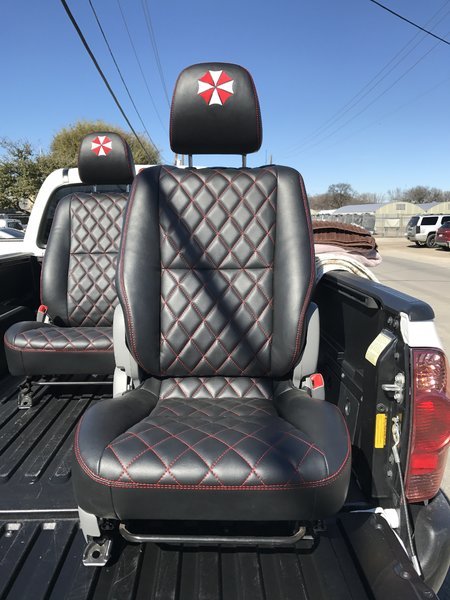

    Is this a cover? If so, where did you get it from?
  9. Feb 16, 2017 at 11:02 PM
    Ronin1971
    Ronin1971 [OP] Member
    Feb 16, 2017
    #210782
    21
    Skip
    2013 Tacoma 4x4
    Theme build.
    No. I had Sue (from Fast and Loud) do them for me. She has done a ton of work for me in the past.

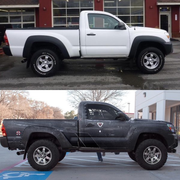

    The white is the current look of the truck. The render beneath it is the digital wrap we will do next week. You can see the seats are part of the same theme.
